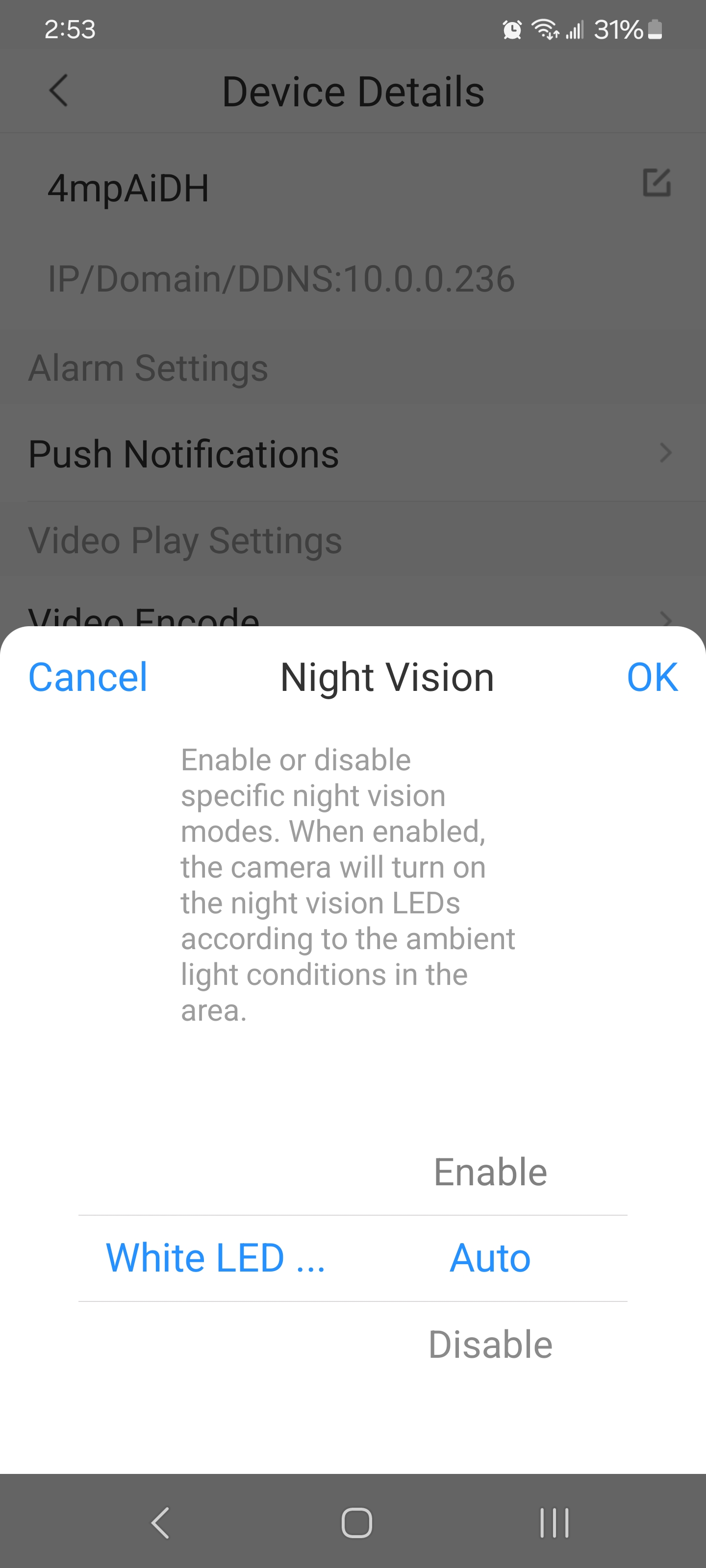

Now I see you say that if you disable Night mode? Is this something in the App like the Picture below?
While I don't have your 2lens Camera and my Amcrest 4lens camera is IR so maybe something different.. The reason for the picture below is that is only camera that I have local right now with White LEDS from Dahua or Amcrest. I do have a couple 1046EW-AI but at this time not installed and I am sure the camera tech is to old for the issue but tomorrow I will install 1 or both again to see if I could get it to act something like your talking about..

When I tested on my camera, While it is a Dahua camera and older Tech in the same type as my 1046 Amcrest camera When I turn off and left on both modes I was able to get push so again might be something in your camera/app for the new camera that doubles as on or off for your push. Would be odd that something as such would get over looked from R&D dept..
