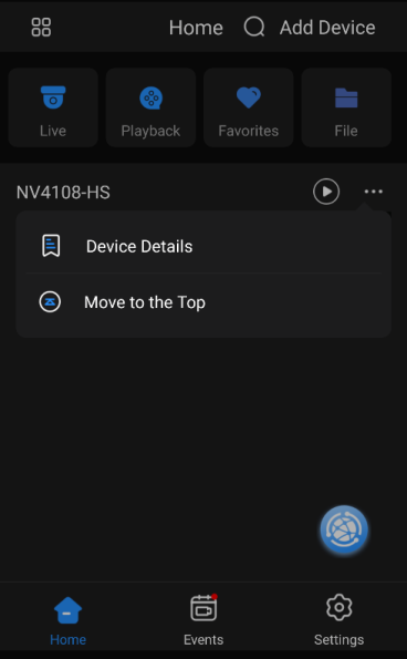

Nhamcrestcam wrote: ↑Fri Sep 13, 2024 5:41 pmthe app doesn't seem to have the settings to control notifications.
On the home screen, click the three dots next to a device, then click "Device Details":
That brings up a screen where you can configure push notifications.
Slicker app but doesn't seem to have parity to original.
After I figured out the new app, I haven't missed the old.
