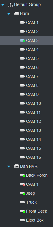

I hope this comes through now. That Cam 1 you see in this picture under Dan NVR, where is this coming from and how do I get rid of it? As you can see I have under Barn (DVR), 16 channels. Under Dan NVR I have 5 = 21 channels that I can view. :D
21 - 16 = 5 extra channels :).

Ok sorry guess I don't understand your question. In ASP that is what it looks like the picture you have is of? You can View up to 64 cameras on 1 machine in one screen using ASP. However in the picture there are 4 cameras turned on (active) when that picture was taken. 1 on 16ch and 3 on the other. From your post before the question was in my mind how can you have more then 16ch (cameras) in your new 4116-A2 NVR? No way I know of out side of using ASP that is a Video Management Software or some other 32ch NVR or matrix device, or some other 3rd party software .

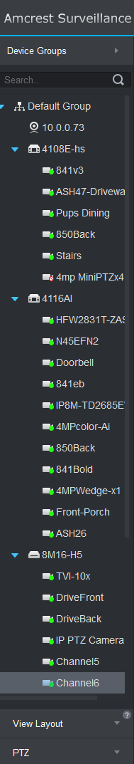

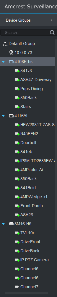

Here is a Picture of some of my systems online in ASP. About your missing camera in your NVR. Remove it form your NVR if you have then right click Dan NVR and click on Refresh and then it should go away. I removed a POE camera from one of my NVR's and then made first image from that still showing on my NVR, 2nd picture you can see that channel is now missing.. Also you can not see them all but in my display I have 36 cameras open. The missing camera is in the 4108E-HS (first one last camera)
