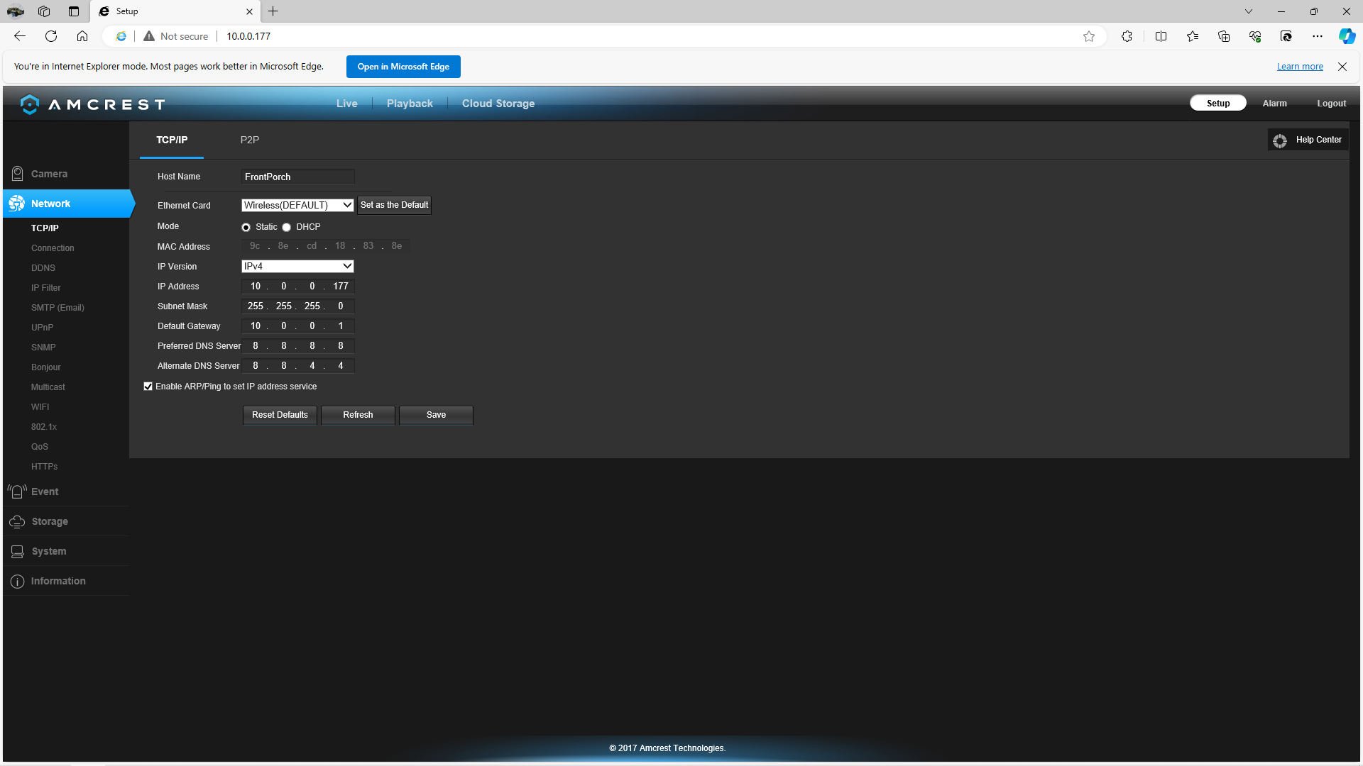

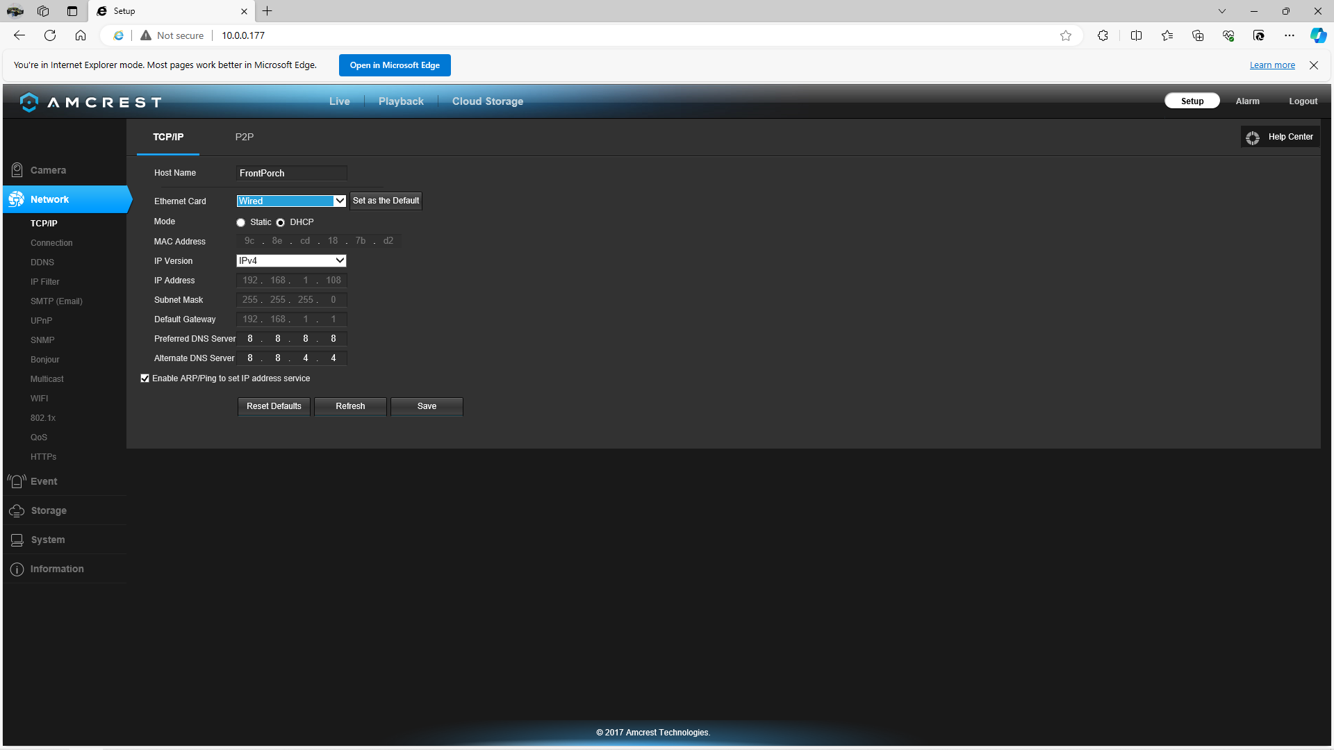

It has been a while since I have owned the 1190W, Personally didn't like the build of the camera. However I am not 100% sure that your camera was setup right. I mean I know that the Amcrest Website has this SoftAP thing and it might have been something to do with some other cameras in the Amcrest line up that you have to pick Wifi or Wired and can't use both. What I can tell you is that I didn't do anything of the sort when I setup the 1190 the first time. So to be honest if you are having an issue making a connection to your computer I would look into doing a Factory Reset of the camera and setup again this time not doing the SoftAP if you don't ever want to use it as a Wifi camera (At this time) again after setup if you wanted to use Wifeless do another Factory Reset and setup SoftAP. However for your needs now my guess is that the camera was setup and the IP it is getting is Wifi and not really a wired IP
2 things I would try. Factory Reset and don't setup or give it any idea that you want to use Wifi. Personally from a setup stand point it would be best done first time using a Hub or Switch that your computer and the camera are connected to. Setup with the POE camera option (Or Try to) I have some wireless cameras that I have setup wired and have used that option. However if it isn't able to setup in that method then setup using Wifi however use the second option of setting up the wifi camera that is connected to a Ethernet cable.
Yet while I am typing this there could be something that is being overlooked. First before you do anything I have typed above I would try this. Make your connection to your laptop with the cable to your camera. Once they are both online press the Windows button on the keyboard and R. In the box that comes up type cmd press enter. then in the dos window type arp -a This should list out your IP for your computer and the camera. I am also thinking that if your camera was setup with this SoftAP that the IP for the camera at might be a IP for Wireless and isn't the same ip that was setup for Wiredd. Now with that in mind if the camera was never setup with a Static IP for Wired connection then you might have to do the reset and or make the connection using the router you setup the camera with to start..
Either way 1 last step that should be done. If you were to do the arp -a and only thing comes up is the laptop and nothing for the camera you will want to make the connection you used to setup the camera to start with. Or Do a reset as outlined above. Next once you get into the system either over a Reset or using the router and the IP you know it is. then you will want to log in click on the setup click on network, then in the TCP/IP it will most likely show wifi as default and will need to setup a Static IP for Wired connection you can go between them by clicking the down arrow. Go to the setup for Wired and choose that as default, then setup the IP for your needs. If you don't already have something on 206 maybe make it that or what ever you like.
Please see pictures below. you will notice that the wifi is setup and is what the IP I am connecting with. When I click on the Wired it was not setup and because of this that is what the camera came programmed with as starting IP. I don't use a Ethernet cable for this camera one of only 4 in my fleet of cameras that uses Wifi the reset are Wired.
My guess is that your IP is going to reflect on the Wifi and not the wired. The camera might be even work at the static IP in my picture and then no configuration changes would need to be done to the camera just adding the IP range to your computer might get your connection you are looking for.
Ideas are hard to guess without knowing what is on your END. Hope something here helps you out..
