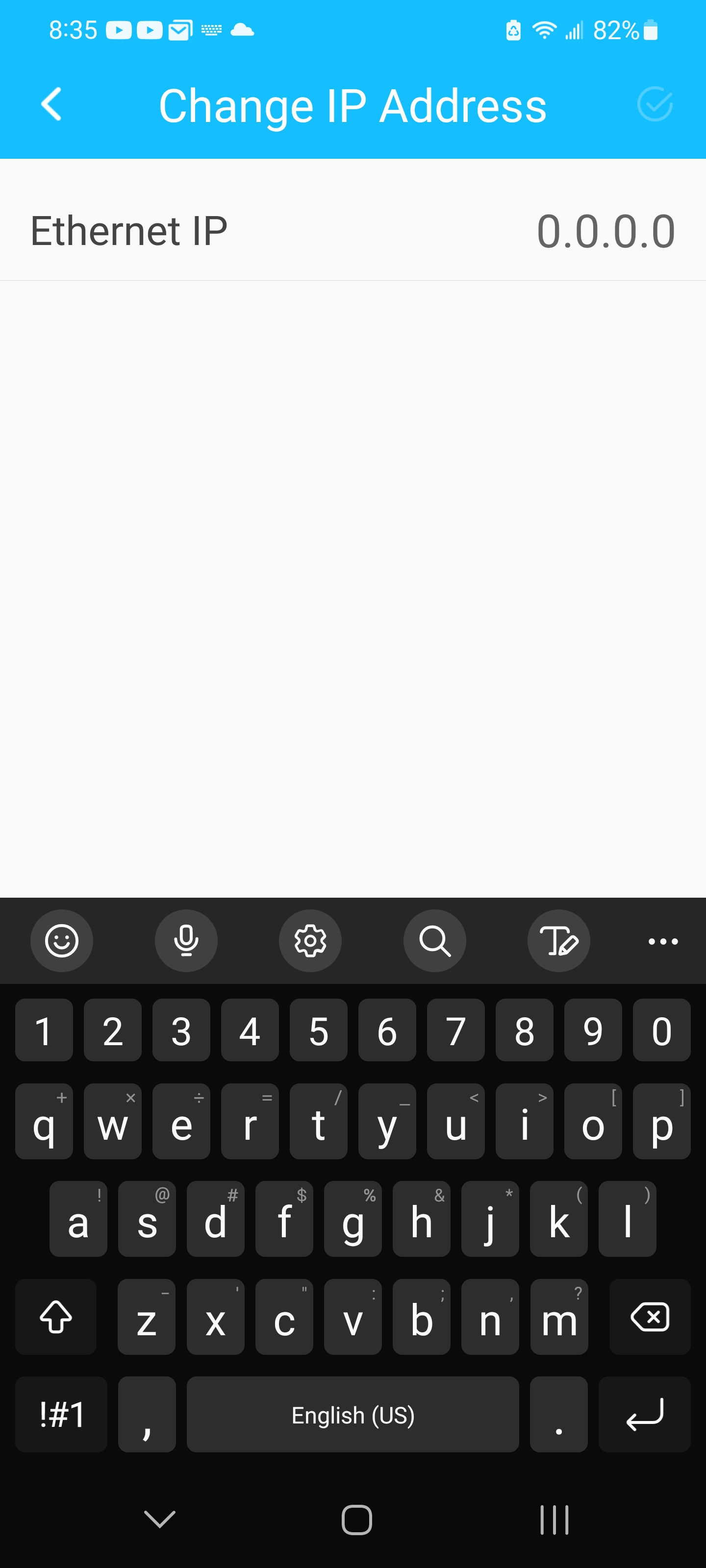

This is from my ash47. I setup static ip in router. Yet looking at my app see picture below my ip in app can now be set static before it couldn't but shows 0.0.0.0 and setting ip in there I could have camera set static and remove from router.
Screenshot_20230908_203545_Amcrest Smart Home.jpg (319.24 KiB) Viewed 2488 times

My app shows me the same thing, but there is no way to set it. I tried setting it on my router, using MAC address, but I can never seem to get that to work.
