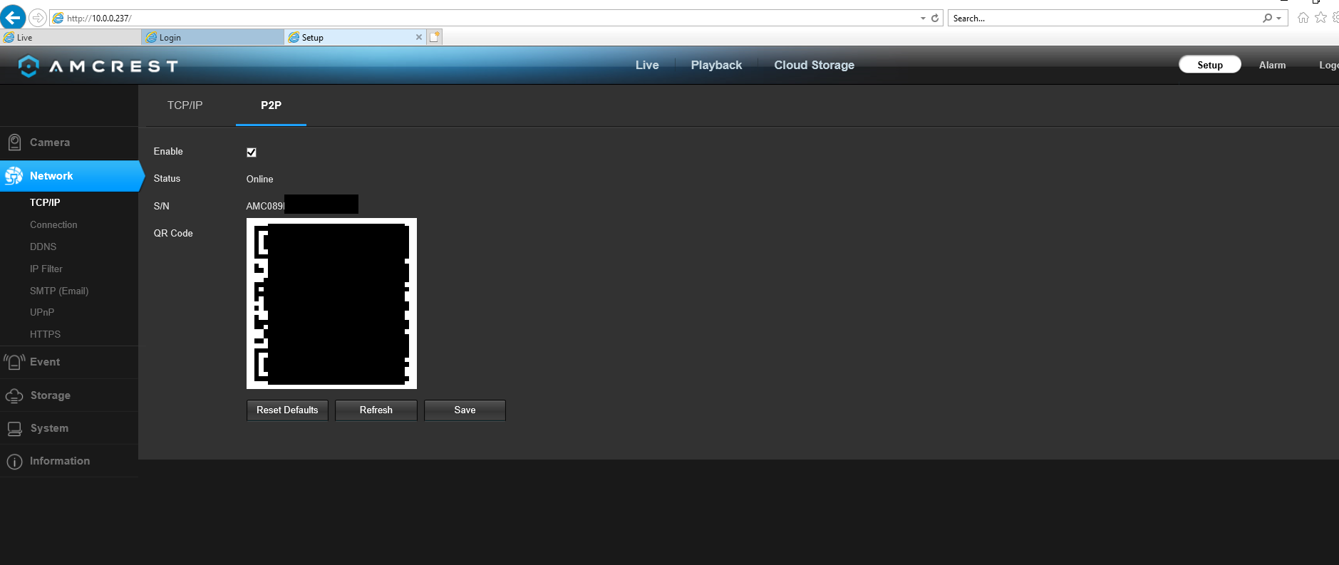

Re: IP2M-841B - Cellular Access Issue
I would personally log into each of the cameras that you can't connect to and make sure that it is connected to the P2P server. You can see from the picture below that it would say Online if it is working. If it isn't online make sure it is enabled. and Then go to network, Tcp/Ip and make sure that there is a good DNS enabled. For usa I use 8.8.8.8 and 8.8.4.4 for first and second dns. Most times that is how the cameras come setup stock. However in some cases they need to be added.. So if you are using Wireless then you will want to make sure you are on the wireless under TCP/IP because there are 2 areas.
I have many cameras from Amcrest and DVR/NVR. I have some mix and added to ASP using P2P and all of them that are added are showing online. I will admit that one NVR did go offline for some reason, I rebooted the NVR and it now shows it is online. Normally I setup my NVR's to reboot nightly. This NVR I didn't have setup to reboot and has been online for over 2 months without a reboot.
Screenshot (4597).png (97.02 KiB) Viewed 5527 times
