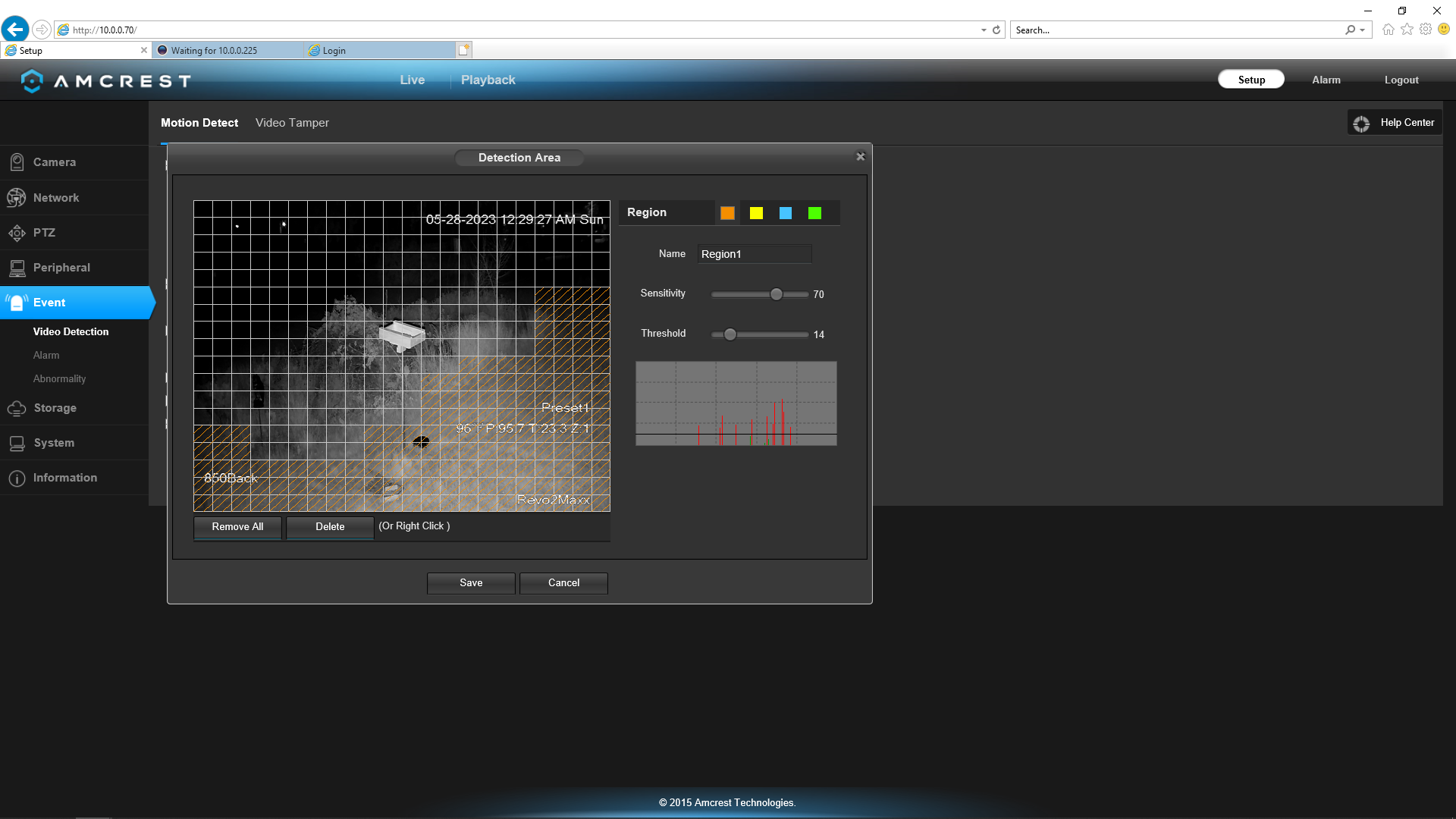

I would log into the NVR's WebUI using IE. I know that IE has been making people Click out and get left out without it after clicking on accept Edge. However if you are not able to use IE setup Edge for your IP to work what is called IE Tab. Then when you go to the IP address for your NVR it will load in a IE tab and always tell you to use Edge I just click out of the box with the X on the right.. However doing this and then going to the NVR's alarm and Motion Detection screen it might have the ability to see the Grid info and how it will work in the settings you have setup. However with my 4116E-HS, and 4108E-HS and a few other devices after going to the 4.0 software that Grid data is now missing. So then you might be able to still access your Cameras Motion Detection and there it still might have the feature. However if they are newer cameras they might have left them out. What I do know is that using Chrome or Edge normal that feature isn't there it has to be IE or IE Mode in Edge.. Below is a picture of one of my IP cameras and mine is a PTZ so I had to move it around to get the motion needed to even show up. However with my settings it will detect humans just fine all the birds don't set it off and that is fine because I have the camera recording full time on another NVR and setup motion for alerts on this one for push. All the alerts for yesterday was a human. Birds, cats and Racoons don't set off the motion.
