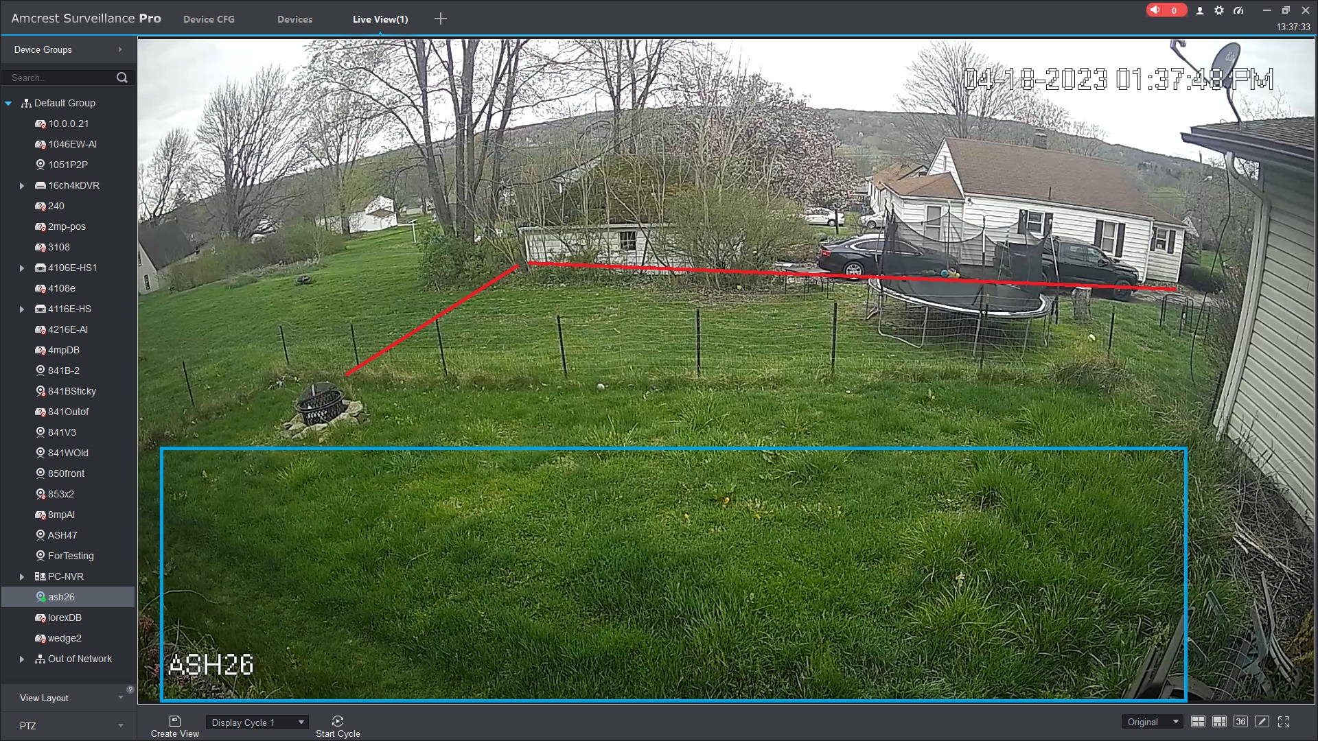

So a couple of things to point out. 1 might want to change the Sensitivity back to 3 or your light might not trigger at night when you are expecting it to. 2, what is the distance from your light to your back area. While I will admit I had to tame my area down because it was getting picked up by my next door neighbor that is 60-80 feet away but what is the distance. Don't try to expect to much from your cameras if they are placed to far away from a scene your trying to capture.
In this picture below I am showing an area that I know my camera can pick up in the red and will even reach out to the door. Anything past the red lines it may or may not pick up that info and record. However to be honest if you want to record fulltime it would be better off setting the ASH26 on a NVR or setup ASP to be your recorder for the camera. Just have to keep in mind with ASP computer has to be on to record. ASP don't have to be on as long as you have PC-NVR setup to auto log in and you have ASH26 setup in PC-NVR for recording..
The Blue area in my picture is where I have my camera setup to detect motion for recording however I do have it setup full time recording to my NVR so I can review anything at any time if I have a need. This camera is sitting on Ch15 of my NVR and not something that I monitor. However is useful if I need to follow something that has happen in one of my other cameras that is heading to yet another camera with this in between. I can follow and listen to anything that the camera might pick up from Mic. Once the event gets to the last post another camera or couple will pick up the footage and so on. This cameras main use is light at night for my pups when they go out to use bathroom. Not 100% critical to my Security footage just a filler.
Screenshot (4380).jpg (980.69 KiB) Viewed 2327 times
