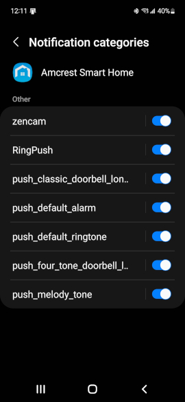

I can provide instructions how to do change AD110/AD410 ringtone notifications for Android SmartHome v3.12.2. Future versions may change things.
open Android Settings
select Search icon
enter "Amcrest"
select "Amcrest Smart Home"
select "Notifications"
select "Notification Categories".
Results in 7 notification categories that Amcrest SmartHome has defined:
These notification categories are undocumented and are rather nonsensical . Through trial and error, here's what the notifications refer to:
Zencam - Human Detected (AD410 only)
push_four_tone_doorbell_long_tone - Doorbell Button pressed (AD110/AD410)
push_melody_tone - Motion Detected (AD110/AD410)
The other 4 categories are not used for doorbells as far as my testing has found. Also, no matter what doorbell tone you select in the SmartHome app, these sounds or notifications remain the same.
To change the doorbell pressed notification:
select the push_four_tone_doorbell_long_tone
select Sound
select any desired existing ringtone from the list, such as "Bells".
You can create your own custom notification sounds, even using voice notifications like "Human Detected at Front Door". There are a lot of guides online you can find for how to do this, but it basically boils down to creating an MP3 file, download to your phone and have it copied to the ringtones and notifications folders, then selecting it per these instructions.

Hmm, not on my phone it isn't. I don't normally enable Motion Detection, just Human Detection - BUT I tested it again with Motion enabled, and confirmed that push_melody_tone is the motion notification sound for the AD410 as well as AD110.

Interesting I wonder why it is different for me. I have the one you mention setup for my Default Verizon tone and I don't normally have motion turned on either normally. So I turned on motion and changed Push_Default_Alarm for my Ring Motion alert and setup the Ring Human alert for human and oddly mine works on them. I didn't look at the AD110 as no one right now to test one at the install location so I didn't bother changing them.
Wonder why it is different for me.
I don't know maybe my Smart Home app is different. I made a Unlisted Video of my setup. It is odd because I have tested it a few times since and even reboot the camera and the phone and still the same So I thought I would make a Video see if I am doing something different?

I didn't notice anything different that would matter. I only saw that your list of notifications included an "AlarmSoundFilter" at the top that my Samsung Android 12 OS/UI 4.1 doesn't have. And I assume you are running the same SH app version as I.
I like that you created custom verbal notifications, which is exactly what I have done too. When the phone is in your pocket, it's better to have the notifications announced rather than a standard ringtone.
Anyway - anyone following these instructions will quickly find out which notification categories are correct for their phone. At least they can see it can somehow vary on different phones for reasons we can't explain.

Hummm, Using a Dec 1st Patched Android Ver 13 UI Ver. 5.0 on a Samsung S21 Ultra 5G, using SmartHome Ver. 3.12.2
Strange that it would be one way for one and another way for another. Doubt it has anything to do with being on Ver13 over the 12.

For me, "zencam" is human detection and "push_default_ringtone" is door button press. I don't have a "push_default_alarm" or "push_four_tone_doorbell_long_tone" in my settings.

@GaryOkie So I found out I think why I have some extra or different settings than others.
I have few different Smart Home devices and it seems that they might have added some extra things to my app that others might not have. (This is only a Guess)
So I will have to delete all my Doorbells and other devices from the app and only add back the AD410 and see what it gives me.
I mean, I have 3 AD110, a AD410, ASH21, ASH26, ASH47 and the battery camera with Base.
