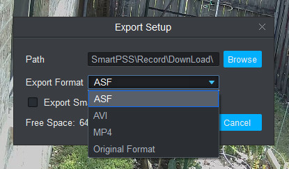

You can choose when you clip a segment...
Re: Series 5 NVR
To be clear. I personally can't find any info about the 5xxx series NVR having another format from NVR. Using a software like Amcrest Surveillance Pro as Bocage is showing to export a clip then yes it would be true even for my old CVI DVR from 2015 I could choose the above formats for Export. From the NVR Menu the export is still DAV.
Re: Series 5 NVR
So today I did some looking around in different areas of my 4216E-AI NVR that is going to be as close to the 5x series NVR's I found only 1 place that I can change the Export output format from DAV to MP4. You would need to use the Backup menu of the NVR. After seeing this I also looked on my 4116E-HS NVR that also has the backup and there DAV and MP4 options are listed.
So from the Backup menu it starts out in MP4 mode and has drop down with DAV..
My Guess is the 5x series will have same type backup menu with MP4 as default backup type..
As stated before by the other. Using ASP you have more options for Export types.
