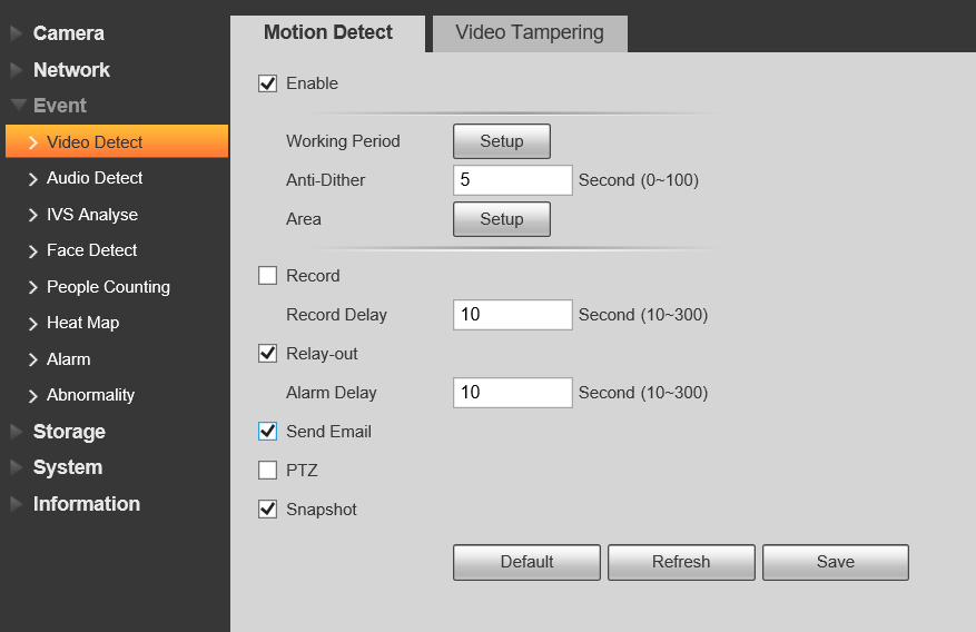

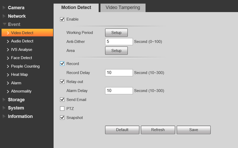

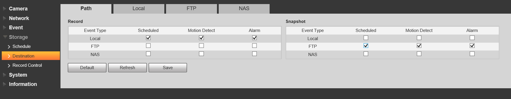

Some things to keep in mind when there is an issue like this..
(You can get a image in email) even if you don't have a Micro SD card installed. However there will be no playback
Next you will want to make sure that you have Record setup for your Device in the settings. If it is camera and have MICRO SD installed then you will want to make sure that you camera is setup to Record on Motion, Meaning you can have your Motion turned on and have emails sent with Image yet nothing will playback unless you also have the Box next to Record turned on and have Motion to go to Micro SD if you have it going to FTP or NAS then you will not have playback from the Device you will have to play it back from FTP or NAS...
First picture here will give you a email, image and will not record to your Micro SD This picture you will get Recordings on your MicroSD if the next picture is also followed as well. Either way with the picture here if motion is detected it will record for 10sec past the Pre Record time set on what ever format you choose in the last picture. Please note that first section is for Recordings. IT is setup for local (MicroSD) and then the Snapshot as per this picture will be uploaded to my FTP site and also because I have it setup for Email it will email the image to me as well..
