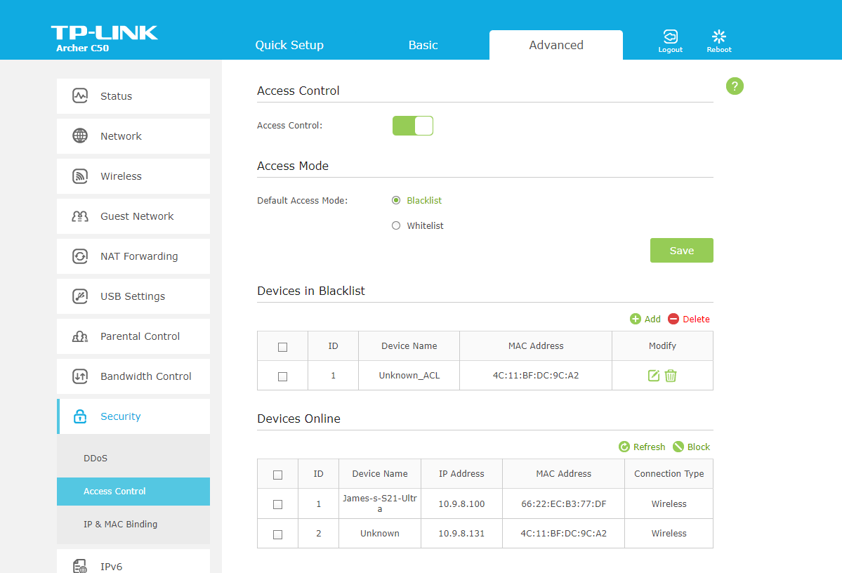

In my TP-Link you can do that within the GUI of the Router, Advanced, Security and choose access Control. Here you have the ability to give or take access to the Internet. This access will still be able to access your local network but won't be given access to anything outside of your local network.
Mine are older Archer C50 v2 and I use one as a Repeater and one as a router today, I don't use them as my main routers on my network but it works either way. My Nighthawks have the option as well, Use 6100, 6400 and 7000P in my setup and all of them also have that feature..
If your 1750 is the C7 I can confirm that it does offer the access control as well. Also by adding all devices to the Black list will make sure that any thing that is connected to your router without your giving access it will not have access to the internet however that will not block someone from that network..

I just wanted to mention that I have tested this with the TP link again because it has been a while since I used the Block on there seeing I have not been using that for outside connections on a Router mode setup..
I reset one of my TP-Link C50 routers, Setup on DHCP, Gave a 841 Wifi access. Setup the 841 in ASP and on my Phone Via P2P. I connected my Phone to the router as well. After logging into the Routers WebUI and Blacklisting that camera in the routers table I can no longer access that camera on my phone or on ASP over P2P however on my phone going to the Cameras IP of 10.9.8.131 I was able to access the camera over the local network. So doing this to your cameras, if you have a NVR giving your NVR internet access then you can view your cameras over your NVR though P2P.. As I said above, having your router setup that you have to give access to anyone that makes a new connection is safe as well. This way like someone while your away plugging into your router to try and gain access to the internet would block the access and they most likely would guess your cameras were connected over a NVR type connection and didn't have internet access they could use...

Your Router you are setting up to Black list anything that logs in. Then you will remove the ones you want to give access.. You can White list ones you already know on your network. Then in the picture above where it shows the Blacklist you would just press the trash can to give it access. It wouldn't add to white list unless you setup to add to whitelist.. But that option isn't wise... Giving access to white list is one thing but setting up to just Whitelist all new log ins not wise..
