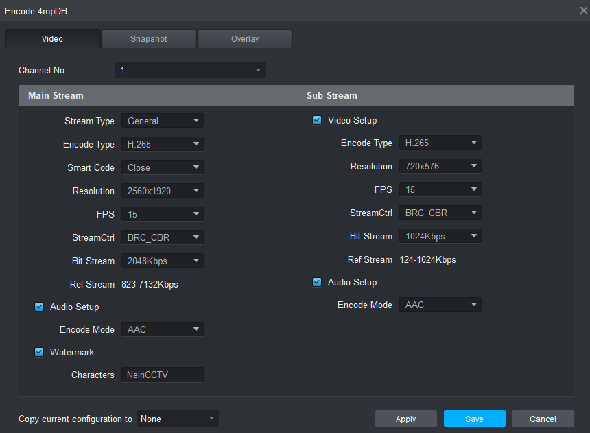

@LMANNING - I have not paid much attention to AD410 snapshots until you pointed this out. I concur - they are not close to the full resolution of the 2K camera but instead the snapshot resolution is hardcoded to 720x576 - even if the quality in the SH app is set to HD.
I tried to view and/or change the snapshot resolution via ASP and SmarPSS apps but both CRASH when selecting the Snapshot Encode menu! I also tried via the NVR and it didn't crash, but said "failed to obtain config".
This command will show the snapshot configuration when HD mode is selected:
<ip>/cgi-bin/configManager.cgi?action=getConfig&name=Encode[0].SnapFormat[0]
You can clearly see the default "HD" resolution settings here. The SD settings (when [1] is specified instead of [0]) are the same resolution!
It should be possible to change the resolution via the API, but given that the Amcrest Surveillance Pro app crashes just trying to view snapshot encoding, something very fishy is going on in the API.

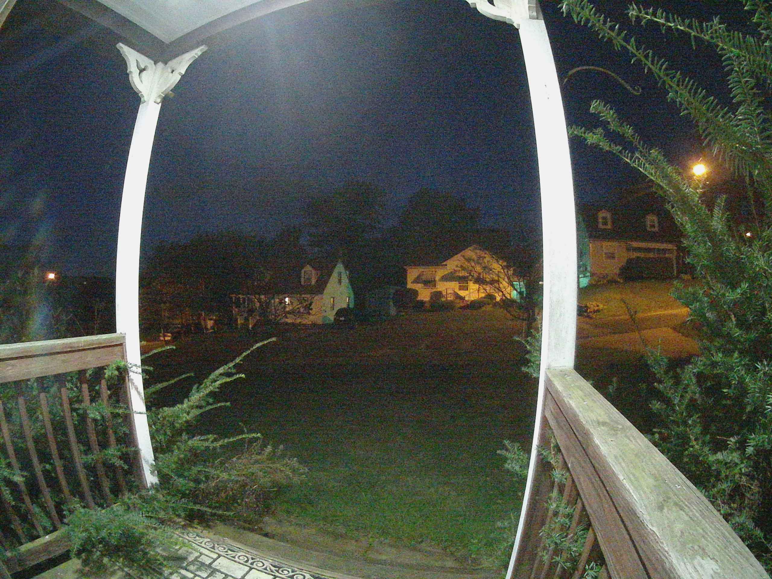

@Robertus Your issue is very different from the OP. There is nothing wrong with your URL - you have selected subtype 0, which is the 2K UHD stream. Generally, with good lighting, the video stream is quite good.
Your image shows a low light condition requiring IR illumination. I don't think the quality is lacking due to being over compressed but may be due to the default sharpness setting which is 50. I've changed mine to turn off sharpness to its lowest settingh (0) for the night time profile. This unfortunately isn't possible via the SmartHome app. You CAN safely change it via Amcrest Surveillance Pro, SmarPSS, or via the API. This should help your low light video quality. it has for me and others who have reported the same issue with nighttime video.
Code: Select all
table.Encode[0].SnapFormat[0].Audio.Bitrate=64
table.Encode[0].SnapFormat[0].Audio.Compression=AAC
table.Encode[0].SnapFormat[0].Audio.Depth=16
table.Encode[0].SnapFormat[0].Audio.Frequency=8000
table.Encode[0].SnapFormat[0].Audio.Pack=DHAV
table.Encode[0].SnapFormat[0].AudioEnable=true
table.Encode[0].SnapFormat[0].Video.resolution=720x576
table.Encode[0].SnapFormat[0].Video.BitRate=1024
table.Encode[0].SnapFormat[0].Video.BitRateControl=VBR
table.Encode[0].SnapFormat[0].Video.Compression=MJPG
table.Encode[0].SnapFormat[0].Video.FPS=1.000000
table.Encode[0].SnapFormat[0].Video.GOP=60
table.Encode[0].SnapFormat[0].Video.Height=576
table.Encode[0].SnapFormat[0].Video.Pack=DHAV
table.Encode[0].SnapFormat[0].Video.Priority=0
table.Encode[0].SnapFormat[0].Video.Profile=Main
table.Encode[0].SnapFormat[0].Video.Quality=5
table.Encode[0].SnapFormat[0].Video.QualityRange=6
table.Encode[0].SnapFormat[0].Video.SVCTLayer=1
table.Encode[0].SnapFormat[0].Video.Width=720
table.Encode[0].SnapFormat[0].VideoEnable=trueIt should be possible to change the resolution via the API, but given that the Amcrest Surveillance Pro app crashes just trying to view snapshot encoding, something very fishy is going on in the API.

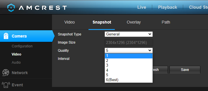

I agree with GaryOkie, the images that get saved are 720x576 which is significantly lower than the sharp video 2560x1920. Other cameras have an option to raise the quality to 6. It should just pull from whatever the video resolution is. Glad I am not crazy. I have also heard of making any changes without the app can brick Amcrest cameras so I am hesitant to do that and I am hoping Amcrest just forgot this setting. You both seem more knowledgeable than me about the issue. Thank you for the input!
Attaching the web interface with the option of a different Amcrest camera
- Amcrest Quality6.png (42.18 KiB) Viewed 4169 times
