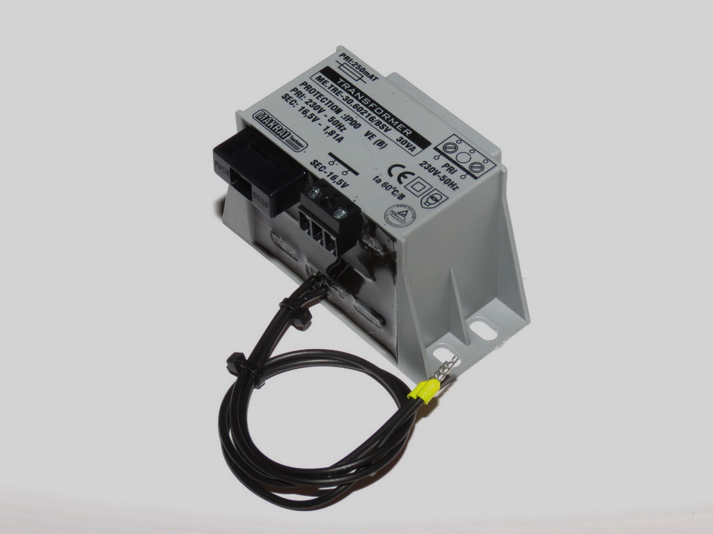

Update - I've ordered this one > Makrai ME.TRE-30 | Transformer 30VA 16V (1,81A) IP44 230V
I Must admit this is not a great experience searching hours for a suitable transformer in the UK for this Smart doorbell. Well I hope this works, It should arrive in a week. Great Test Case -
Makrai ME.TRE-30 Transformer 30VA 16V (1,81A) IP44.jpg (101.43 KiB) Viewed 5282 times

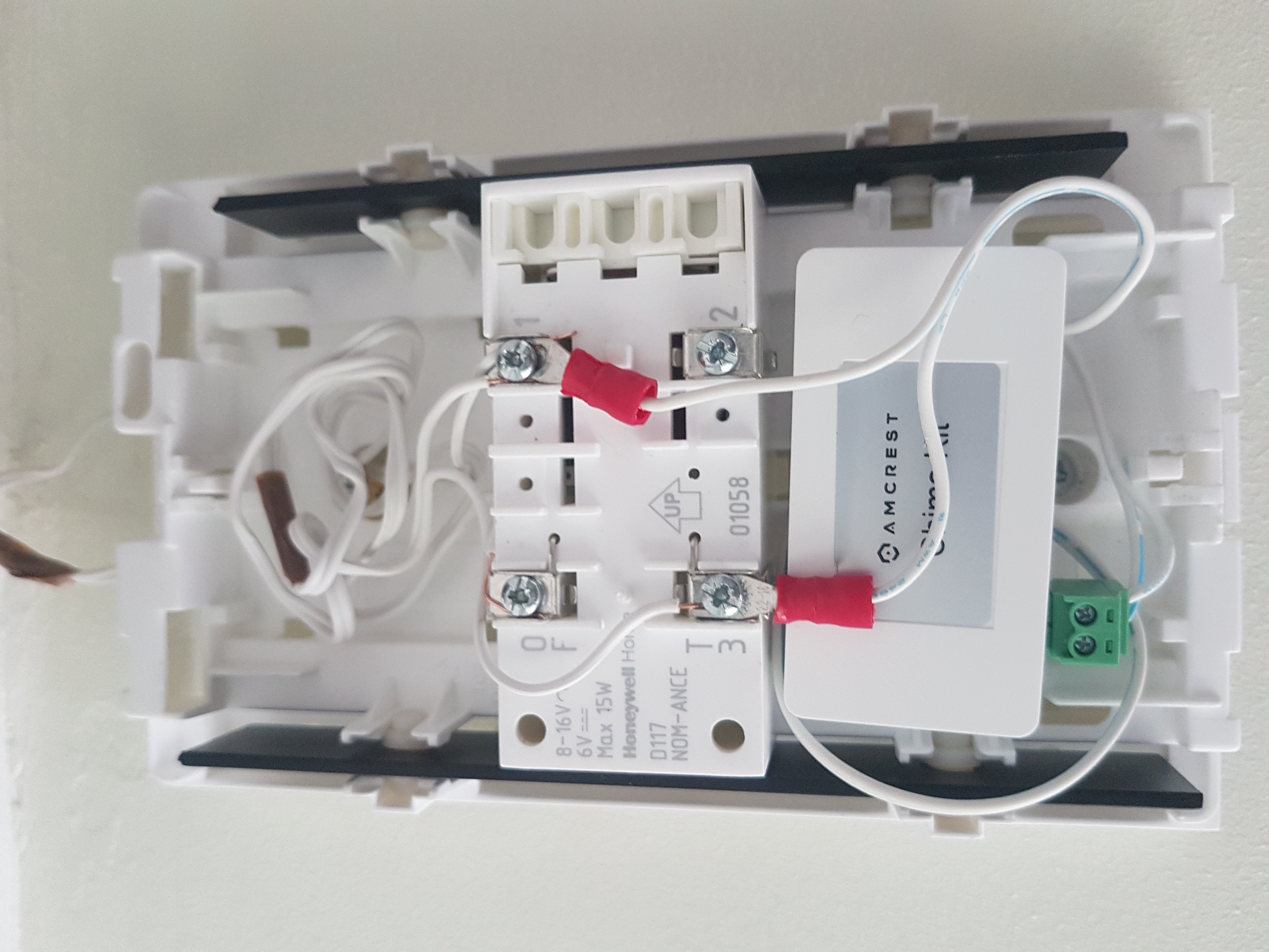

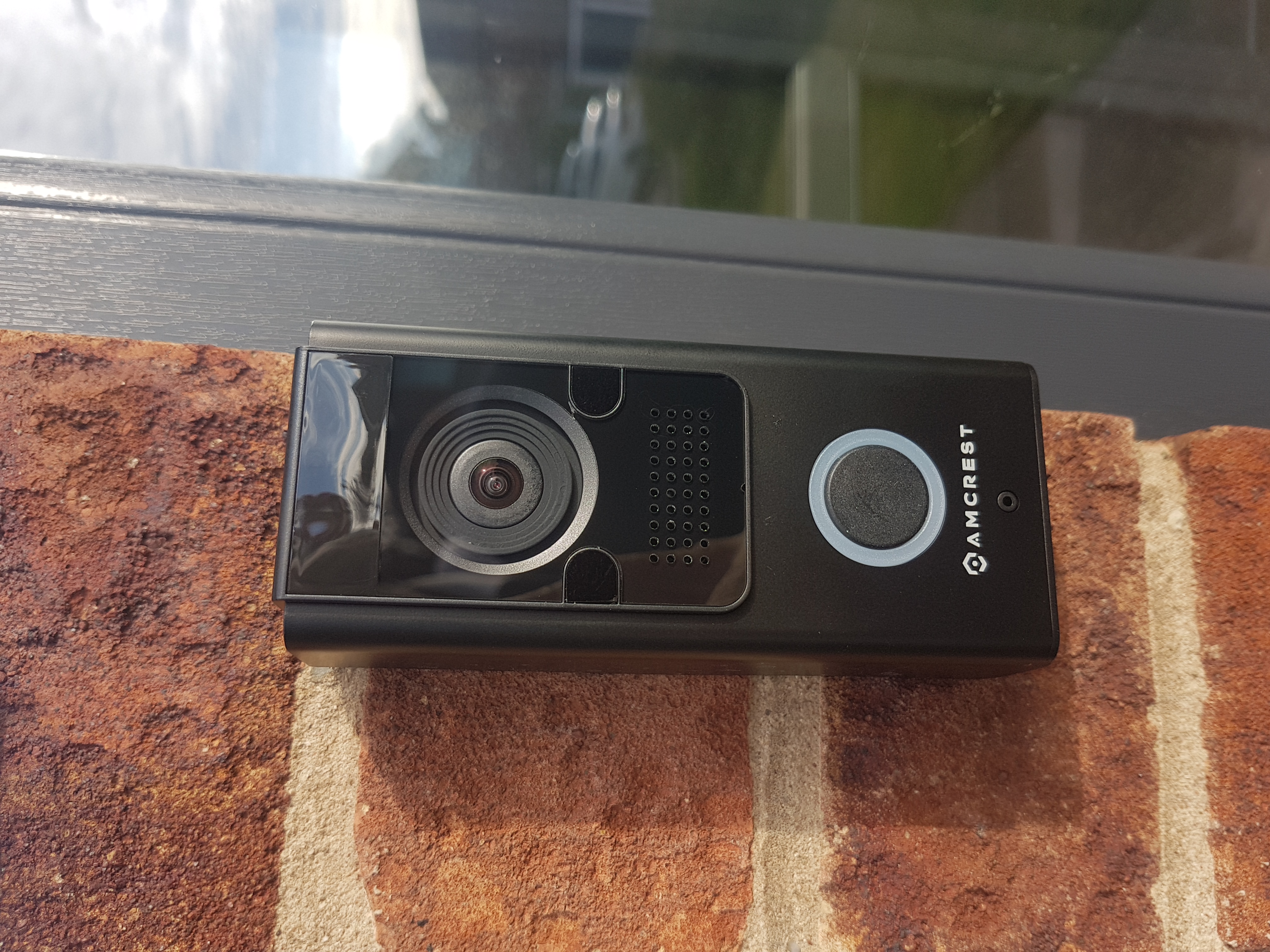

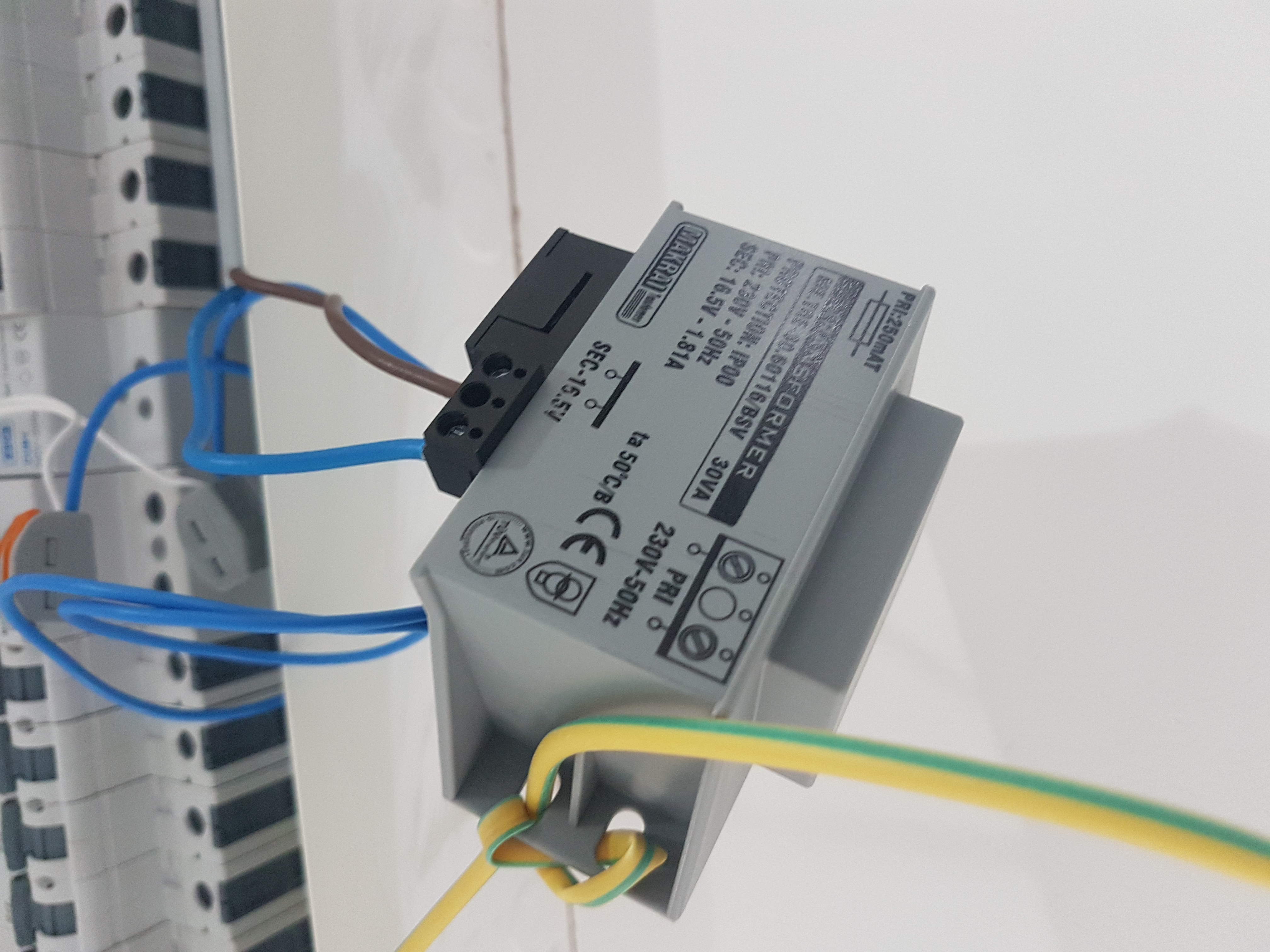

Installation Completed -
So I Installed the Makrai ME.TRE-30 | Transformer 30VA 16V (1,81A) IP44 230V today.
Followed the Steps on the app.... It still crashed. (Samsung S7) Called support in the US who advised to install app on another device. Installed to Lenovo Tablet YT3 X50F and BOOM. Its worked .
Unable to get the mobile app running on Samsung Galaxy S7
AD110 Smart Doorbell Camera is fully set up with CHIME -
Phewww Tad pain buying another transformer but its works. - No Buzzing from the transformer so it will be mounted above the consumer unit in-between the next level Joist.
