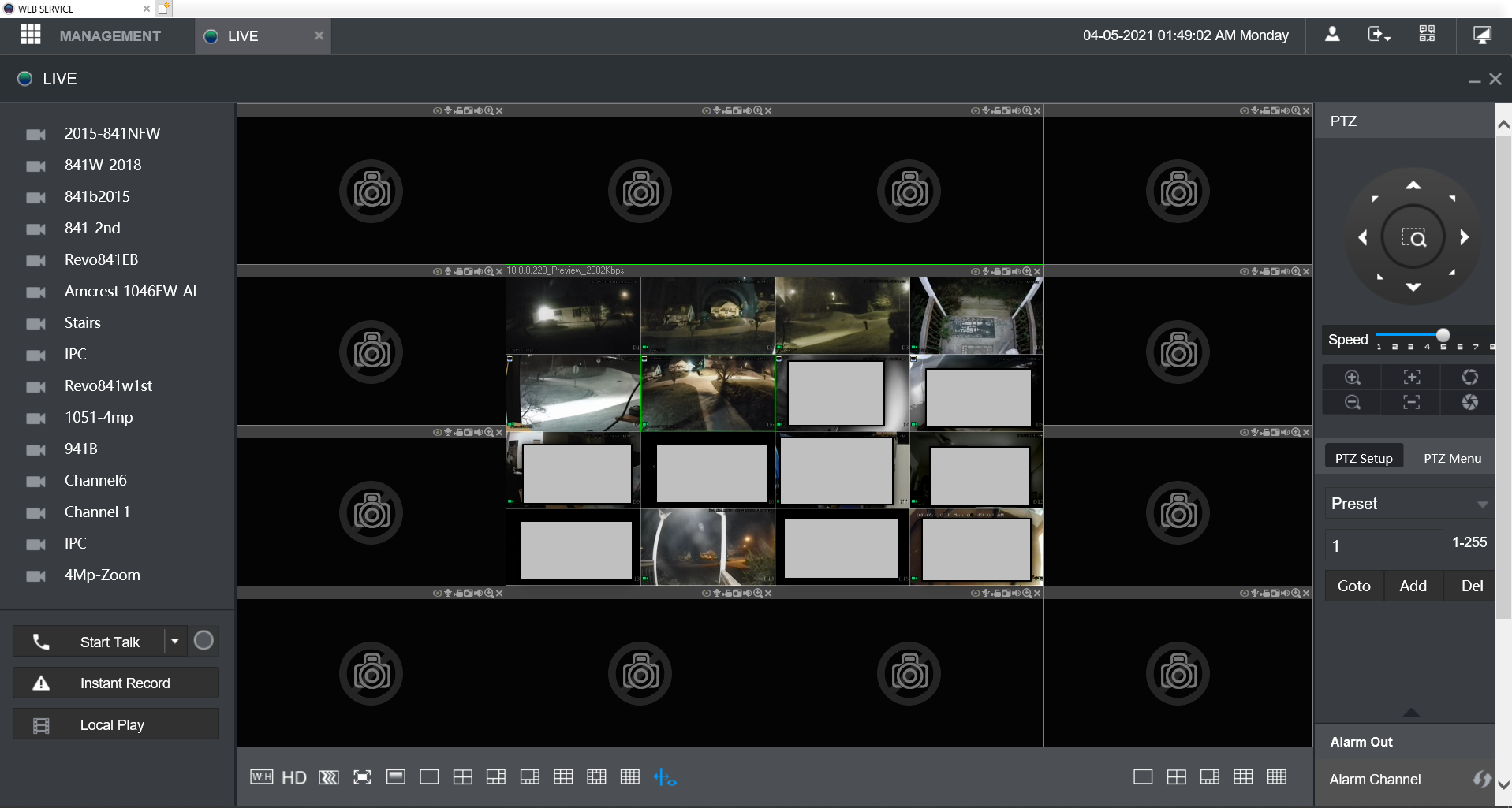

The cool thing I found for the NVR is that on the left hand side bottom I can pick the layout. Then on the right side bottom is another setup for Grids. Now if I take 8 grid layout from the left to show on Screen and I choose 16ch layout from the right side it will put the NVR in 16ch layout mode showing my 16 cameras and also display that layout in the IE.. Now I am not sure on what Options will be able for someone running Full 8mp sorry I did say 8K meant 4k 8mp.. Have a lot of things that I have been dealing with.. Anyway it would be interesting to see if it would give you a larger layout in IE then in the NVR.. Something worth checking anyway..
This is a 13 view layout with 16ch in the HD field I did cover some cameras that I don't display for security reasons.. There is no Photo Shop here it is just all from IE and the Cover ups are apart of my Screen Capture software...

It gives me the opportunity, after I selected to install the activex, to open up to 16 windows.
