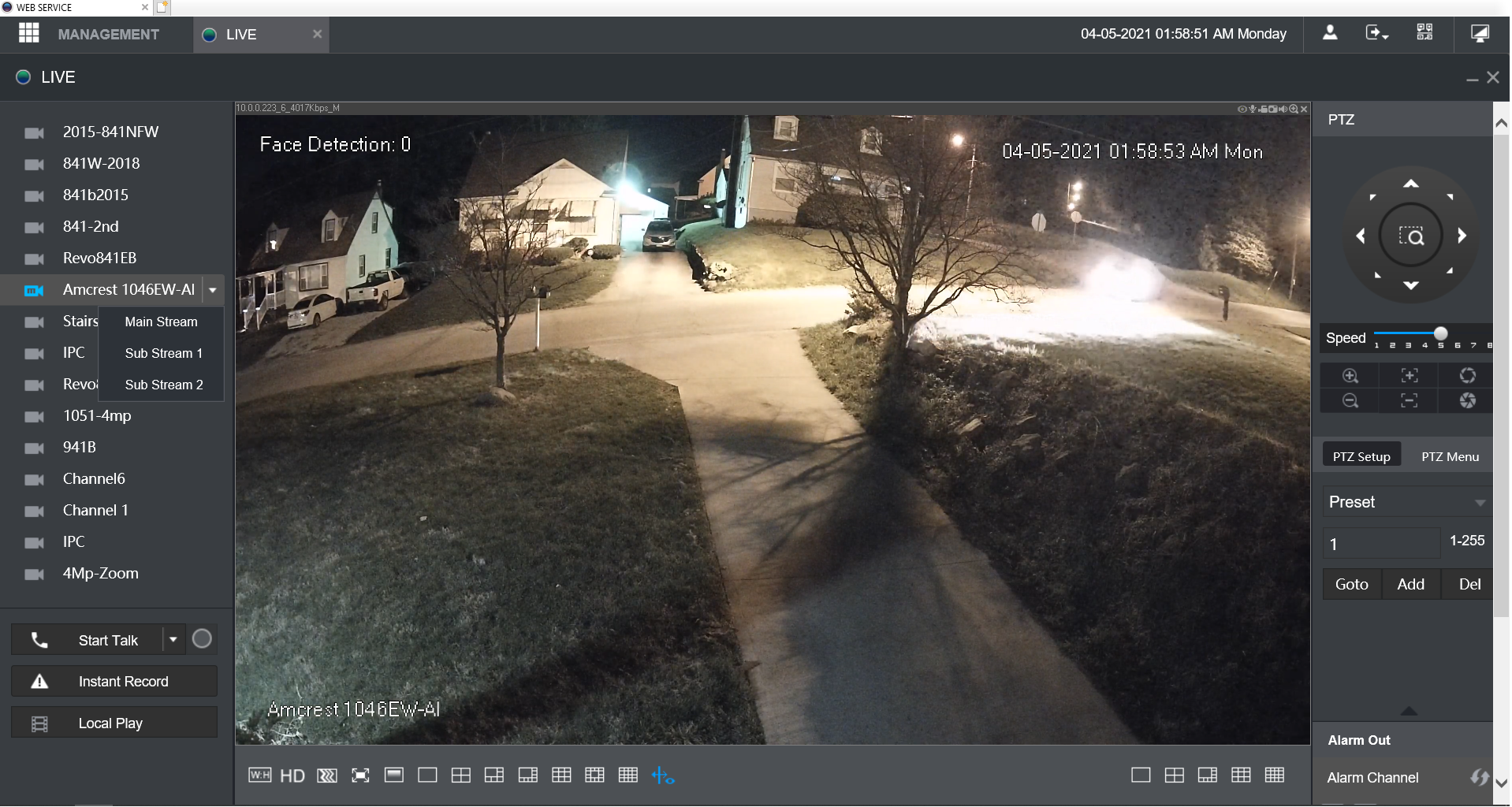

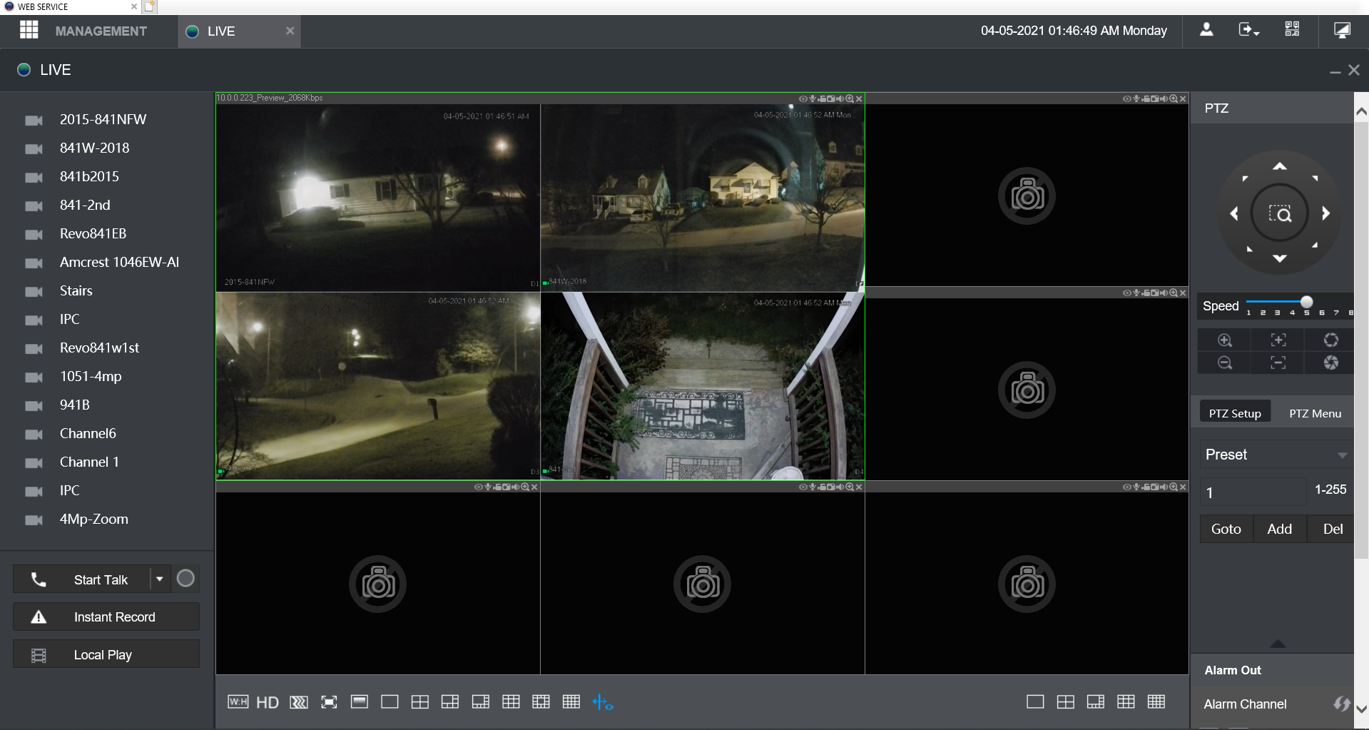

So on the WebUI,, You can on the right of the channel drop down and choose Main and Sub Then you can save your view for when you return to turn them on

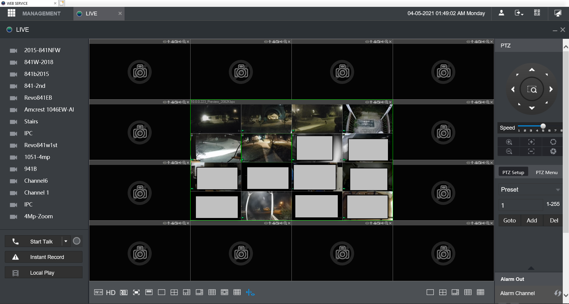

13View with 16split, I covered up some channels that don't need to be seen.. Others have been seen before so they are ok to show..
6view with 4Split in Spot 1

Here is a Picture showing where to change the Main or Sub. However on this NVR it don't have the Fast load option and sadly my 4108E-HS is broken atm I can't find any older pictures of the WebUI this picture is of a Newer 16ch NVR but same idea..

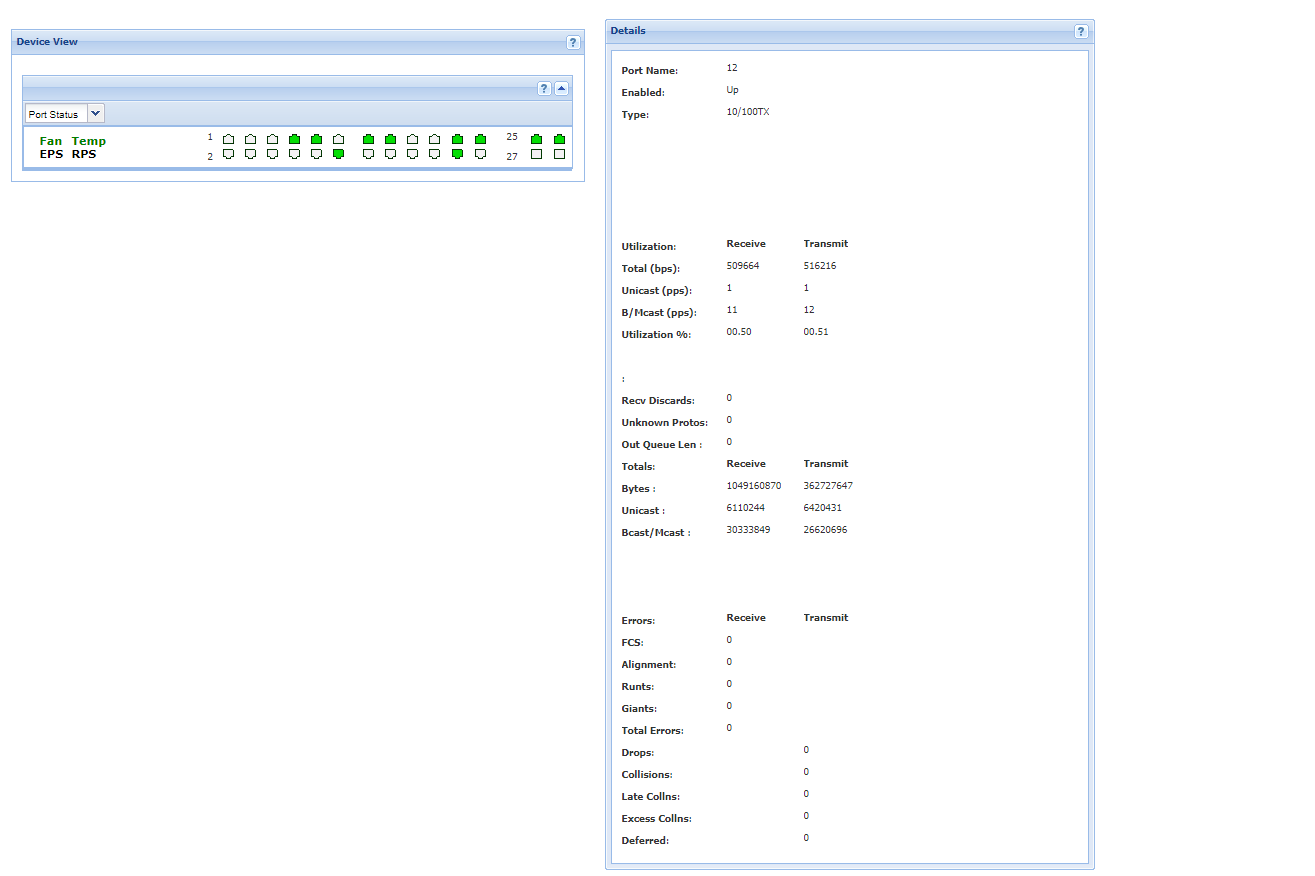

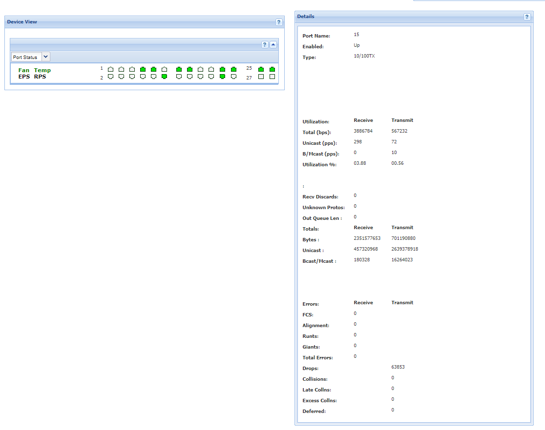

Next and this really only going to be easy if your connected to a Switch. However you could TRY a different port if the cables are not CCA... ON the POE PORT of the NVR it will change things but doing so can test if the issue is port related... Also if your using a Managed POE Switch you could look at your Switch for tell tell signs of issues on the PORT or machine logs... In my 2 pictures the first 12 are POE ports and the last 12 are normal ports however I wanted to show on port 12 you will see there is no issue and to be honest on 15 there is no issue however that is where I connect cameras for testing and setup and when I disconnect a camera it can cause a Drop so it is showing that port has had loads of Drops. However lets say that was your Port and nothing was plugged in a removed alot it was just 1 camera always plugged in and looked like that then you would know there is a problem with that port would want to look it over for damage or bad cord Also a lot of my POE devices are not connected to my POE NVR's so they are not on my Switch besides the 3 that are showing as doing some work on them off my normal non POE NVR's.. So they stay on the switch for right now...
