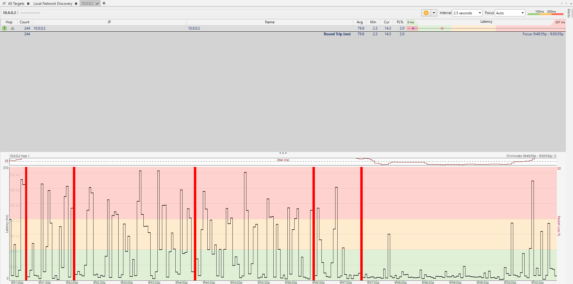

Here is what I've been able to observe.
At night time if IR is on Auto, it constantly cycles off/on you can see it clearly using Ping Plotter. It's so perfectly predictable.
Screen Shot 2021-02-08 at 7.29.15 PM.jpg (113.91 KiB) Viewed 3251 times
However, if I keep Night Vision setting to either ON/OFF, no issues whatsoever.

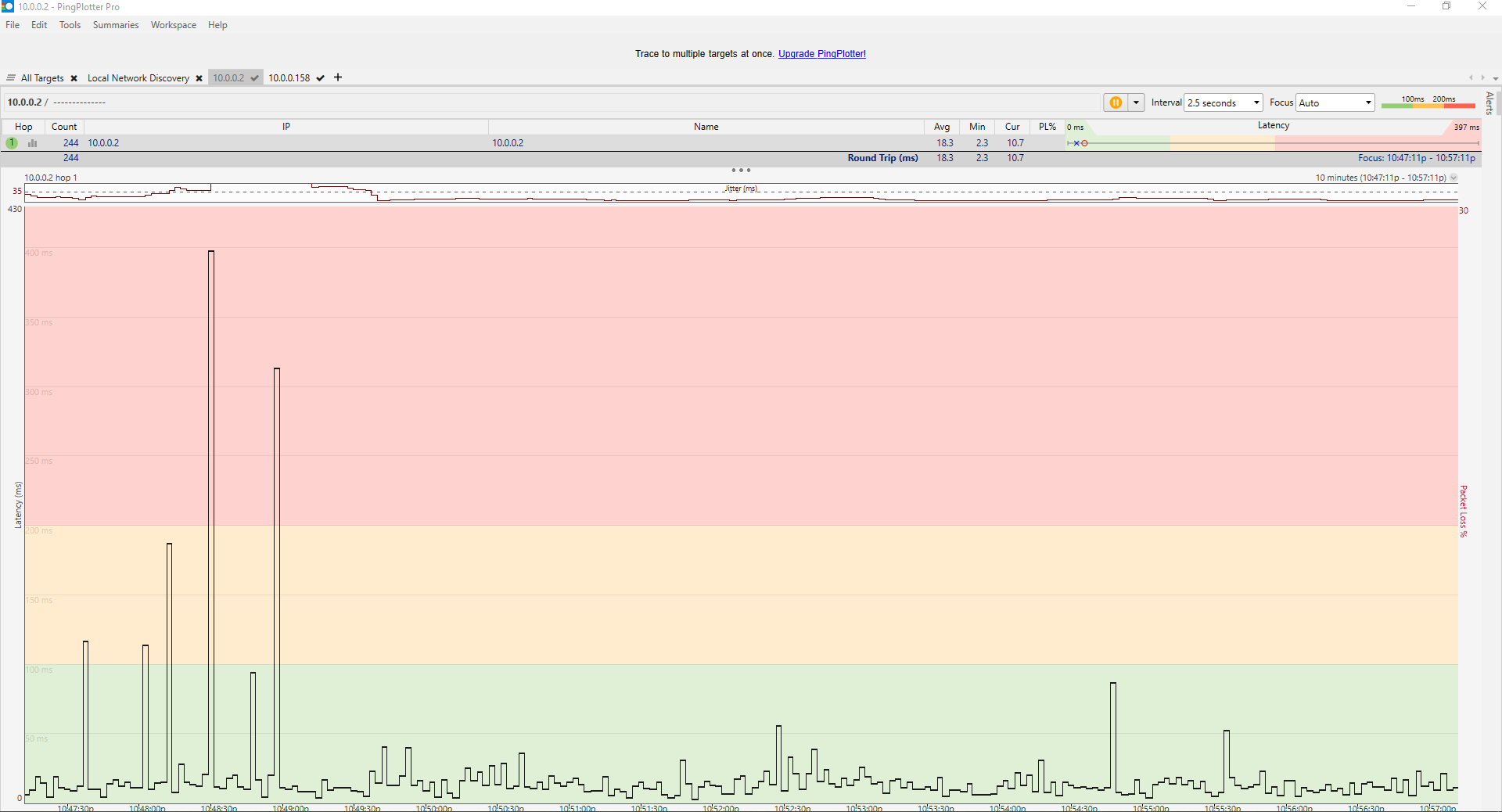

I am not sure what or why the Ping Plotter does what it does.. I can tell you that I have used that program and if the Red lines is to show package Drops there is some issues that one of my programs is telling lies about my system then.. Ping Plotter has a red line 30 seconds later another red line and then 5 minutes it cycles and does the same thing again and I can tell you that I have a program that is able to log into my Doorbell camera and Check for lag and any issues in deeper then Ping Plotter as it has the Password and user for access and looking over the same time of history I can see when a Car goes by as both programs go into a higher state of activity then when it is in stand by mode..
So I am not sure about the Script you made. Not sure with you being a new user how many people are going to feel like they should use a script of a new person with only thing posted is about this Doorbell.. I have watched my Ping Plotter and only see high times when there is Motion to the front of the camera. Not sure the Relation of your very large Red lines I have never had that while I have had some very short ones

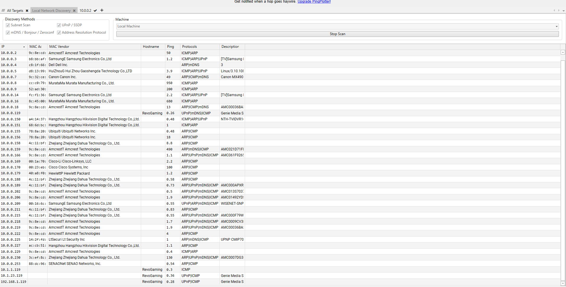

If I had to guess there might be an issue over the Network.. This isn't all my network devices this is only what I could get on the screen from others being in a different IP range but you can see there are a few items in my Network but I have not had any Packet loss nor does my camera go offline
I would guess check your Wiring, and check your network for lag, maybe even Reboot the Router..
In my network there are more switches then shown as well again they are behind one of the other routers in different IP range, along with 6 ip cameras on a 8ch POE nvr about mile away. Right click an image and show in new tab to see full screen to make it so it isn't blurry
Re: AD110 Doorbell Auto Night Vision Reboot

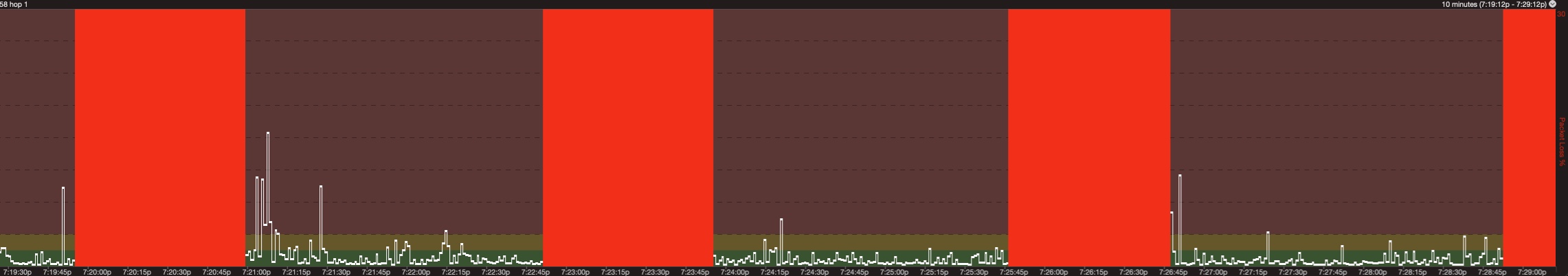

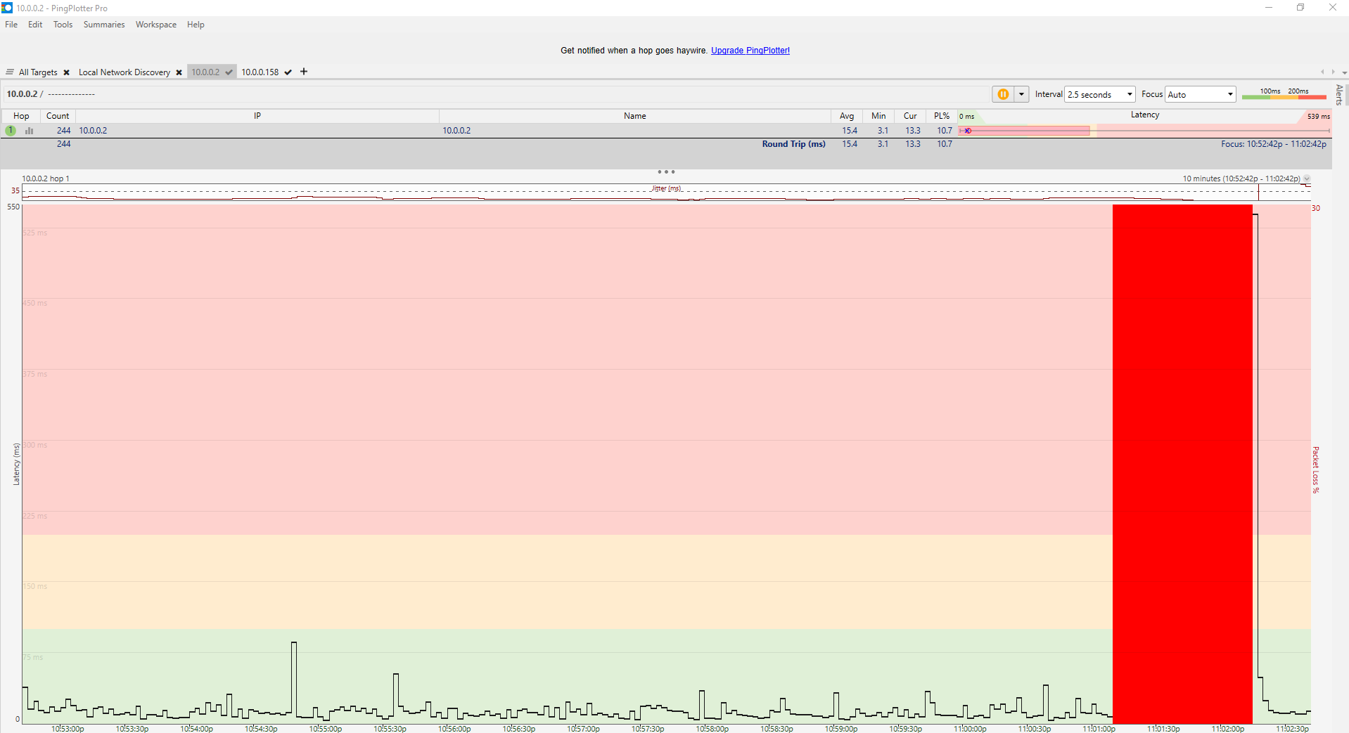

Also I am not sure if you know but using that program your always Flooding the IP with Pings and then that is the request being answered that comes up in that list that you posted!? After playing with the program little more I remembered why I stopped using it myself..
Sadly don't think the issue is related to IR
I have my Camera setup on Auto, Here is what Ping Plotter looks like after I turn off Network scan and only have it pinging the Camera at this area of the program.. Last Picture I did a Reboot of the camera

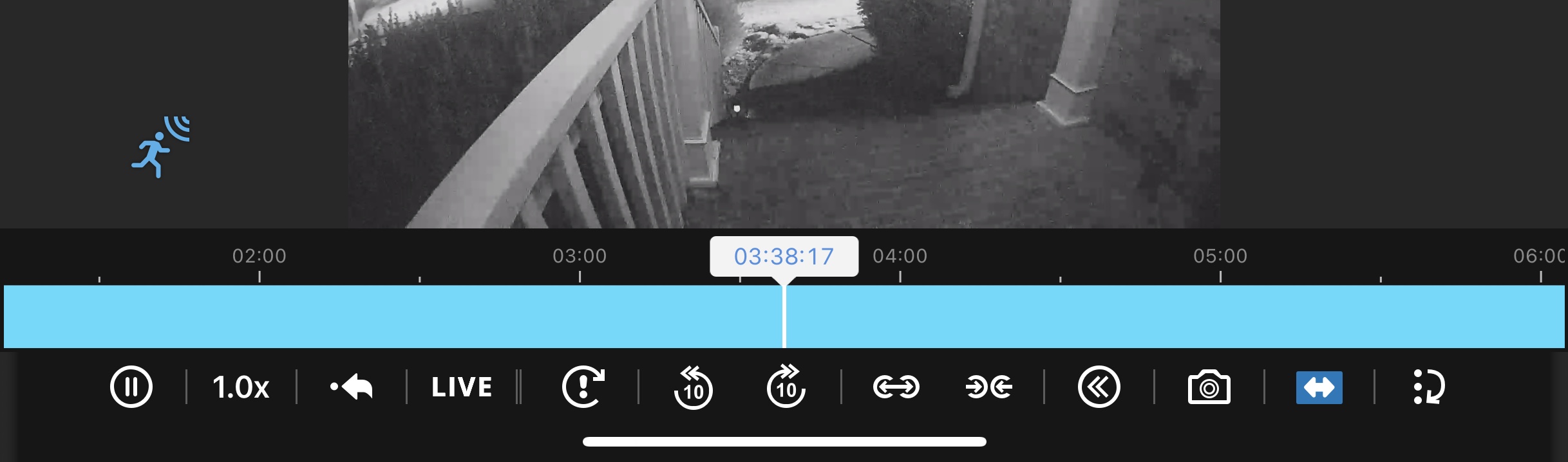

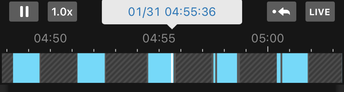

If you look at the recording history from the Synology app you can see the same issue. Offline/Online...

Last night I decided to test Synology. I set motion sensitivity to its highest and put in a flicker bulb. As you can see the doorbell and Synology had no issue recording the whole night, so long as Night Vision was set to On.
However, when I put the camera’s Night Vision on Auto, like clockwork it went into its boot loop.
Now here is the interesting part, I disable Synology while the camera is set for Night Vision Auto... and the camera stays online...
So here are the conditions for my camera to fail
- Night Vision set to Auto
- It only happens at night
- Synology has to be enabled
