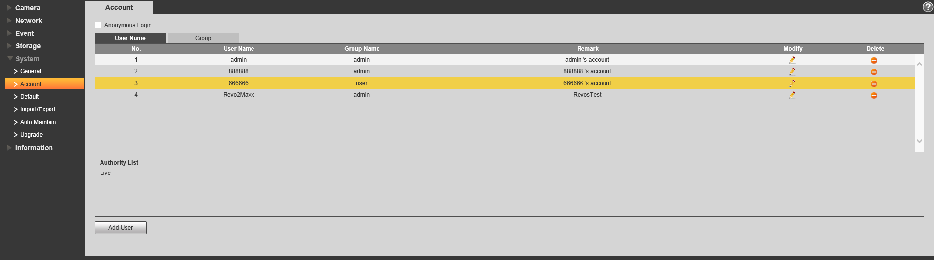

Could you post a Snap Shot of your V3 User menu and what FW version are you using Thanks

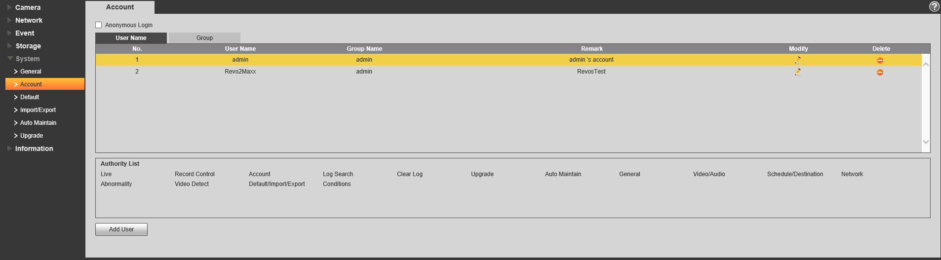

OK well I just checked another one of my Cameras that I know is setup the same way from Many Moons ago.. So I wasn't sure if there was other accounts on this one but I did add my account back, Made change to the admin password and I was able to make changes to the 6 and 8 account names as well.. Strange enough I was not able to make this change of deleting the accounts until I changed the password for them..
When your on the page for the accounts have you tried to delete them?
