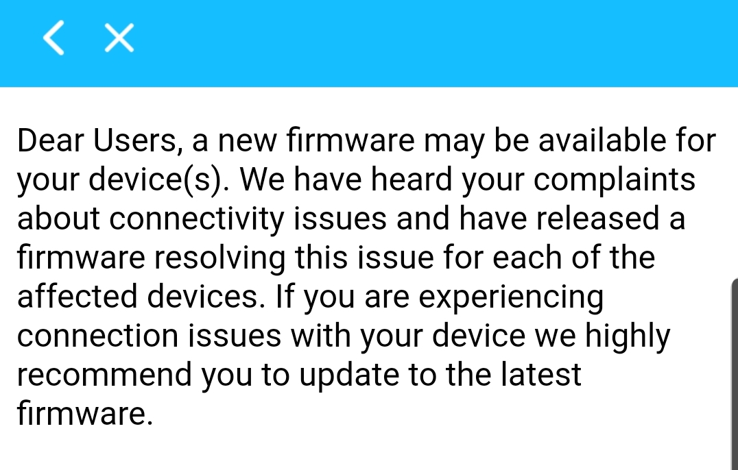

So this morning i got a system alert in the app dated 9/4/2020 stating there is a new firmware. to address connectivity issues. But the app says I am on the latest one from 7/02/20. Anyone else get this?

I'm having the same issue. Said there was firmware, went to check and it says up to date and version number does not appear to have changed.
Re: AD110 New Firmware??
Hello, What you have there is a Push message from the Content Creator or in this Case Amcrest.. It isn't that your Camera isn't running on the right Firmware it is to inform others that are still on the old FW that there is a new one that Resolved the Server Error issues... While they might have been able to figure a way to Push only the Message to the Users on older FW I am going to guess that it was built into the System to be able to Push messages as a whole and it was easier to just do a System Wide Notice rather then having to make changes to Code for older FW Push...
