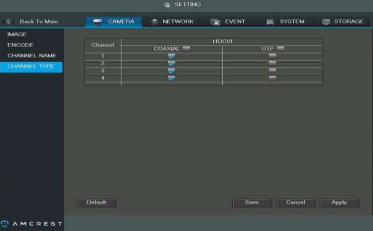

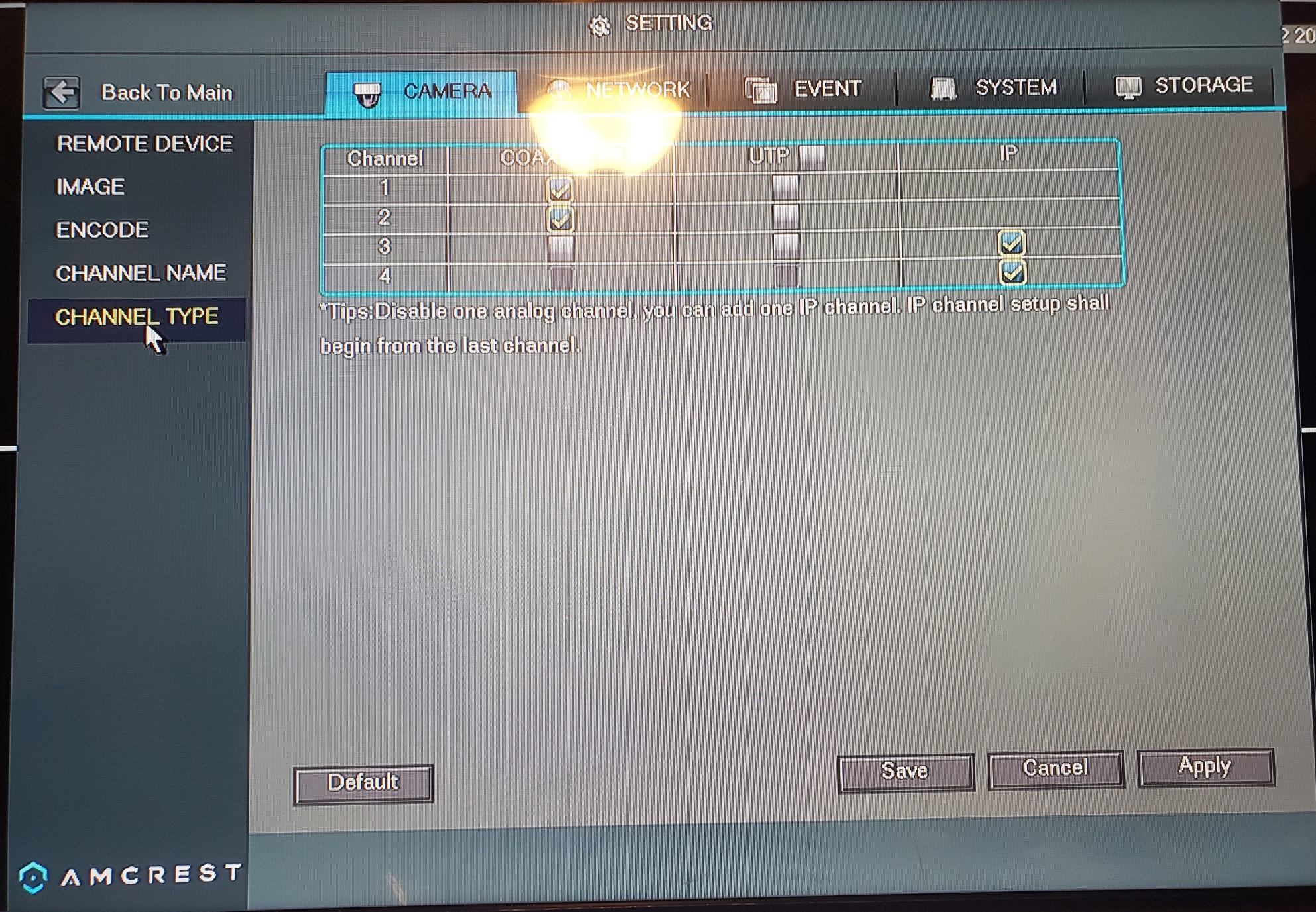

Anyway Before the update in FW this is what my Camera Type looked like (Picture Below) Edit adding what it looks like today sorry about the light in the reflection
So after the Update of FW now I have a 3rd option in there that lets me change Ch4 and ch3 to IP channels.. Your model being the same as mine just with MORE Channels should have the same option beside might offer 4 rather then 2 ch... Either way it don't hurt to look in your current setup and see if you have the option for IP cameras...

Here is what it looks like after the Update in FW to the 12-15 version
