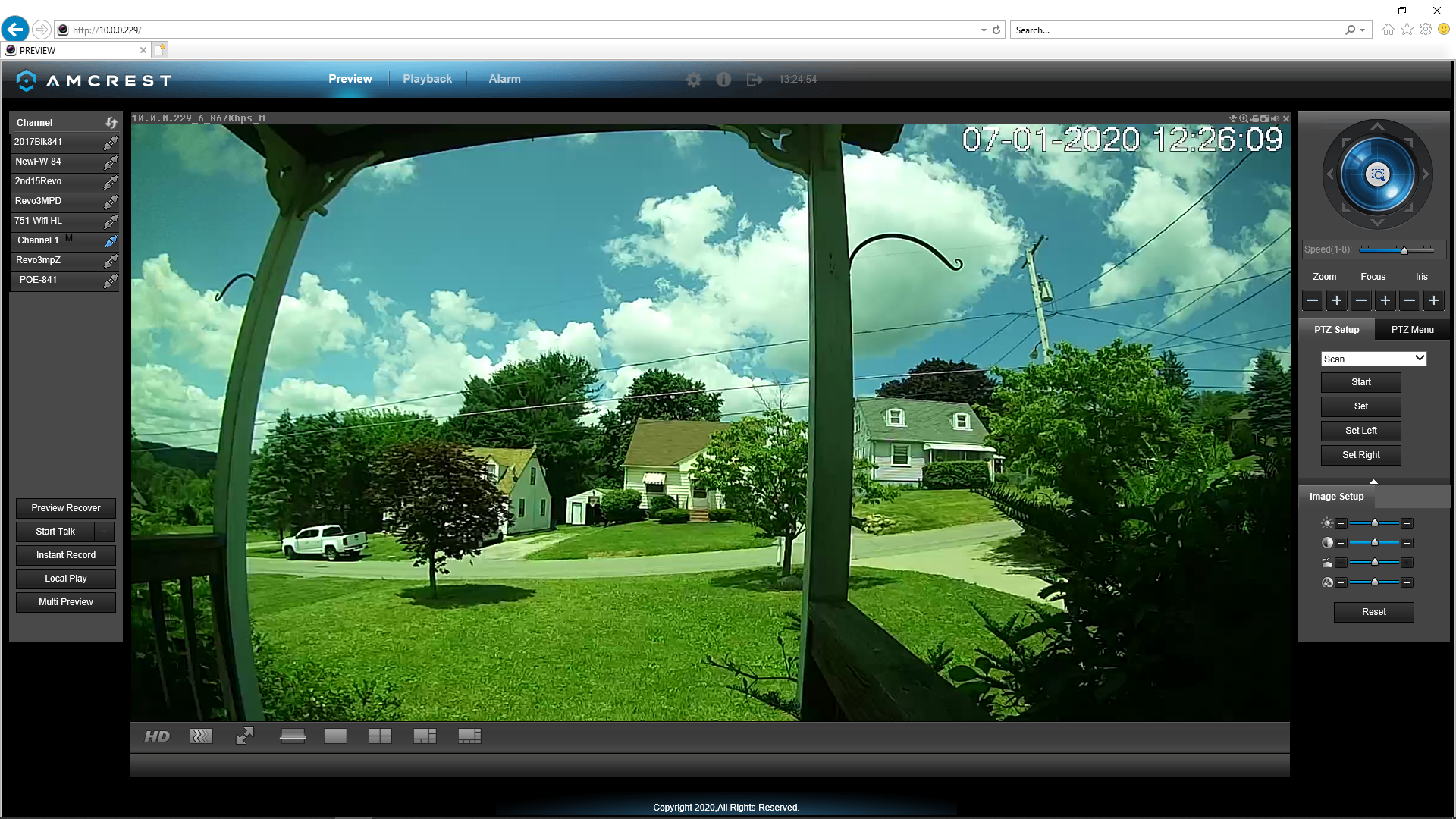

That is just it.. That is why I said something because my Motion was all crazy after the Update as well... Where before I did the FW update it was setup and not many alerts where after update Before reset camera it was going funny for little time.. Plus my NEW HUE Green as another person had said they also had a Green color before it was kind of extra Redish
Screenshot (1627).png (1.97 MiB) Viewed 1029 times
Re: Amcrest Smart Home "Server" down?
Just did another factory Reset and now colors are good again.. Hummm Don't know why or where or how that happen also it was reversed picture and I didn't do that either so Mirrored it and back right again but strange I say
Yes oddly After my Second Reset My Picture is back good Color and Motion alerts are not going crazy and I have not even changed zone yet
Edit: Oddly this time however I did have to Remove it from my App where before I could just pick up off the Hotspot this time I had to Scan it back into app and now working great still have not changed zones and not going crazy
