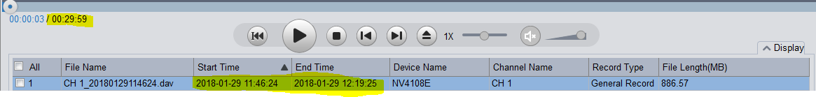

Hello! We have an NV4108E NVR with four cameras, and our system generally appears to be working properly, however we seem to be having a problem in that when we attempt to record a channel locally to a computer, the recording will max out at 30 minutes, regardless of how long we record for. I've recorded for up to two hours just to test this, and though Surveillance Pro indicated that the recording was successful and the metadata of the video seems to indicate the correct length, any attempt to play it back (using the PLAYBACK feature in Surveillance Pro, Smart Play, or even third party video playback software) will only show the first 30 minutes. I'm attaching a screen shot from a shorter video that I recorded just to give you an example.
Although the video is approximately 33 minutes long, only the first 30 minutes are available for playback. I've attempted to reinstall Surveillance Pro several times, tried recording to different directories, tried exporting the videos to different formats, and changed various settings within Surveillance Pro and on the NVR itself, but nothing seems to work. Is this just a limitation of the software, or am I doing something wrong? Any assistance that you could provide would be greatly appreciated!

- Amcrest.png (17.53 KiB) Viewed 3261 times

Sadly I think that is built into the software... The problem is ASP also has PC-NVR that goes with it and it will record for what ever you program it too just like a normal NVR.. With that you get to set up how much space your System can record to.. SO say you have a 500gb HDD on your computer, you can setup 200gb of space as your NVR space.. Then after you setup your system to record you cameras if it fills that space and you have it setup to record over when full it will start over the oldest first....
I am guessing about this.. But I seem to remember reading somewhere that the Local Record is only 30 min no matter what you try per recording.. Maybe a way to keep people using the product the way it was meant to be used or who knows really...
So at this time only Solution is to setup ASP to use the Built in PC-NVR as a longer recording device and leave the local recording for when your watching an event and you want to capture it as it happens and have it at hand without looking for it though recordings....

What you are describing works for me in a test with ASP PC-NVR when set up for continuous recording. Recording is not limited to 30 minutes. Use ASP Playback, search your PC-NVR cam for a <24 hour period. Playback anything in that period. Use scissor icon to select a specific time slice to export a MP4 clip to a folder for use elsewhere.ZenBeck wrote: ↑Wed Jul 01, 2020 6:14 am ...

@jack7 Thanks for Replying, Sadly they are I guess not looking to use the PC-NVR as I had mentioned and I did test out on one of my computers that oddly it does record longer then 30min in size of file when I set to record and came back 2 hours later to the computer. I tried to play it back and would only play back 30min...
I then did it on my other computer where I am recording my ASh21 on the PC-NVR and hit the Record oddly enough was able to play back more then just the 30 min on that computer as you had stated.. I am not sure how to be honest but again I didn't make the software..
So I thought best off would be to have users know that ASP comes with PC-NVR as a feature and to setup full time recording would be best using software that would work even after the ASP is closed.. Also saves HDD space by being able to setup an area that is set only for PC-NVR and will let you over write when full..
