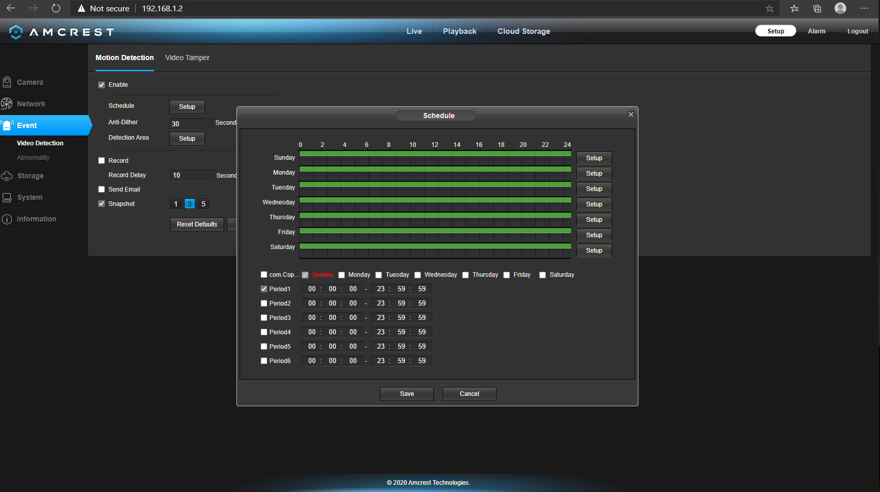

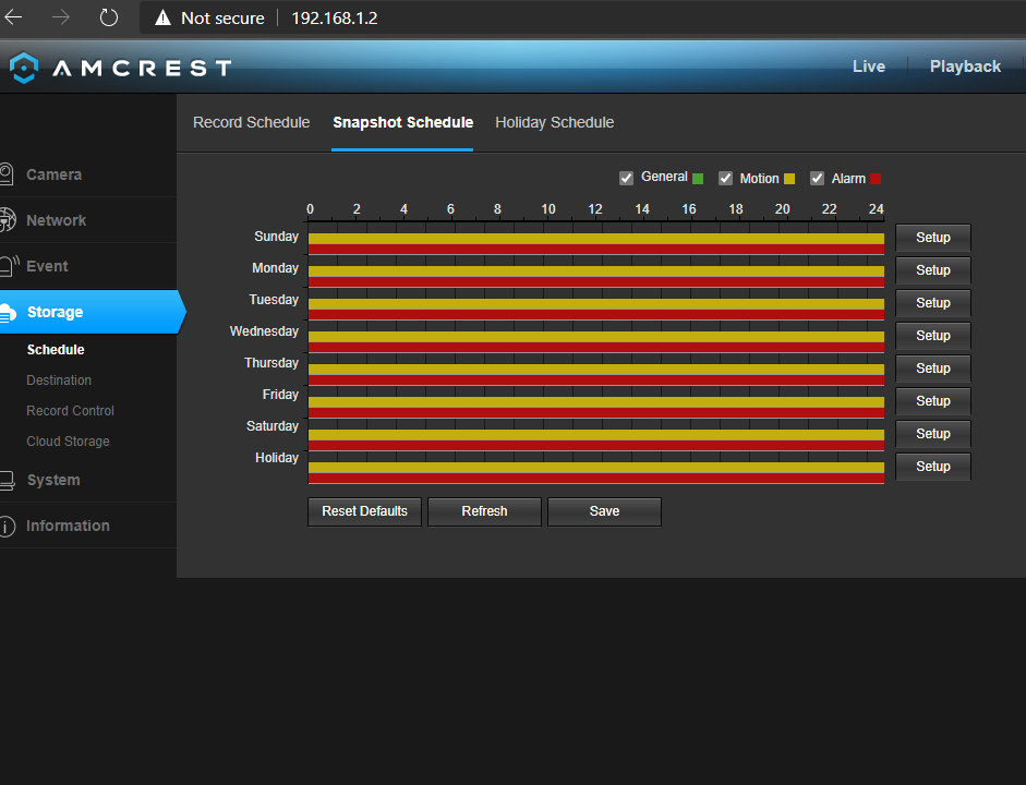

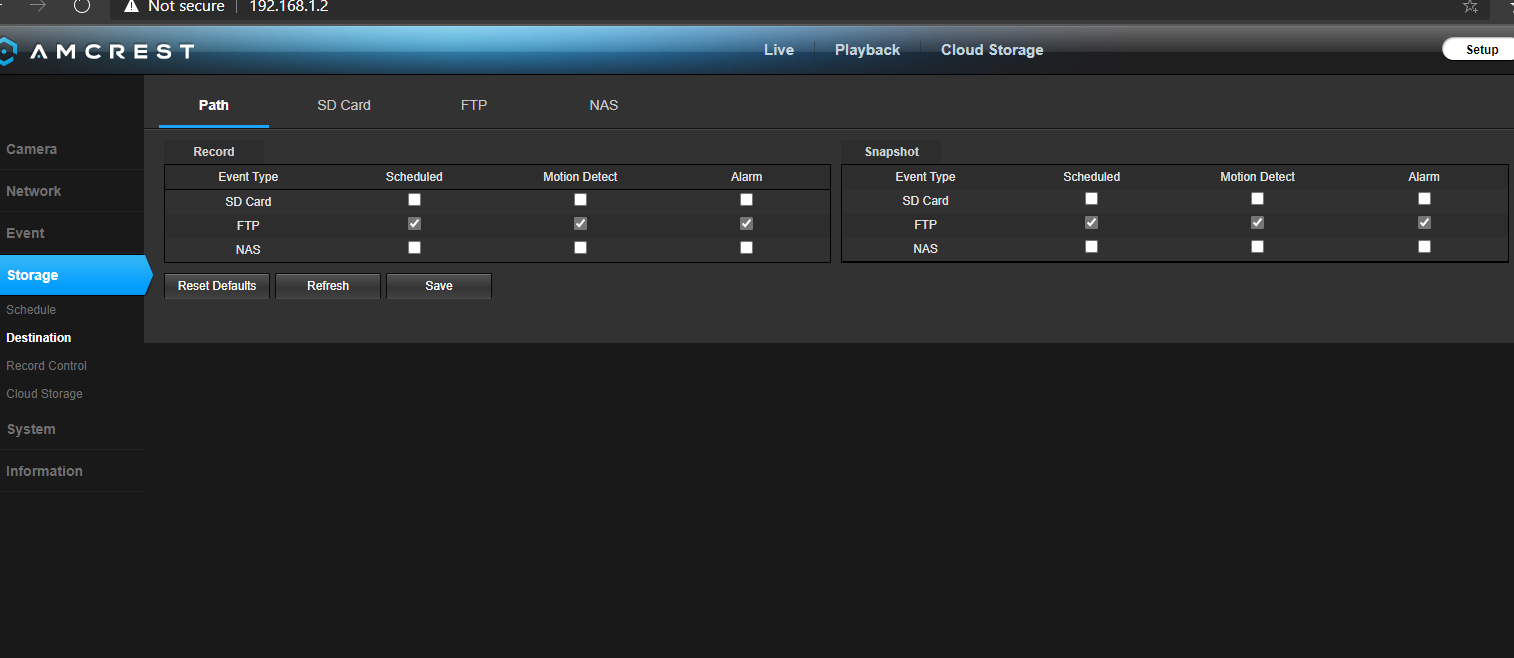

Interesting issue... Can you take a Screenshot of your Schedules for FTP and Motion... You accessing this over WebUI or some other app? Anything outside of Amcrest being used other then FTP?

Thanks for your response.
Nothing crazy in the mix. Just using WebUI for settings. FTP on Win10 PC. I run Amcrest Surveillance Pro just for Live VIew but don't touch any of the settings in that program.
Pics attached.
- Capture3.PNG (64.75 KiB) Viewed 983 times
- Capture2.PNG (67.62 KiB) Viewed 983 times
- Capture1.PNG (131.79 KiB) Viewed 983 times

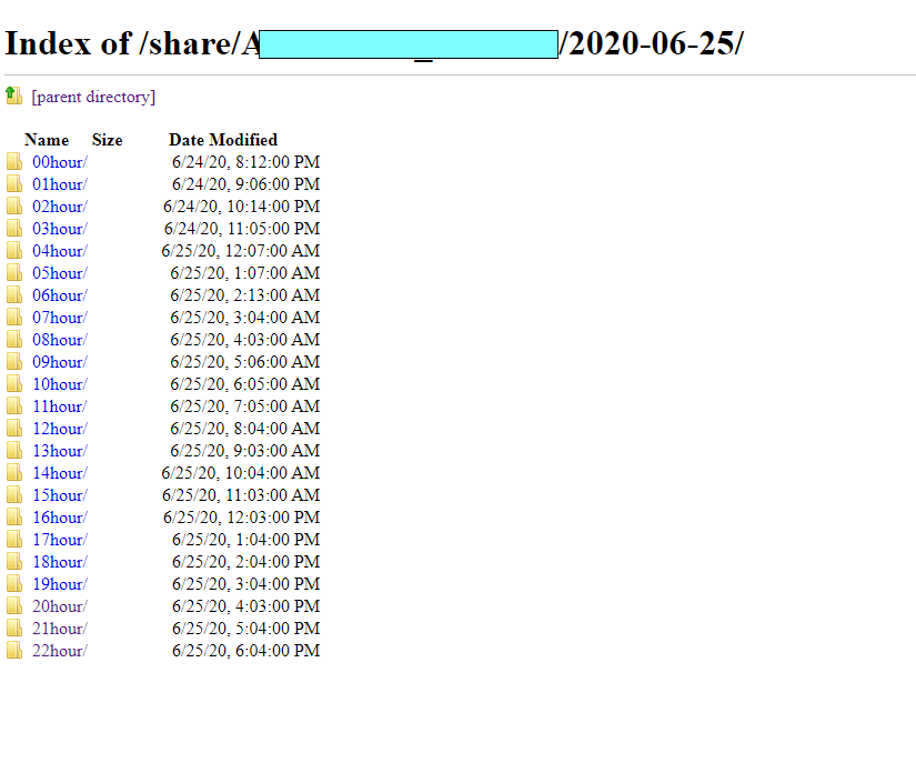

Funny thing is I just looked at my Folders and wow lol... Camera time is set per the NVR and time shows right time but in FTP folders they are off a few hours starting at 8pm I never paid attention to that until now lol... Anyway.. All I care about is the footage being backed up.. I was sending to my Webserver FTP for a little while and it was off by a day so this is better then the whole day... Now I just FTP into my Webserver footage I want to keep longer offsite...
