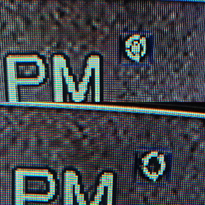

Hummm So there was no little very small 3 arrows that make a circle with a lock in it at the top of the screen on the right? Or is it because your system sets the FULL page to larger then the normal HDMI output so one can't see it or access it and is why the D-Sub connection is needed?
Anyway I setup my system to go into this mode.. I took some pictures had to wait until the screen changed to a color that I could get a good view of it lol.. Top Right Corner of the screen. For what ever reason these 2 pictures were coming in sideways so I made my own image and took the 2 and put in 1 file.. At the top youcan see the Circle with 3 arrows and the lock in side the bottom one is without the Lock. That is what your looking to do to be able to get out of this.. But sounds like your system is the one that one this issue you can't access it without being in D-Sub view on a Computer Monitor...
