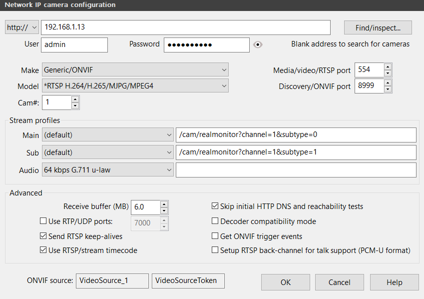

If anyone is looking for AD110 doorbell camera substream access within Blue Iris, this works well.
BI parameters.png (41.25 KiB) Viewed 15245 times
