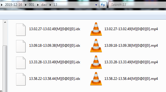

i swapped out the router to a linksys wrt1900acs v1 and ftp videos and snapshots immediately work flawlessly with a usb flash drive.
i'm only using the netgear r6400 v1 as a backup router and this is the only router i have that is still on a factory firmware. i have two other netgear, routers wndr3700v2 and wndr4300sw, and both have been flashed with openwrt and i never had any issue with ftp saving videos and snapshots to a usb flash drive. it appears netgear's factory firmware was the cause of the issue.
