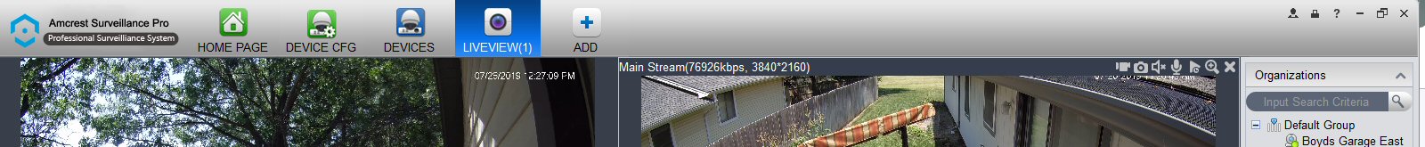

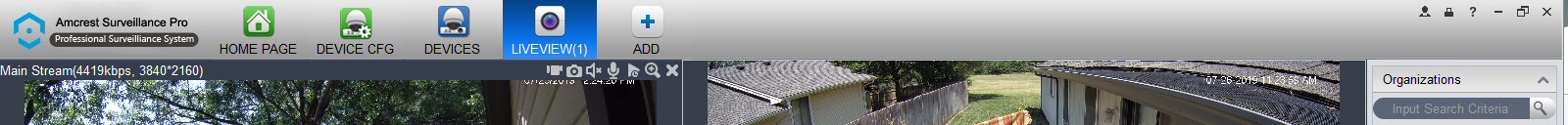

I'm having the same problem. I installed two of the exact same systems at two seperate houses next door to each other. There were both purchased at the same time and installed about 4 months apart. The cameras in both systems are (IP8M-2496EB) and are connected through the amcrest 8 port poe switch.
One system runs fine based on my cbr settings for QFHD at 15 FPS at 4096 Kbps. Those cameras pull about 4000 to 4500 kbps when streaming and the stream looks fine. The stream is smooth.
My second system is setup the same way I think, however all of my cameras pull in from 20,000 to 70,000+ Kbps and stutter / are very choppy with the feed. They are set at the exact same settings as the other system that works fine from what I can tell. All eight of my cameras have this problem. I'm sure I'm missing something, but its ruining my experience.
Normal Functioning Camera:
Normal Camera.jpg (58.15 KiB) Viewed 3015 times
High Bit Rate Camera:
High Bit Rate Camera.jpg (81.64 KiB) Viewed 3015 times

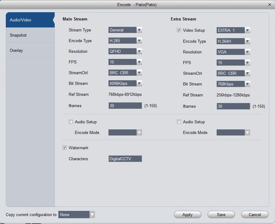

Enode Settings on High Bit Rate Camera:
Encode Settings.JPG (68.14 KiB) Viewed 3015 times

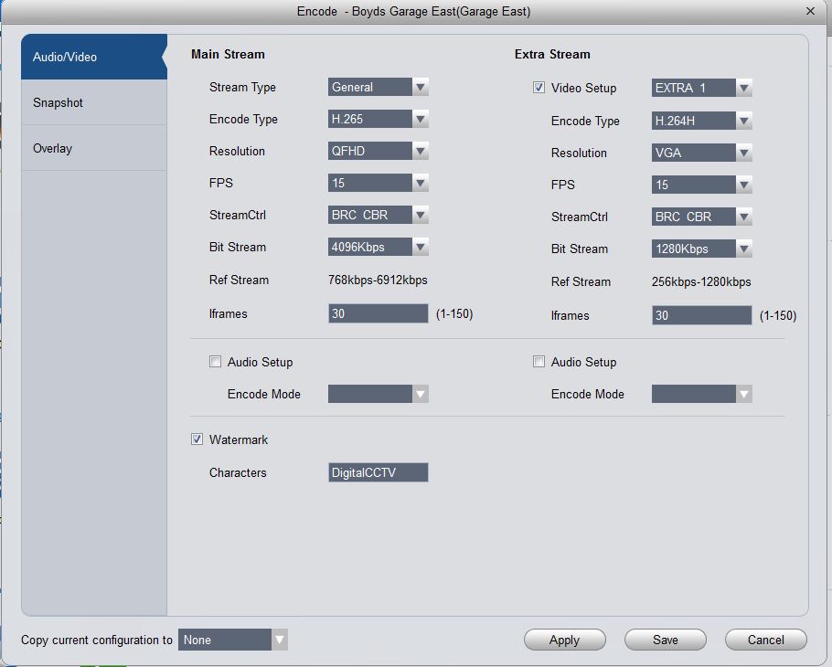

Encode Settings on Normal Camera:
Encode Settings Normal Camera.JPG (71.55 KiB) Viewed 3015 times

@duke69111 the only difference I can see is in the bit rate setting for the extra stream but that apart, would it be possible to exchange the two camera positions to see if the higher bandwidth useage follows the camera. Are they on separate LANs ? If so then an exchange would also be a good pointer as to whether it's the camera or the network conditions.
