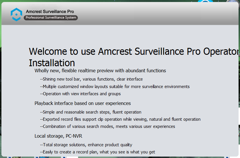

I am new to Amcrest I am trying to install Surveillance Pro but the installation screen is broken, I am not able to see or select the options needed to install the program.
Is there a fix for this problem?
Thank you
Amcrest Surveillance Pro Setup V1.14.1.R.20161018
- Amcrest+Surveillance+Pro+Setup+V1.14.1.R.20161018.jpg (268.21 KiB) Viewed 4122 times

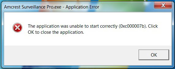

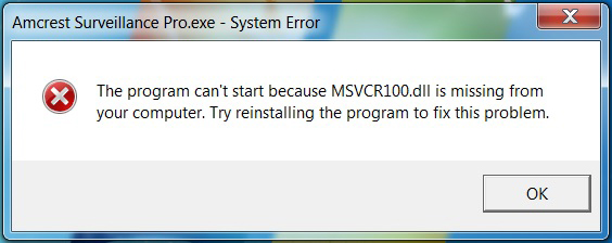

After tapping on the keyboard I finally got ASP to install, now on to the next problem.
When I run ASP I get missing file error MSVCR100.DLL I have reinstalled C++ and tried adding the file manually, I've placing it in C:\Windows\System32 and rebooted with no success. I've tried placing it in the ASP directory manually but now I am getting a Application error. see attachments
Any help getting this program working is appreciated!!!!!!!!!!!
- error.msvcr100.dll.jpg (94.84 KiB) Viewed 4036 times
- app.error.jpg (82.45 KiB) Viewed 4036 times

I figured out I was missing C++ 2010 x86 from my pc, after installing c++ ASP loads up just fine.

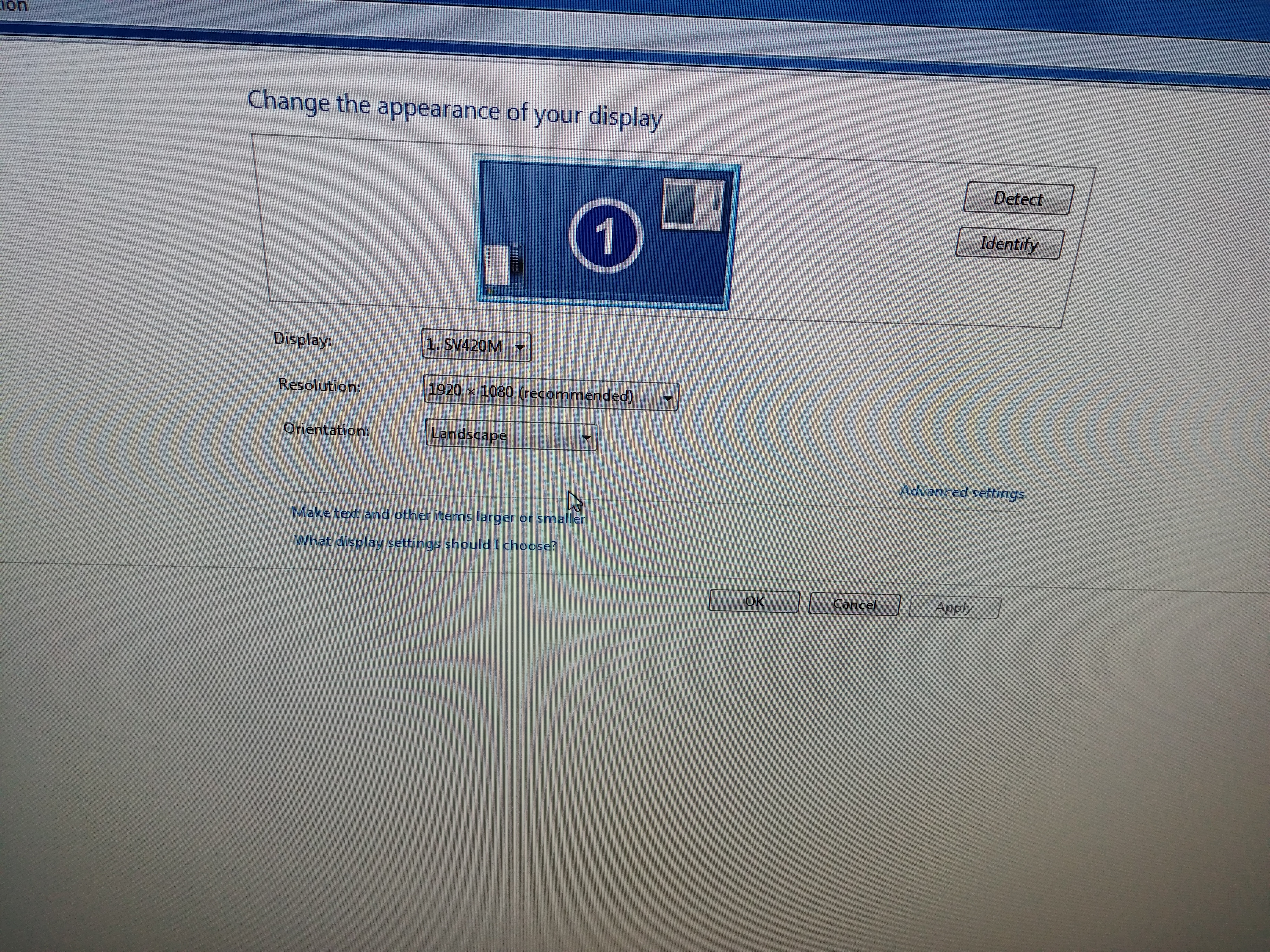

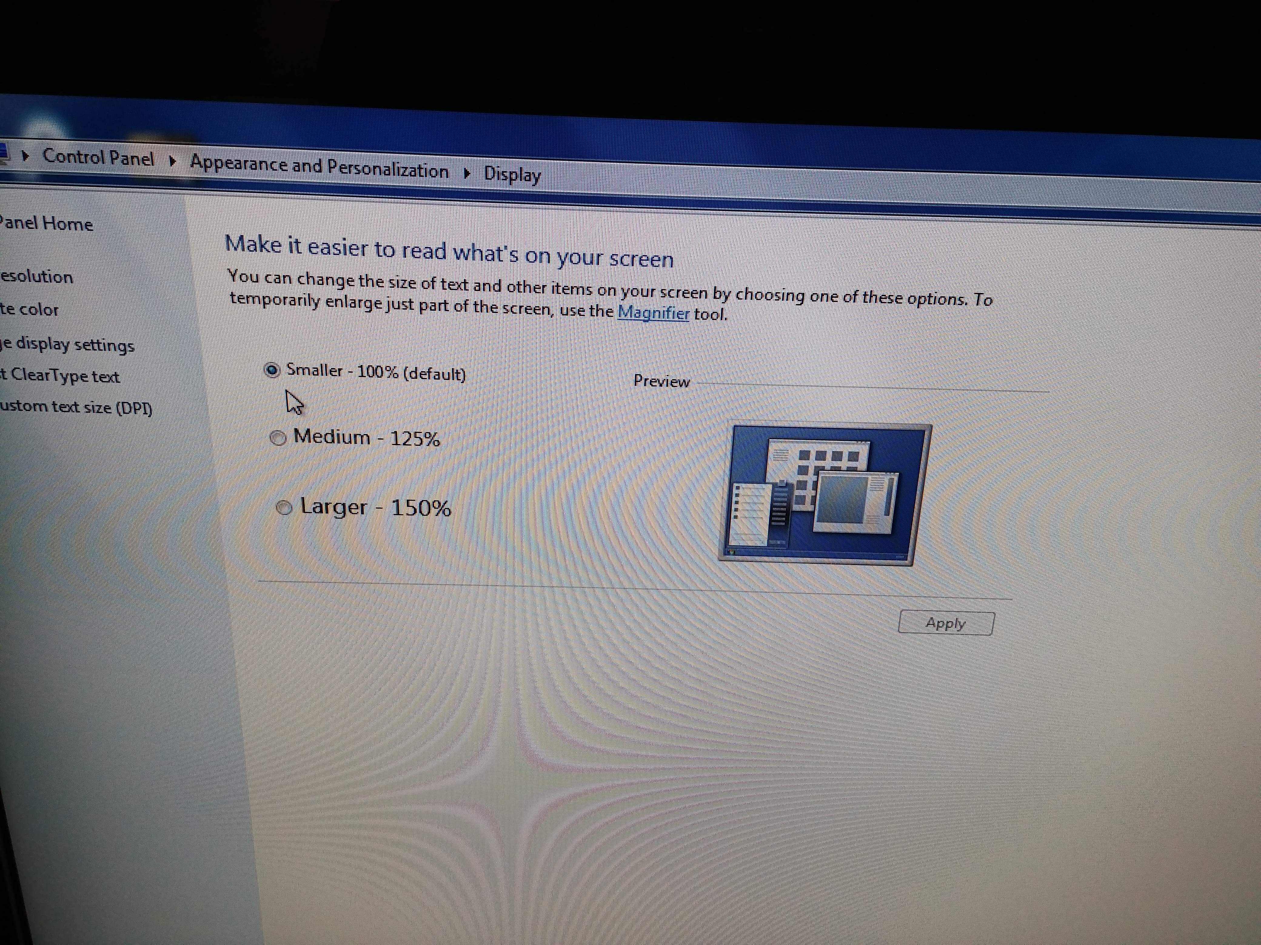

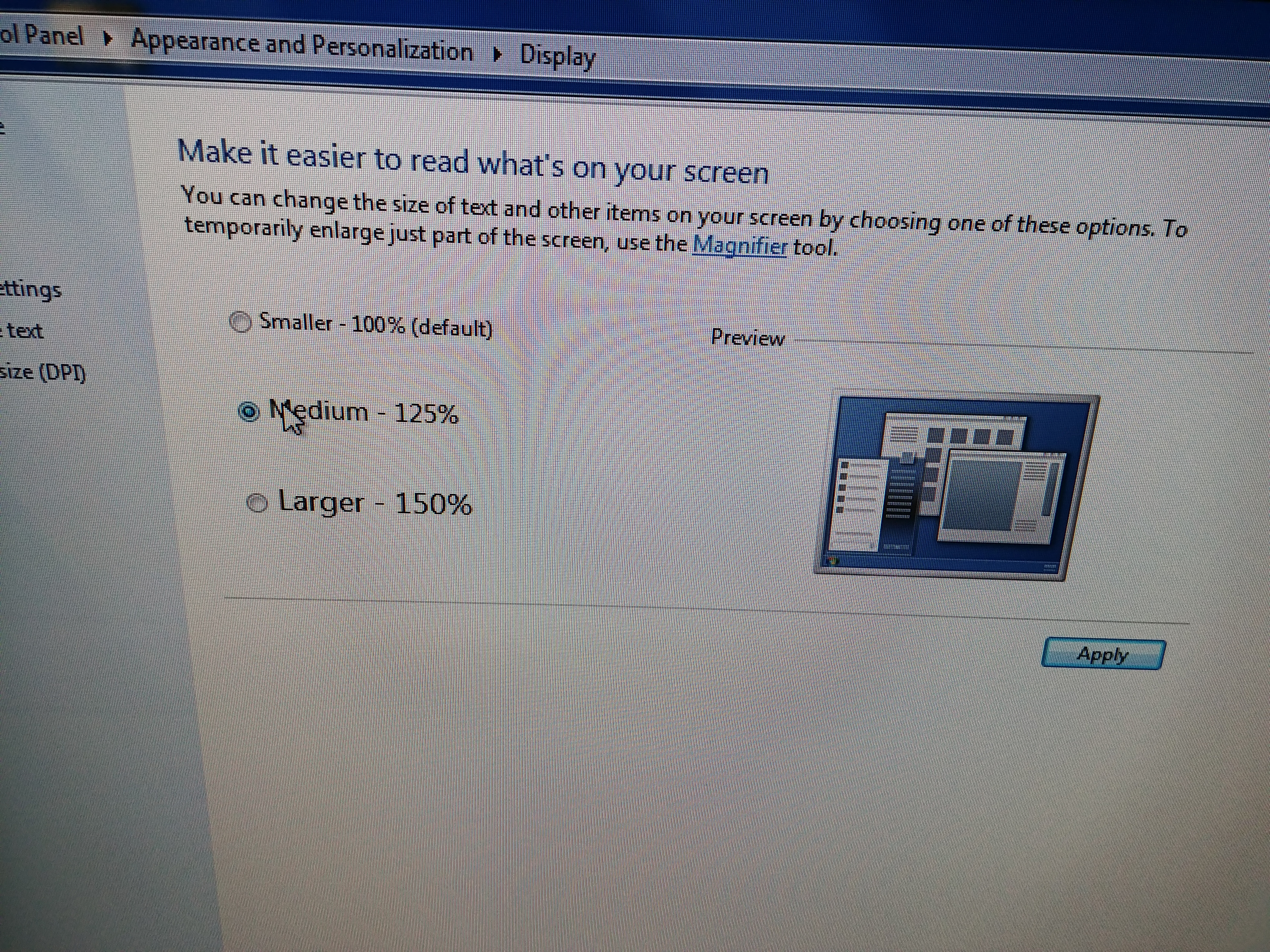

I know this is an old post, but jack7 had the solution. Here's some screenshots to help.
Go to the windows 7 screen resolution. Click Make Text and other items larger or smaller. Change the scaling to 100% default from 125%.
Then click log off and try again.
Mine was set to 125% as I use it on my tv and it make it easier to read when its blown up.
