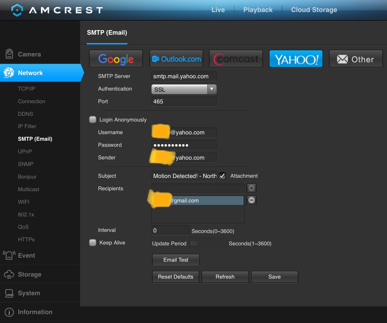

I had the same issue with my Gmail account. I created a Yahoo account with the config below. Also had to hunt for the Yahoo setting, “Allow apps that use less secure sign in“ to make it work. Hope this help...

Bummer.. I have the exact same settings and "Allow apps that use less secure sign-in" on.
It's weird because I'm getting the emails with an image marker but no actual image is attached or downloading. Even when logging into my gmail account to where my yahoo account is sending the notifications no images are present.

I wasn't getting any snapshots either until I saw the post above. On the subject line, I didn't have "Attachment" checked. Once I checked it, now I get the snapshots with my email notification.
