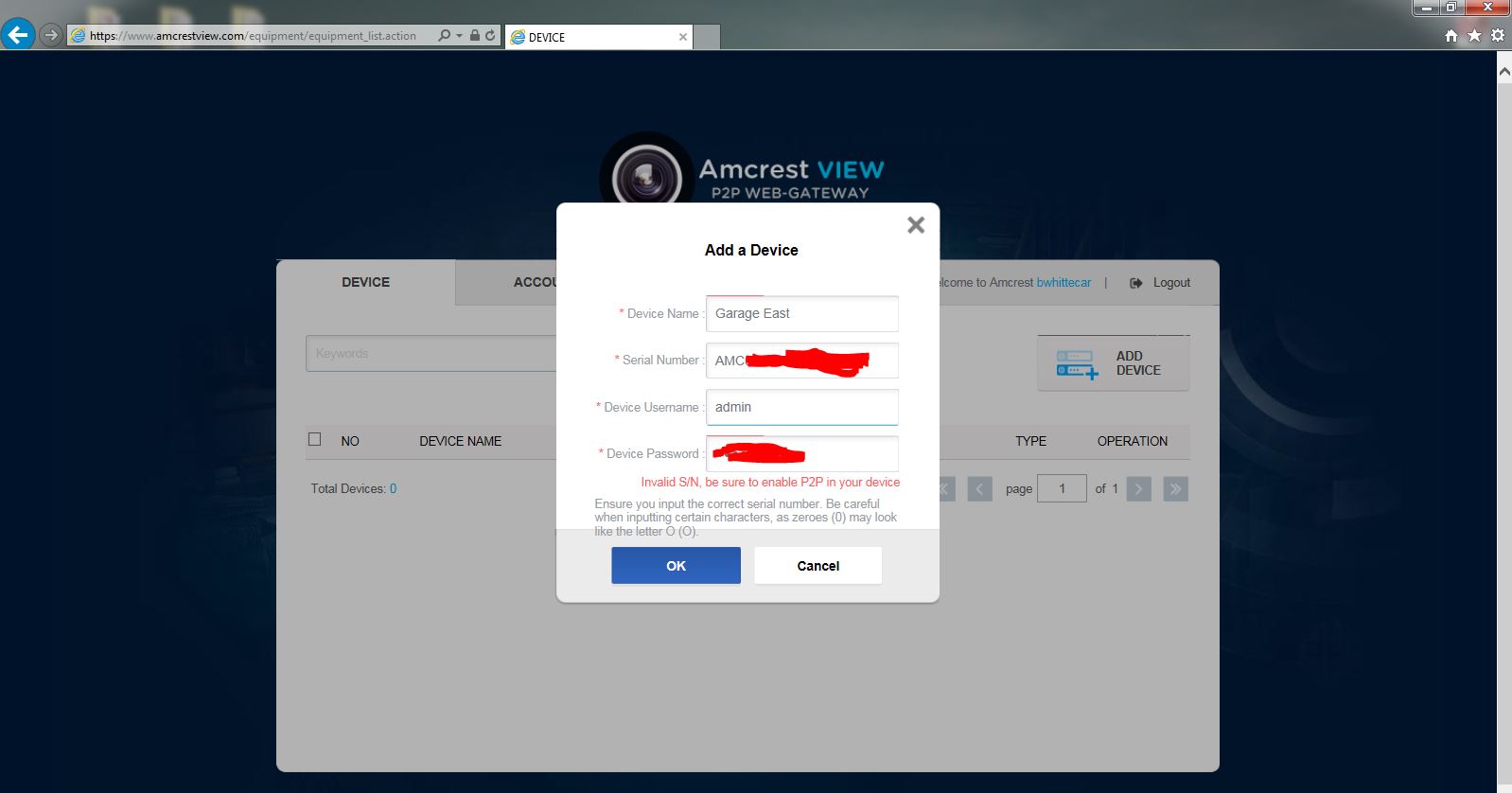

I'm having the same problem. I'm trying to set up a new system right out of the box. I have the camera's connected to the NVR just fine, but I can't get the camera's or the NVR added on two different iphones (an iphone 6 or 6s and an iphone 8). I keep getting messages that it failed to connect. I tried on wifi and cellular. I also tried connecting the camera's by ip address when connected to wifi and that did not work either.
I also tried to add the camera's on amcrestview.com thinking I could import them into the iphone app, but I get an error message there that says "Invalid S/N, be sure to enable P2P in your device". I've checked multiple times and the Serial Number i'm typing is correct and the P2P is working (as I was able to add them that way to my Android phone - See below).

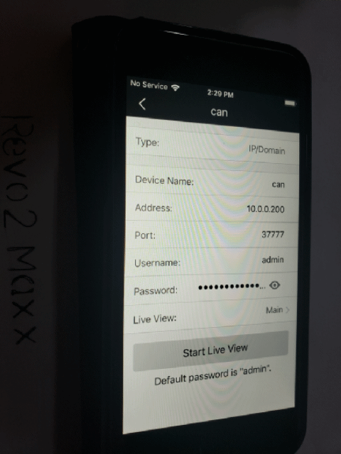

I am not sure I am much help. I am using Version 3.40.0071 Build Date 4-26-2018 on my Iphone without issue!
I did have to set it up Manually in the App.
I don't have phone Service on the phone because I upgraded to a S9 and XR 256gb so I use this iphone for music at the house and looking at the cameras when needed.
For manual Setup
Type IP/Domain
Device Name XYZ
Address 10.0.0.200
Port 37777
Username (Withheld)
Password (Withheld)
Liveview Extra
This is how I have it setup for my Iphone 6 I am also not on the same SSID as my IP camera but I am on the Same Router However I am using the 5G on the phone and normal wifi for the camera not that it matters as the phone connects on both 2.4 and 5G. Also in Liveview I have it set on Extra but I can and also run it under Main so don't feel that would be your problem However once you make that change if you don't press the liveview from below and go back to live view off menu on left side it will not change setting to new it needs to accept it by pressing the view live. Going to try and upload a Gif may not work

James.S wrote:We have seen an increase in P2P issues and from my understanding the engineering team has found the issue while I was off and they just told me the issue should be resolved. Please try the P2P method again. If you are still having issues please let me know so I can alert the team.
Hope all is well!
I am still having trouble. I tried to add the my cameras and nvr again at amcrestview.com and it still says "Invalid S/N, be sure to enable P2P in your device".
Error
Error
Invalid SN.JPG (81.12 KiB) Viewed 4562 times
I will try on the iphone tonight.

Regarding amcrestview.com, that is still not working and shows the same error message as in my screenshot from the previous post.
