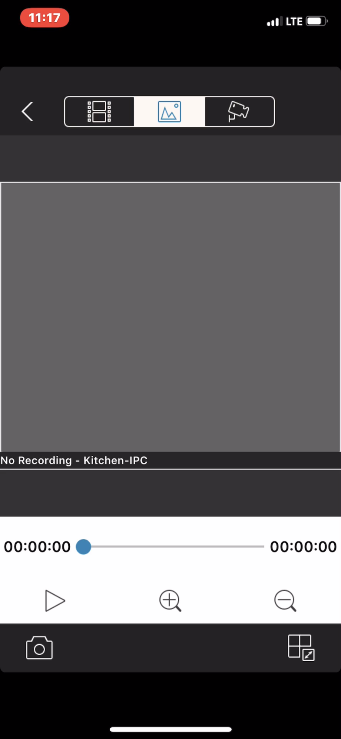

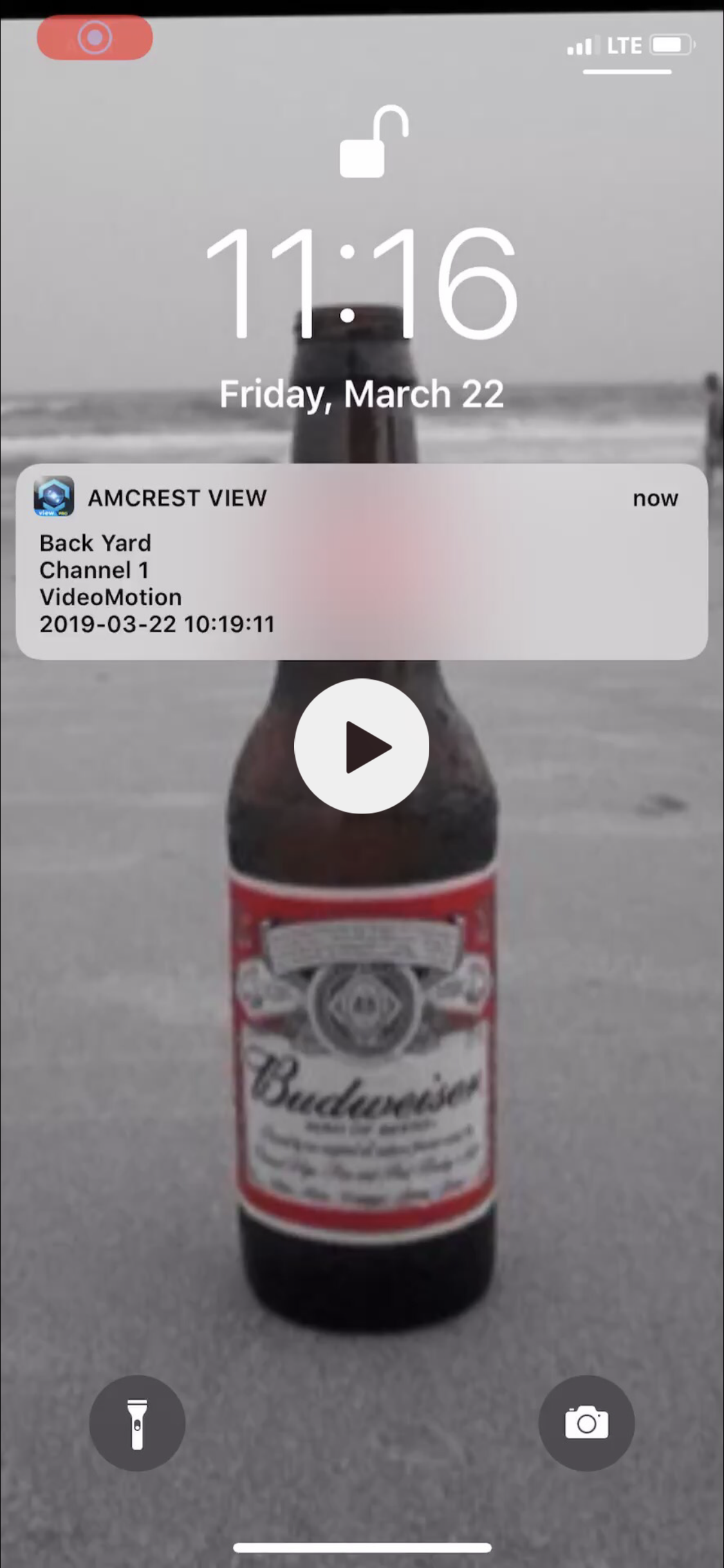

Hi, I have had amcrest cameras for years now and I have not been able to figure this out. I can view the cameras on my phone ( IPhone ) using the app without any issues. I can go back and view past events on the app without any issues. My issue is when I get a notification on my phone of motion or any kind of trigger it notifies me then goes to a screen that says no recording. It doesn't matter which of my 4 cameras triggers either it always goes to the same camera and says no recording. I hit the back button on the top left side of the screen and it goes to the 4 camera split screen and I can go back and see what triggered it if I wanted to. Is there a setting I have to change or is it just a faulty app? Thanks

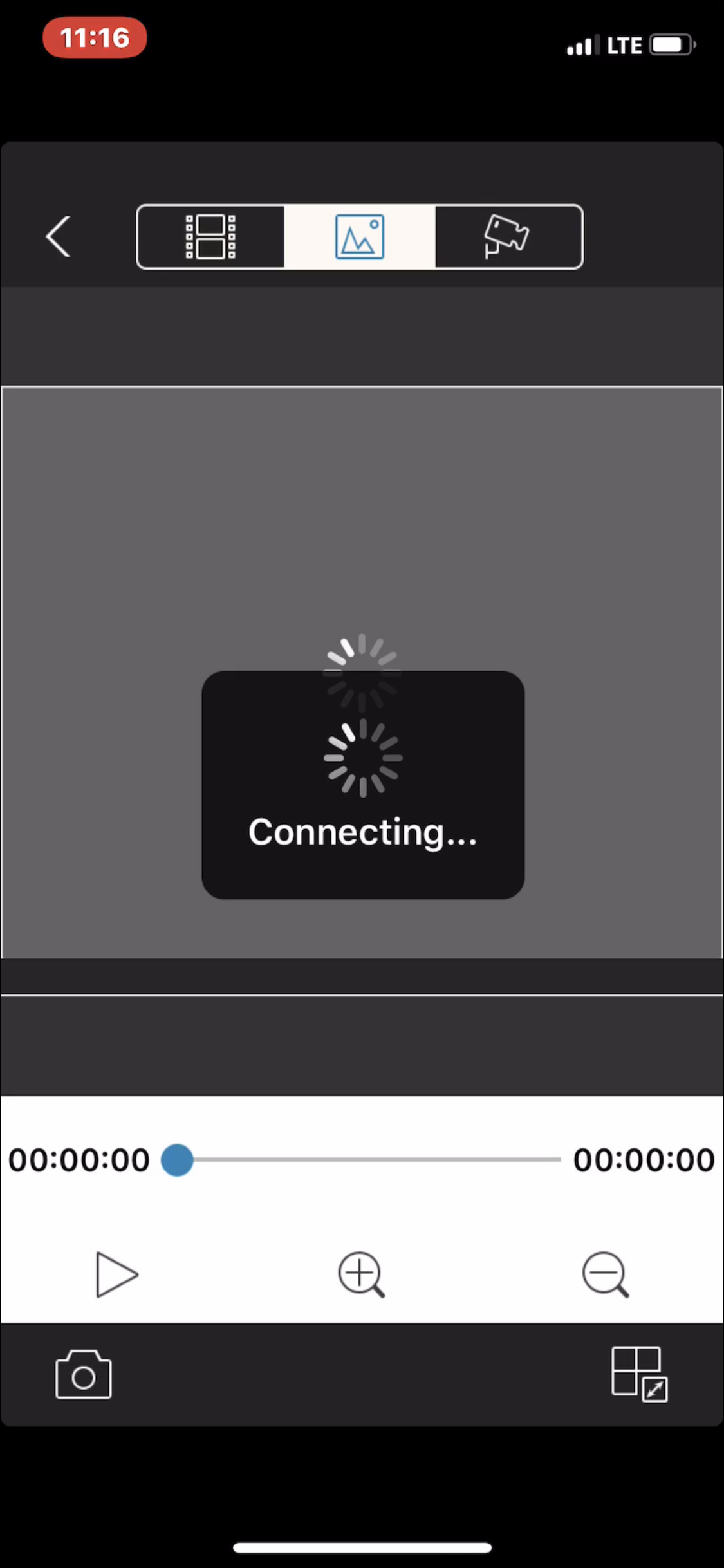

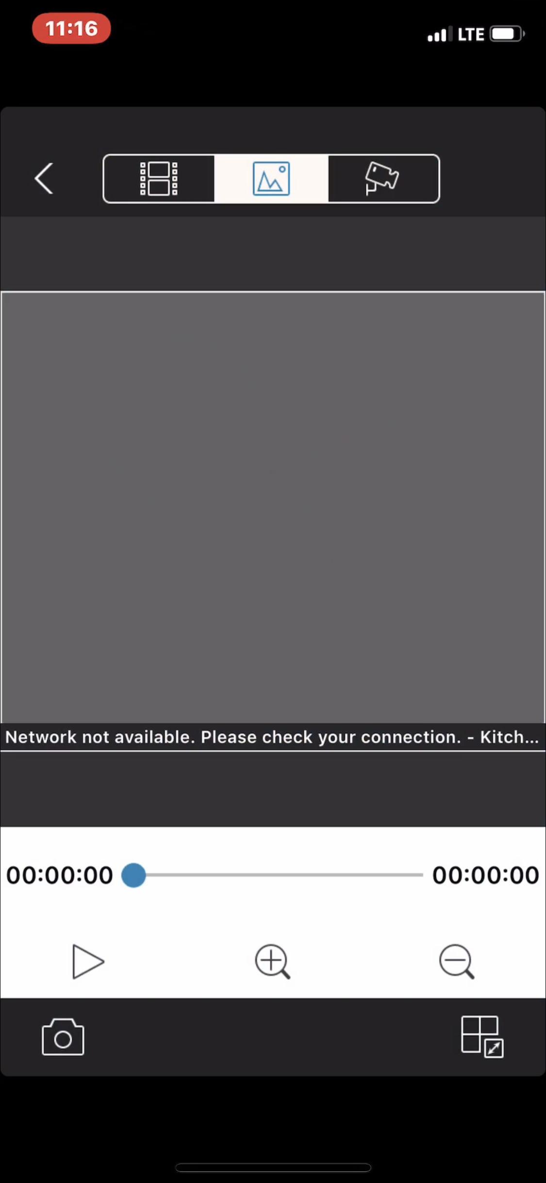

It won’t let me put a video of it doing it so I took screen shots. Hope this helps!
