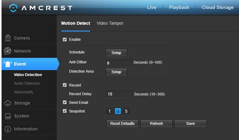

Where is there a "pre record" option in the video settings screen?
a screen shot of video settings.

I have the same question. There is no Pre-record in the NVR config settings. Where is this that everyone is talking about?

It should be under Settings > Storage > Record Control > Pre Event Record.
