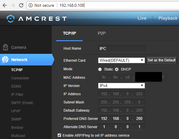

This is what I see from the camera's configuration page when I point a web browser to the unexpected IP address (192.168.0.108):
Amcrest Unexpected IP Address.png (48.64 KiB) Viewed 8732 times

I have a new Amcrest system that I've been using over the last few weeks. I'm not sure this will help you, but I've made some observations related to IP addresses with my system.
I noticed with my Wifi cameras, even with Wifi disabled and the camera hard wired with Cat5 cable, I can still access the cameras via both the Wifi IP address and the Wired address from a browser on the LAN. Disabling Wifi seems to stop the camera from searching for a Wifi access point, but does not disable the Wifi IP address.
On the Network Settings, TCP/IP page for your camera, use the pull down menu next to Ethernet Card to check the Wifi Settings and see if it's set for Static or DHCP, and which IP address is assigned. Does that shed any light on your situation?

I had the same issue as yours but with an IP3M-956W camera. Your screenshot was exactly what my camera showed. I couldn't get any static IP to stick. My router would recognize the camera's mac address, but not the ip address. The only trick that worked was turning dhcp on the camera and making my dlink dir-868L router kick out the same IP address every time the camera rebooted.

If you discover the camera by SNMP it has a 2nd network interface assigned to 192.168.0.108
