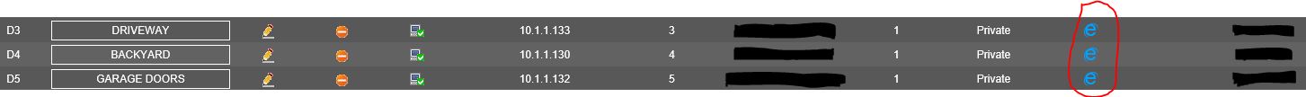

I ran into the same issue with the NV4108E. I needed to access the Web interface of the PoE cameras. They are located on a different subnet (10.1.1.x). However, it was an easy fix. I was using Chrome to access the NVR. When you go to the "REMOTE DEVICE" list to view the list of cameras, the cameras will have the IE icon link under the browser column. That link doesn't work in Chrome. However, if you use "Internet Explorer" to access the NVR, the links will work and allow you to open the web interface of all the cameras (WiFi, Wired Ethernet, and PoE).
The URL of the PoE cameras are:
http://"IP-of-NVR":10080, http://"IP-of-NVR":10081, http://"IP-of-NVR":10082, etc....

Re: Access Cameras behind NVR
Not to sound funny, but I hope you're typing the IP address of the NVR without the quotes.
In my case it's http://192.168.22.51:10080 for the 1st camera since the IP of my NVR is 192.168.22.51.
Also, what happens when you click on the IE icon while logged into the NVR interface with Internet Explorer?
