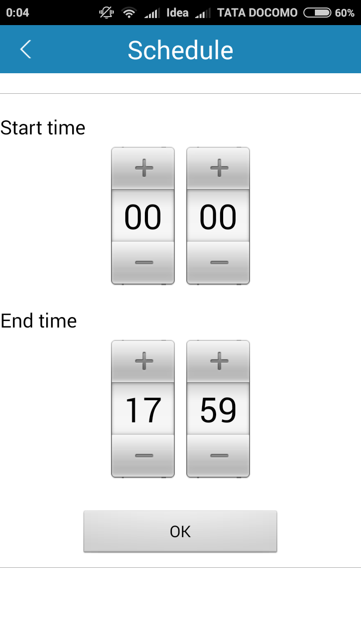

Ip3m 943
iOS app
When I try to setup a schedule, let's say from 9:30pm - 6:59 am I cannot set the times in the one of 6 available scheduling things
It only lets me input one time to start and never prompts me for the end time. I know I need to do 9:30 to 11:59:59 in one setting and then 12:00:00 to 6:30 am in another but it just doesn't happen.
All I want to do is record everything from 9:30 PM to 6:30 am every night in addition to regular motion triggered recording during the day.
Help?

If you want the camera to record continuously from 9:30pm - 6:59 am, you can go to configuration center and then select 'Recording Schedule'. Then click on edit schedule and it should let choose the start and end time as in the image attached. Check the button 'Normal' for regular recording.
If you set the schedule under Motion detection its only the schedule for motion detection recording.
