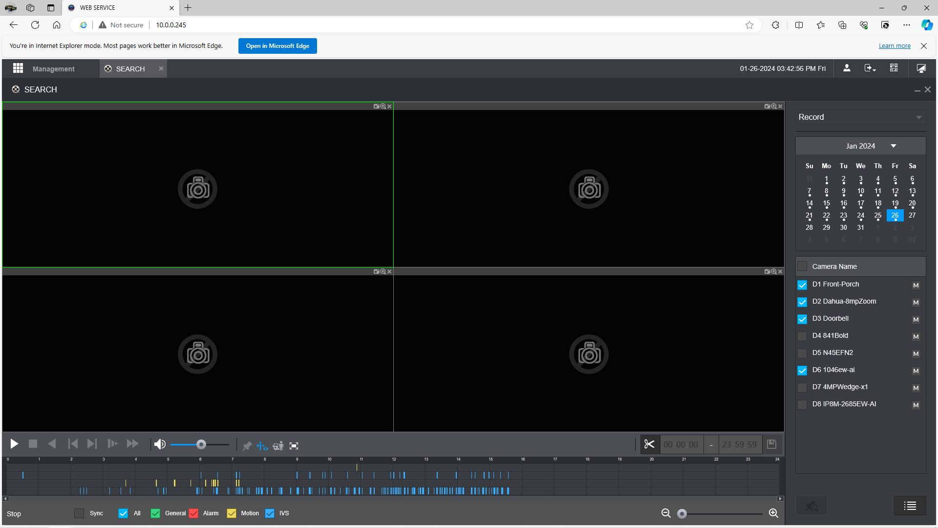

Sorry little confused. So your title says it isn't recording yet your post says that it recorded but isn't playing back? Sorry not sure I under stand? Here is a picture of my 4108-A2 with 4 of the connected cameras. Can you post a picture like this so I can see what is going on to that point?

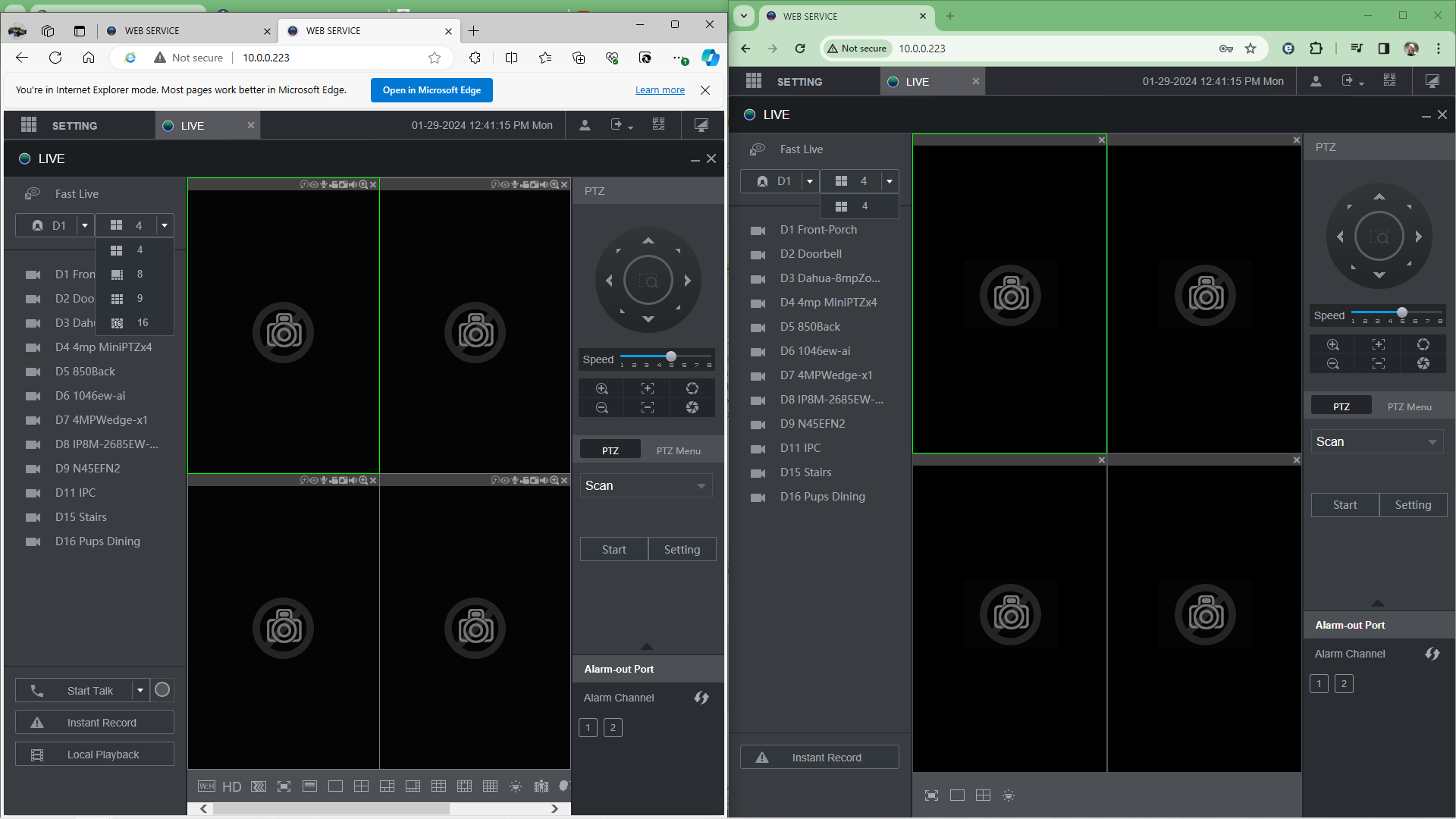

I know at times it is hard to use other things then what we normally do or want to. However as much as I love Chrome, I use Edge in IE mode for access to DVR/NVR and IP cameras that support WebUI.. I personally would use that as there is much better format for the cameras and work much better then Chrome normal or Edge Normal ever could. While MS says things and then change their mind they have said that they will support the use of IE mode until 2029. So if that is the case by then I am sure updates to Chrome and Edge normal will have better format use in my devices however for now IE mode is best to use.. If you think about it look at these pictures below to just give an idea.. a 16ch NVR in Chrome and Edge normal we are limited to 4 playback or even view windows playback might be more but live view only 4 is the option in Edge normal and chrome yet if you look at the IE mode you can see I can load them all and it works well.. It was easier and smaller image to just do them side by side.. You can see in the 1 left side in the drop down IE mode I can live view all channels.. On the right side in Chrome only option is 4 and or 1 but for grid multi view only option is 4
Screenshot (1256).png (170.43 KiB) Viewed 1196 times
