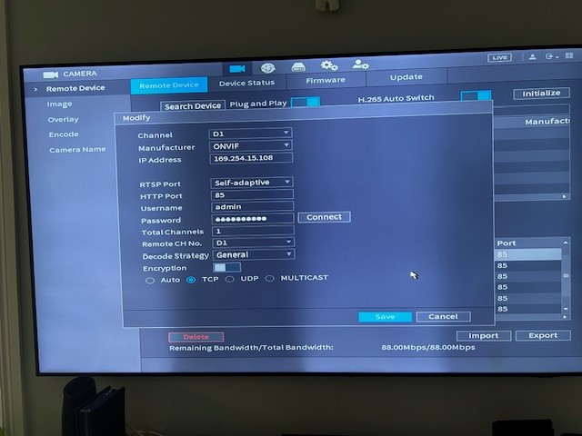

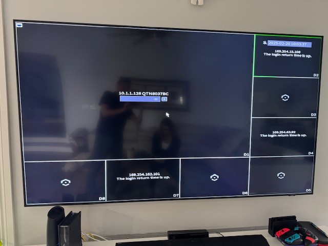

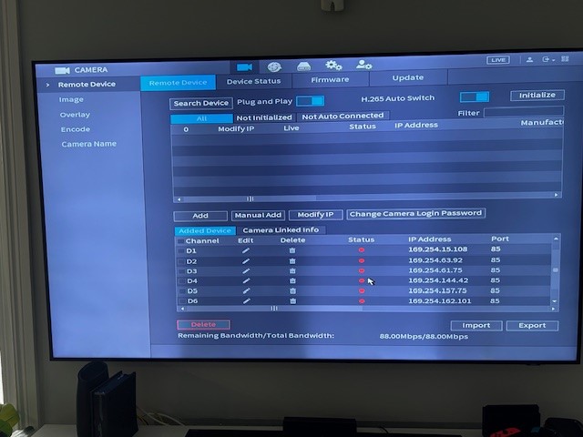

This is what I see if it helps
camera 2.jpg (62.05 KiB) Viewed 3823 times
camera one.jpg (57.23 KiB) Viewed 3823 times

I get this screen to come up but no camera
Re: Help with QSee cameras connected to NV4108E-2TB
Ok not knowing the password will be an issue, will need to find out if the camera has default info in use, like admin admin for user and pass, then could be anything, next will need to find out if they have reset button on wite cluster or inside camera, then another issue and 1 that can stop access in ip range. NVR switch for camera would be 10.1.1.xx normally so without being in right range. So will need to connect to camera with pass around cable from port on nvr to your router or switch/gub and connect using right ip range and so on. But sounds like camera will need to be reset back to factory with reset switch.
