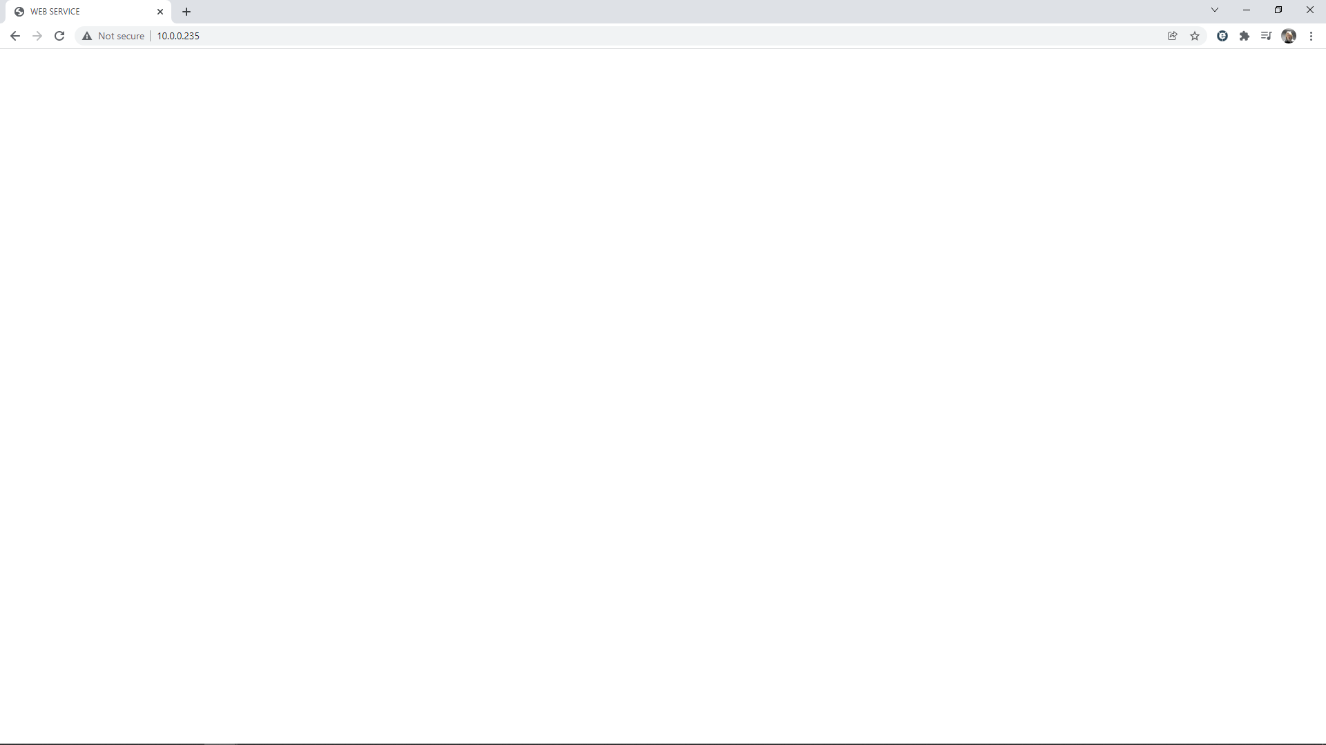

did some testing on all my cameras and only ones I can get a white screen on is the AD410, All other devices without a WebUI have some type of error. It is really kind of odd in my mind that my AD410 gives me a Blank White page and says Not Secure.. I mean that is because it isn't HTTPS but still it acts like it wants to connect that is why it is odd...
Screenshot (1705).png (21.3 KiB) Viewed 1236 times

Revo2Maxx wrote: ↑Mon Dec 27, 2021 1:35 am did some testing on all my cameras and only ones I can get a white screen on is the AD410, All other devices without a WebUI have some type of error. It is really kind of odd in my mind that my AD410 gives me a Blank White page and says Not Secure.. I mean that is because it isn't HTTPS but still it acts like it wants to connect that is why it is odd...
Again thanks for verifying issue on your side... I see same white page for both of my cameras. I think that message you see about site being not secure if Firefox's way to tell you that you are not using HTTPS connection.

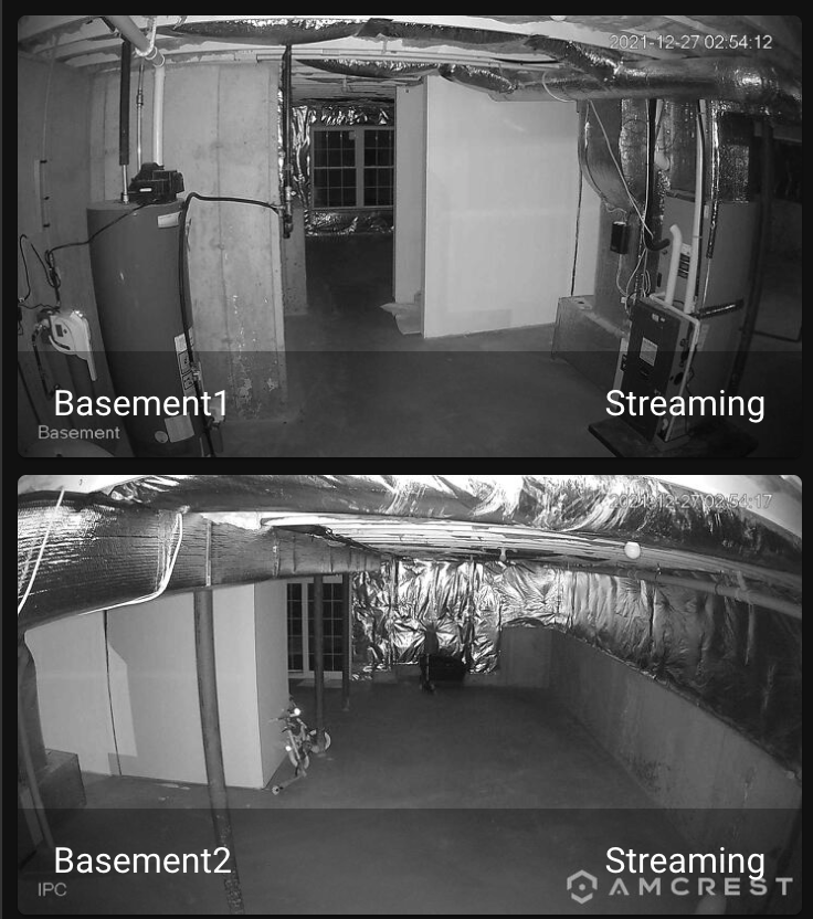

I see both cameras streaming in my HA dashboard... so I know cameras are fine and they are functioning properly.
Screen Shot 2021-12-27 at 2.54.26 AM.png (609.1 KiB) Viewed 1235 times
