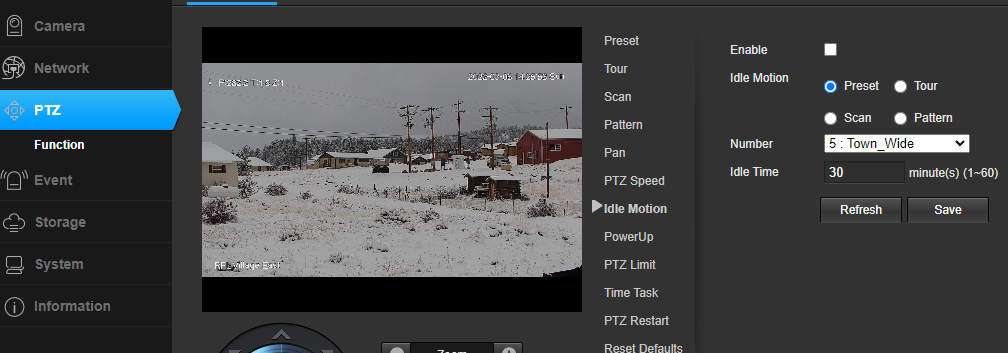

I've been using a PTZ camera (IP2M-863EW-AI) for close to a year now. And its great. It has a configuration feature in it called IdleMotion. Where it lets you tell it what to do when the camera sites idle for some amount of time. Very handy for letting people PTZ around and then coming back to the default area you want to record. See picture for config screenshot.
Now I also have a IP4M-1041B (indoor PT) and a IP5M-1190W (outdoor PT). Both great little devices. But they lack the IdleMotion feature in their Setup pages for me to tell them to return to a certain position after a period of idle (non-use).
Is there some way to get that menu/config enabled in the existing firmware or a future one?

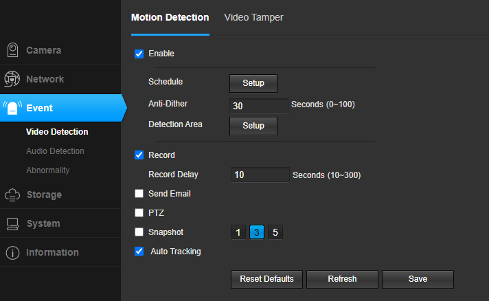

And while I'm talking about lack of universal features, Is there any way to get the Autotracking of the IP4M-1041B included in other PT/PTZ camera? It is a longed after feather in both the IP2M-863EW-AI and IP5M-1190W mentioned above.

I do recognize the cost and performance differences. A return-to-home is pretty low key... no processing, just a schedule to automate to movement the same way that I would move it manually by clicking on a pre-set. One shouldn't have to read up and learn how to make API calls to automate that. Hopefully my comments will help someone else searching for the same result.
I find it impressive that such a low end device (IP4M-1041B) can do the auto tracking. To me it seems like if the lower end hardware can do it, then the either of the other mentioned higher end hardware should do it.
It's just inconsistent in ways that I can't make sense of.
That aside, I still would like very much if the configuration pages had the same templates/screens. And just disable the buttons that it can't do - perhaps with a mouse over saying its not supported on this model. I find myself going through every menu on the camera trying to find features that I would expect to be there. I'm sure that makes supporting the cameras more difficult too.

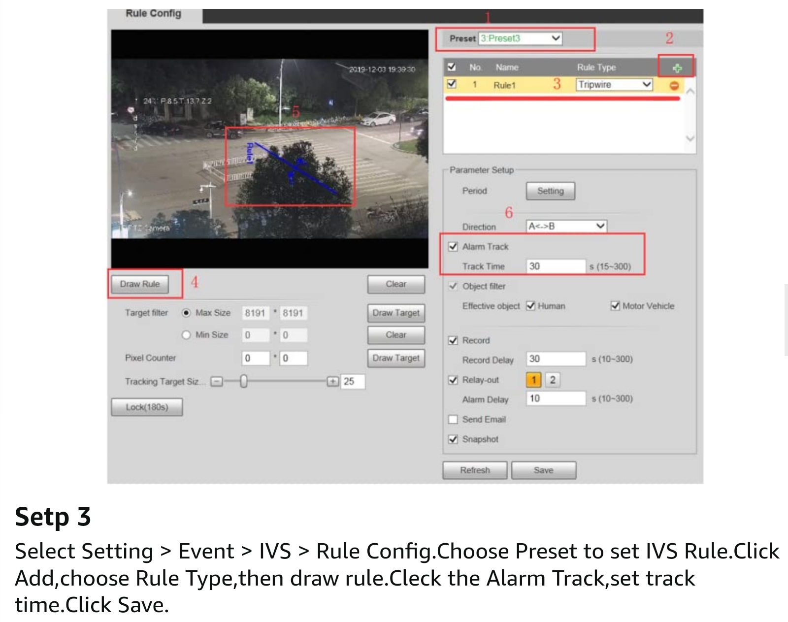

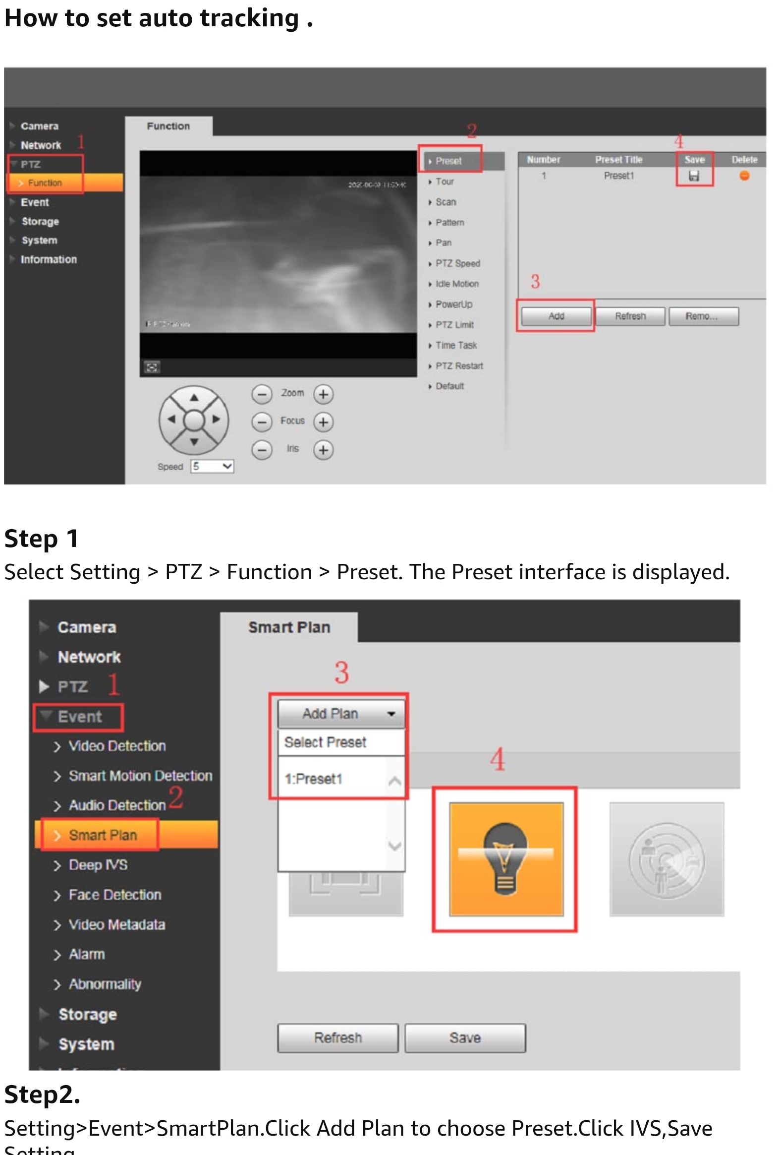

Autotracking firmware does exist for large PTZ cameras like IP2M-863EW-AI. See pics for how it would be set up. It also zooms in on tracked object. When it is available for a particular camera depends on Amcrest and Dahua marketing decisions.

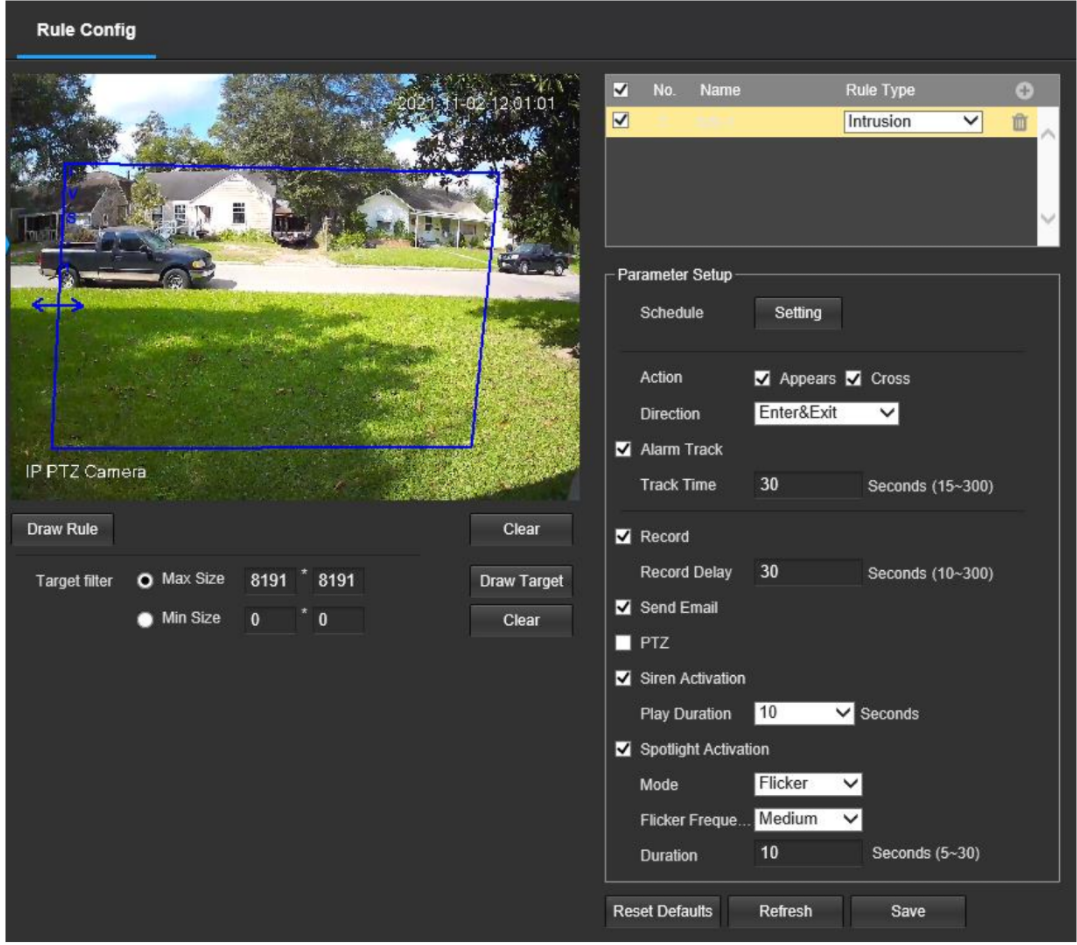

Have a lot of things I have going on. However I happen to just look over the Manual for the 1190W and it does offer Motion tracking..
So setting up IVS rules, you can on a Tripwire or Intrusion do the same as the camera that cost almost a grand and setup Alarm Track, By clicking that and setting the time you want it to track it will track the item for a set time. Then after that it returns to last position for that preset IVS rule..
Geez I have been looking at that too, Almost bought it last month however had some things happen that cost more cash then I wanted to spend. This month Not a good one for me to buy things my Wifes BD is in March and me buying something for myself would be bad lol.. Next month hope it isn't going up in price more the price it is at now and maybe I will have to buy it just so I can have a new toy as it kind of odd looking in pictures maybe in real life I will change my mind about being a toy..
So it seems it can do it just have to use it in IVS setup. I notice there is another one that looks like it in Smart Home Family (I am not buying anymore SH products have to many now) Just saying..
Picture from Amcrest Manual

@Revo2Maxx
You asked me in an earlier post what camera went with the pics I posted.
OK, I was not going to mention specific other brand products here but those pics are from the link below. The Loryta is a no-logo Dahua model that comes with previous version autotrack Dahua firmware and costs $399. The current Dahua firmware for it is is not autotrack. There's also a 4MP model for $40 more. These cams are quite popular at IP cam talk. They are what I would buy if I wanted 25X auto track
https://www.amazon.com/Loryta-SD49225XA ... ms&sr=1-14
The reason I posted was to tell OP that products like his PTZ camera do have autotrack and it's up to manufacturers/vendors to decide what they can and want to sell.
Regarding IP5M-1190W in your other post, I would guess it has IVS autotrack because it has no zoom and does not really compete with higher cost PTZ cams. Here's another cam somewhat like it that has zoom and no IVS autotrack.
https://www.amazon.com/Loryta-SD29204UE ... ms&sr=1-50
