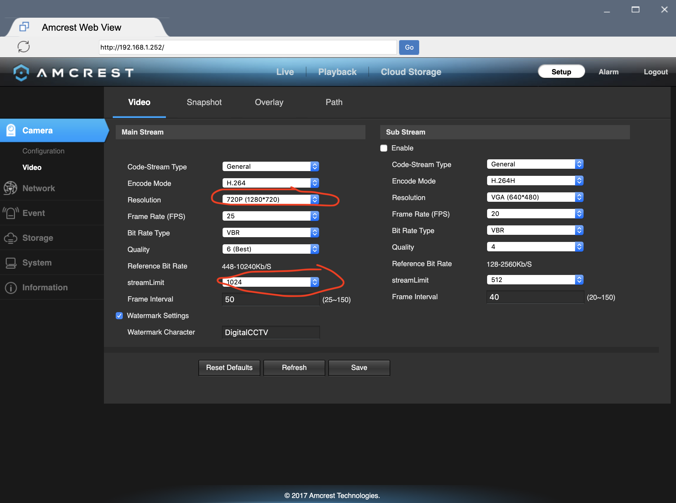

One of my Amcrest IP3m-943W cameras keep changing resolution from 2304x1296 to 1280x720. I've tried setting the frame rate lower and bit rate max higher, but it keeps doing it every few days. I've tried power cycling it and recently tried importing the configuration from another camera but the problem persists.
I've already got it set to a fixed IP and signal strength isn't an issue. It's changing the setting inside the admin settings page, it's not a temporary adjustment with the fluctuation in available bandwidth.
The resolution being broadcasted over my network via the camera's static IP address is what is changing. I'm viewing it on third party IP camera software and that's when I first notice it has been lowered. Then I go into the Amcrest Web View chrome extension and log into the camera, and that's where I see the setting has been lowered to 1280.
Any suggestions?
Thanks in advance!

Yea it's the main stream setting that is being changed (sub stream isn't even enabled). I just noticed the streamLimit is also being changed from 10240 to 4096.
I just cleared the logs and tweaked the settings back and forth to set the start point (it's time stamped regardless). It should mess up in the next 24 hours, so I'll report back what I find at that time. I'm guessing it'll show system/admin changed it, but I've got 4 cams and this is the only one having the problem, so I doubt it's my SecuritySpy software causing it, but who knows.
Thank you all for your active responses thus far. Amcrest tapped out last night and literally said: "As for the resolution thing other that what we discussed I am lost for any other reason why." - many thanks "Escalation Team Member!"
Will report back once it switches again. Feel free to leave any additional tips in the meantime if you have them. Thank you all.
Pic attached below.
Pic attached below.

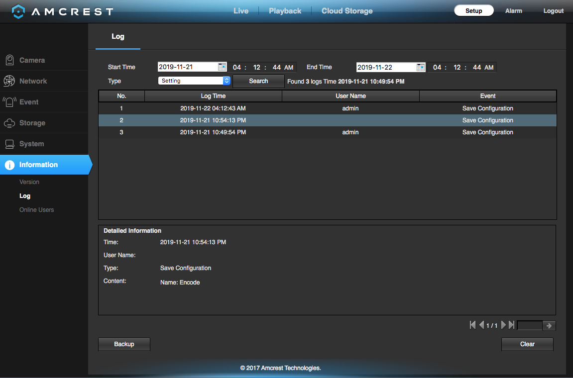

Here is my log showing my system changing just a few minutes after I set it at 10:49 last night, and then me switching it back at 4:12 this morning. I continue to believe this isn't setup with Amcrest Cloud, but the lack of "admin" in this screenshot suggest it somehow is, correct? Any other options?

That's very strange. I haven't seen a log entry like that before where the user name is blank. If it was something happening at system level I would expect "System" to be shown.
What frame rate (for instance) did you set before it got changed back? I would try improving the settings a little at a time and see if there's a point at which this happens again.
