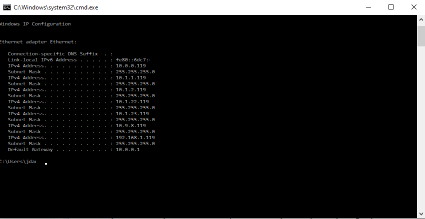

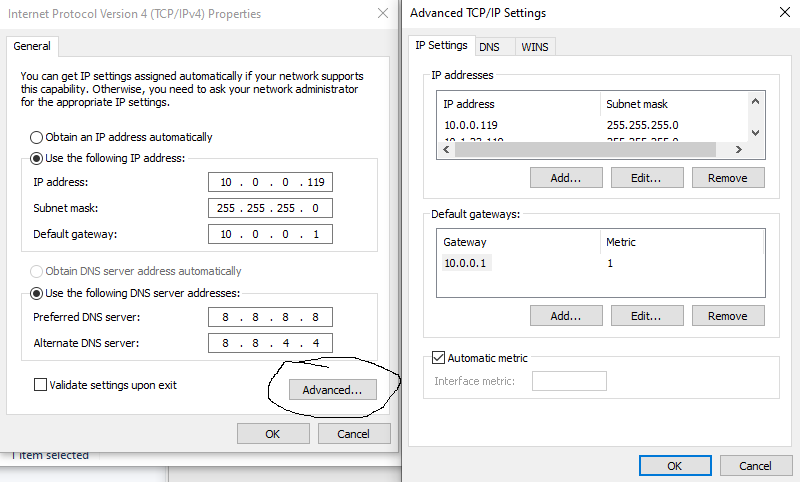

Next and maybe the best way for some is to setup a static IP on your computer. By doing so you will want after making your Static IP, go back into the IPv4 and in that window again at the bottom click Advanced, Then click add, now enter a new IP making it 172.16.0.20 or something that none of your cameras in your NVR are setup for, Once you finish and save you can use your POE injector connect your camera to your computers normal network. Then lets say you took the 51 off, You will just enter 172.16.0.51 and if it has a WebUI you should be able to access it now.. Please note your camera will still have no access to internet until it is routed to do so.
With your static IP and your second IP you will have the ability to access your network and internet plus the cameras IP range.. Picture below is how many IP ranges I have setup on this computer because of the different NVR's and networks I connect to..

Yes Personally I would leave your main IP address as your normal Network. IP. Make it something you don't have already like 192.168.1.199 if you have not made your IPs that large like in my network..
Then in that area for your wifi network connection in the area click advanced. Then in next area add in the second IP. You click the add then enter the 192.168.0.199 for your second ip and put in the normal Subnet of 255.255.255.0. I also added my default Gateway in that area as well if it isn't in to start with That is the Routers IP..
Please note not all IP cameras offer WebUI and I don't know Qsee camera you own so I can't say it does or not. However if you put in the info above for your 2 networks and have that camera on a POE injector that is connected to your router or switch you should be able to get arp data by typing arp -a and or ping the IP that it should be.. Again I don't know because I don't know the camera if it 1 has arp turned off, 2 is normally on DHCP and or if it is really set to a Static IP. I mean some of my Amcrest cameras if I connect to my NVR fresh it will get an IP from NVR however because I didn't set the camera to Static when I remove from the NVR and add to my Switch my Router will hand out a new IP on my network range. However if lets say I put a camera from my 4116E-NVR that has a different IP on my NVR's switch and put that on my 4216E-AI NVR even with it setup for Static IP that IP will change to the Switch IP of my 4216E-AI. So then if I put it back on my network with it set to static normally I wouldn't be able to contact my camera However because of all my IP's I have added to my computer I can access any of them IP from my computer without having to work hard at locating the IP..
