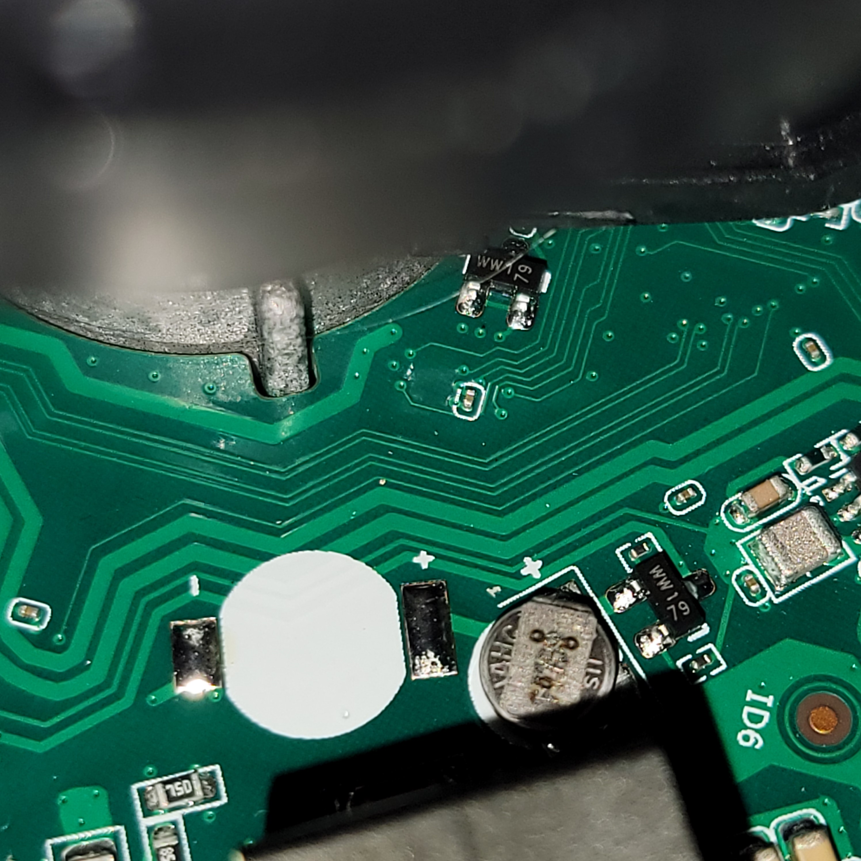

So it seems that my battery is now dead and when I connected it for the first time again. Even though it was setup P2P and I had the right user and password setup in my phone I was not able to log in to the camera over the AVP and had to make a connection via WebUI. I didn't have NTP or DST turned on. Looked in log and sure enough it went back to 2000.. So I checked my AVP app and sure enough without changing any settings after the update to the right date there is the ability to log in..

What I do know is I just unplugged mine to take a Picture of the battery, Having to remove dome and get the right bit for the dome scews all this was done within 8 min, Taking dome off, take picture put dome back on and plug back in.. In the logs it shows that I logged out at 1134pm est. However when I turned it back on at 1142pm there is a System Abort log entry that says Abort, Time 2022-05-12 23:33:00 and my logout when I clicked the WebUI Logout was time stamped for 11:34:54 and in that 8min it lost time.. Next there was a system startup that shows that the camera went offline says Reboot Mark: Power Off however there is no time other then the real time because it had already done the update to system time by then. Not sure why but then there is a System Save Configuration and then 2 min after that it shows I logged in and time set was current time again because I have DST and NTP enabled..

Now I have to go source a battery lol. Maybe one of my 2mp ADT zoom cameras have good batteries that fit. Been years since they came out of closet
