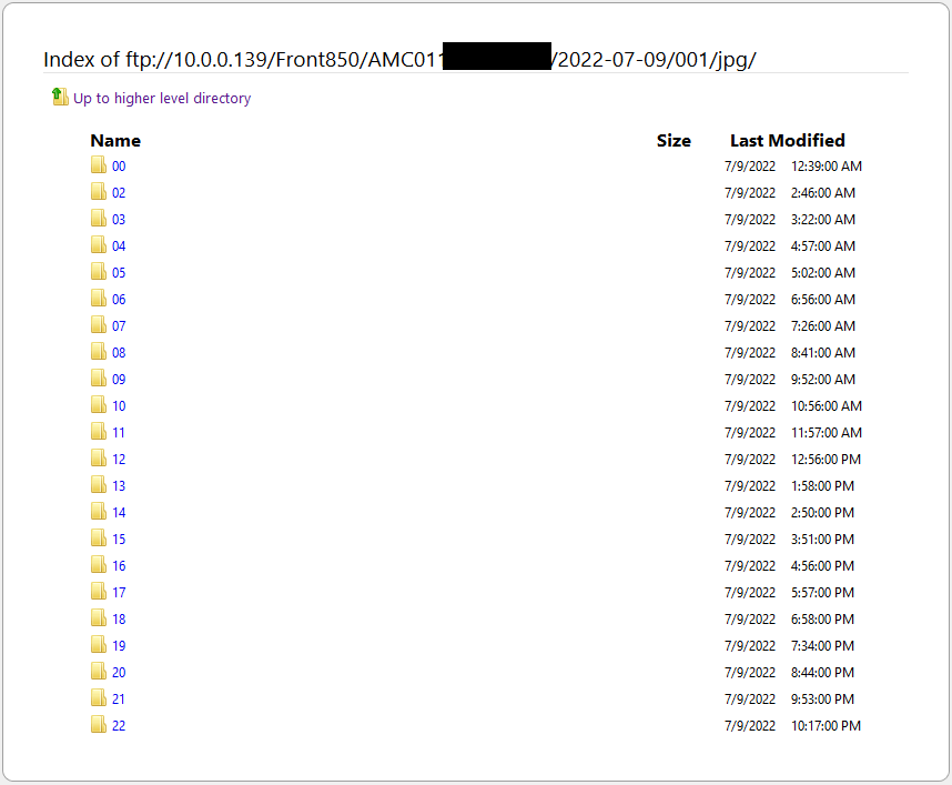

You made FTP, Setup your device to take Snapshots? and told the Storage area that you want your images and videos sent to a FTP. Then after doing that and pressing test you get a folder with your share name, ch# and data for times it should have taking a video or image however neither of them were in it? So for images (JPG) if you had events like mine then it would look something like mine however when you look in that folder there is no images or video?

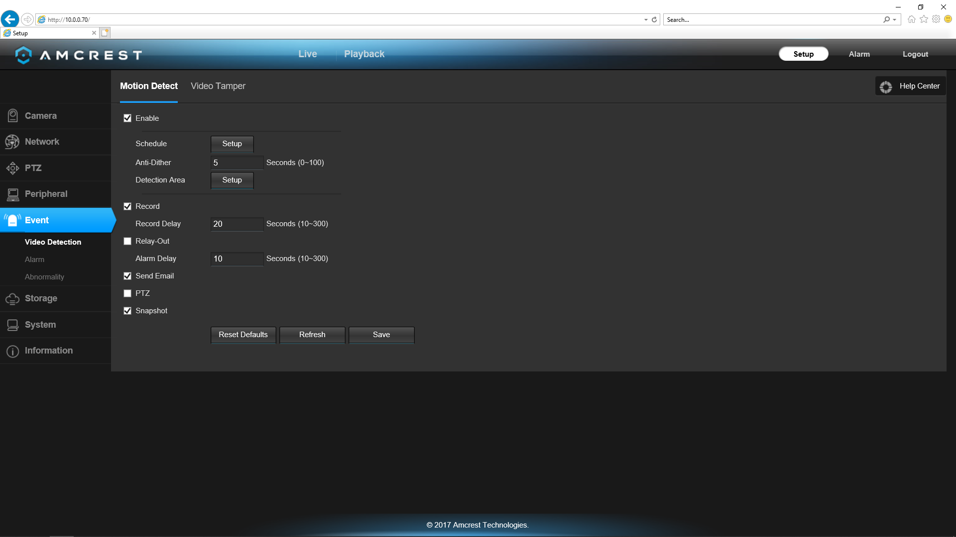

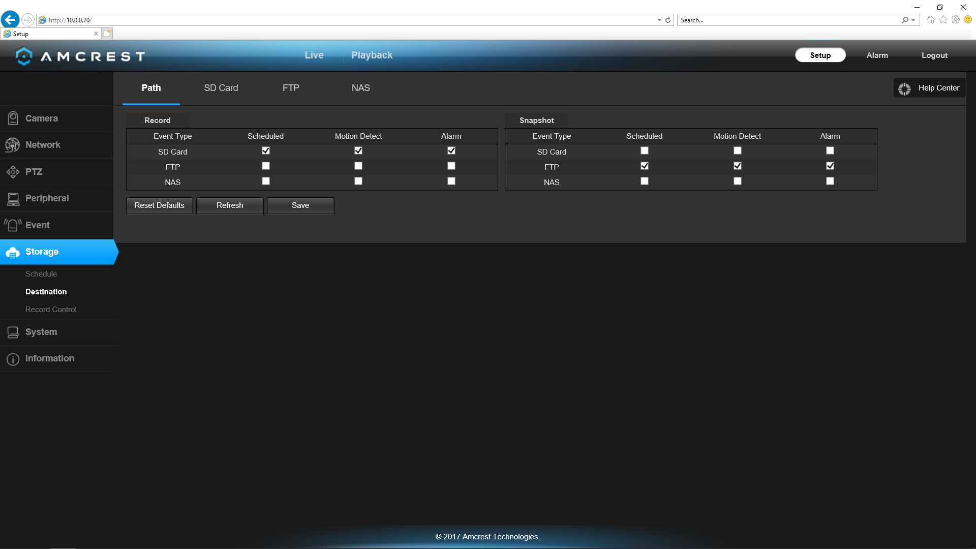

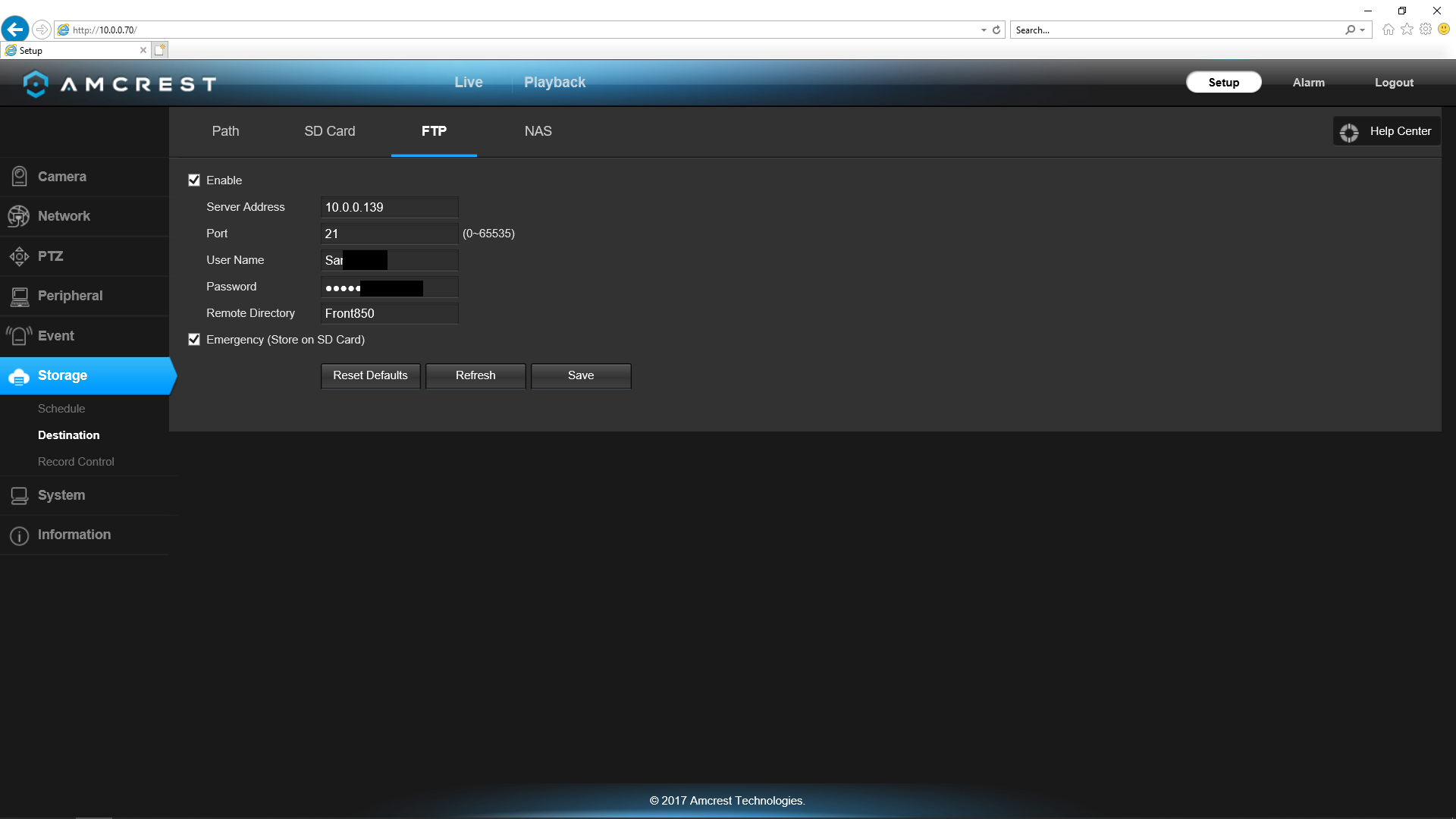

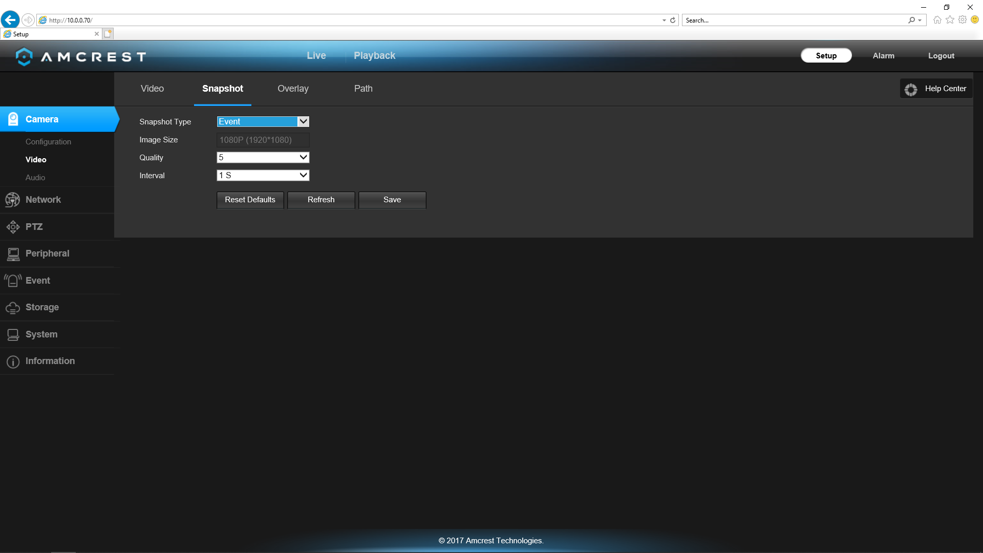

Here is my setup.. This is only one right now that is full time FTP and email others are email or ftp or neither so that is why I am showing this one. I do understand that this is much older camera however unless there is an issue with your cameras FW then it should look like and setup like I have it here.. Also not that you want to and I know that most shouldn't have to however have you Reset and setup again with same results? Did you then install FW again (Also there might be a NEW FW that might cure this if it was released with these issues.) even installing same FW back on could cure the issues at times I have had to do that...

What is your 10.0.0.139 hardware? I use an NAS works perfect. Also try adding another folder in your receiving hardware device called Front850/snapshots, update same info in the cameras using the / symbol.,and make sure your User name & Pass is correct by accessing from another computer on same network.
