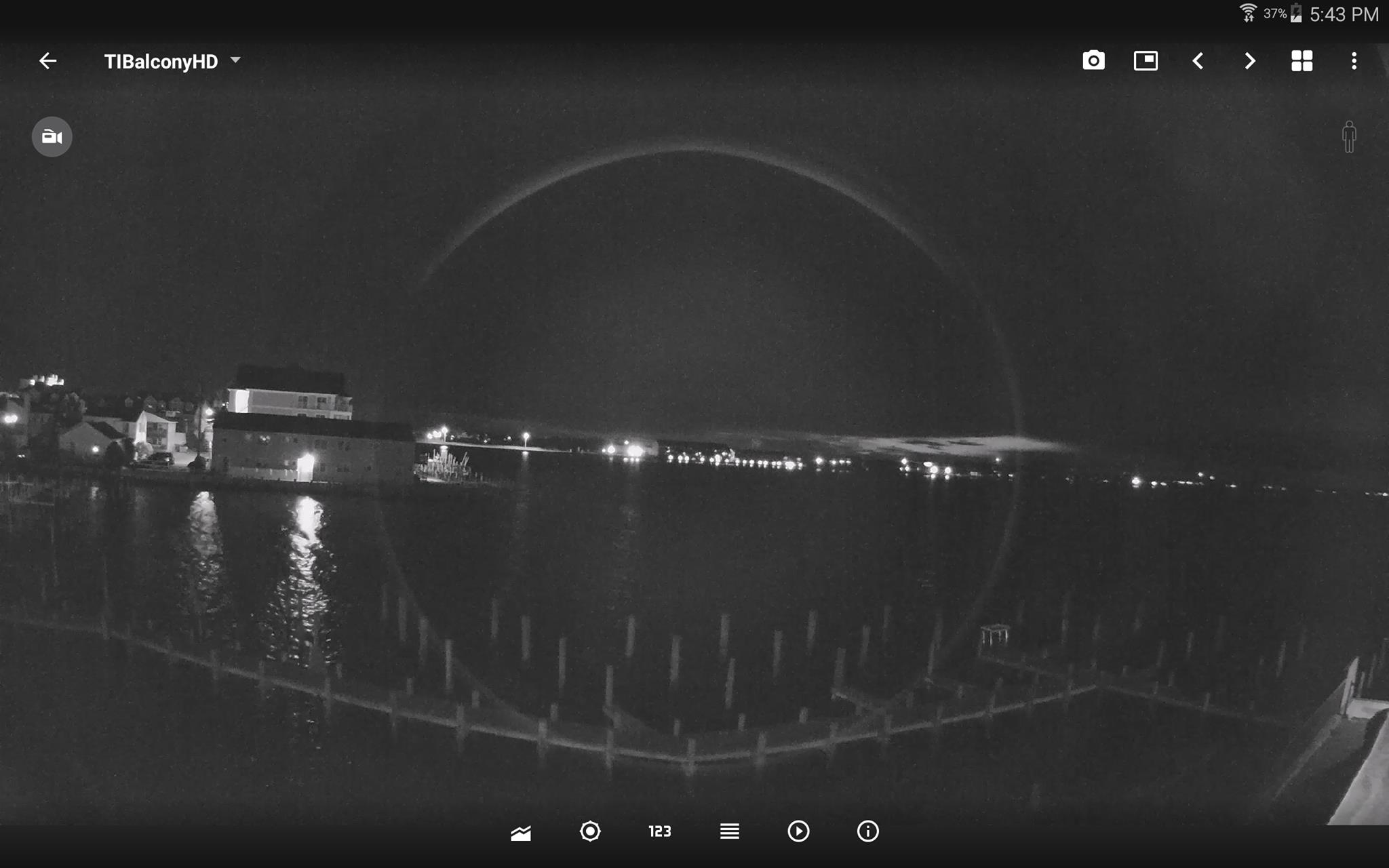

IP4M-1026. Halo at Night
Post by t84a »
What would cause this? It's been doing this since new. Thanks

Halo could be due to a nearby light source.

None really around. Someone said it may be missing an o ring or have a bad o ring. Anyone ever hear of that?

If any of the bright shore lights are causing it, you could try this.
In web UI, go to setup/camera/configuration/BLC mode, and set to HLC to see if it helps.

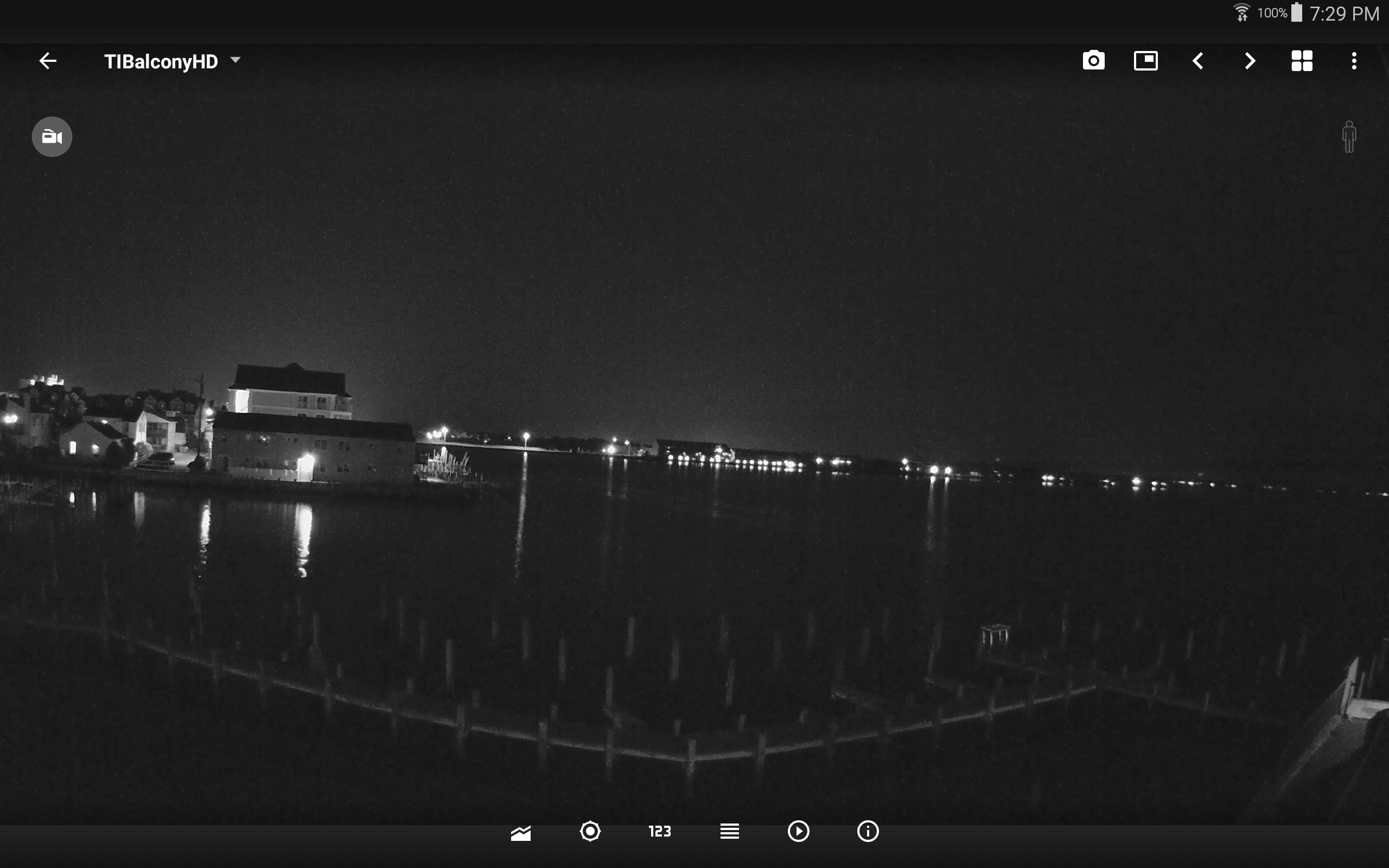

Thanks. I tried messing with BLC without success but when I turned Night Vision off, the ring went away.

Saw this when first posted and my first though was that it was some sort of glare back, perhaps because it was a dome camera but when I looked the model up saw it is a bullet camera. Nowhere near bad enough to be glare back from being inside looking out through a window but the fact that switching night mode off cures it must indicate that there's some sort of reflective problem going on. My own experience is that night vision isn't all it's made out to be unless you've got a near perfect setup.

The first screenshot looks to me as if there is some sort of internal reflection going on as if the IR 'lamps' and the lens are behind a protective cover. I would think that getting any sort of useful IR illumination from the camera over the distance that the camera faces would be more or less impossible anyway :)
