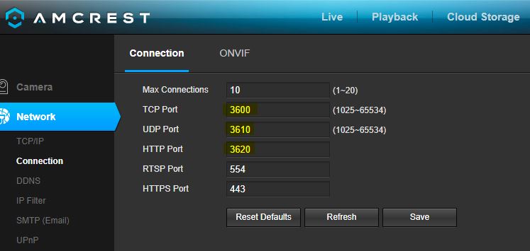

Re: IP3M-941 -- cannot access from outside local network unless camera is connected via ethernet
I had to forward all three of these ports. I have no idea which it's using but it works.
- amcrest_ports.jpg (35.26 KiB) Viewed 2626 times
