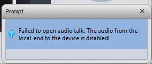

When using "Amcrest Surveillance Pro" application in Live View, if I click on the microphone icon to activate "Audio Talk", I get this message "Failed to open audio talk. The audio from the local-end to the device is disabled!". Not sure how to resolve this setting issue.

Is this issue only while enabling talk? Are you able to enable the speaker and hear from the camera? For the talk to work, the computer should have a microphone.

I also get the same message using Amcrest Surveillance Pro software audio talk. I'm using a Dell Inspiron 7352 laptop with internal Realtek High Definition Audio Microphone. The speaker is working fine. Were you able to resolve the issue?

I am having this issue as well. Someone suggested to add the camera device itself rather than the NVR, however, this did not work. I have a headset that I use with no problem with other software. I am able to hear the device but i am NOT able to speak. Clicking the microphone gives the same error as others.
Any direction is appreciated.

Just figured it out I think. On the phone app, i needed to open both audio and mic for 2-way conversation. However, on the PC software I only need to enable the mic. I was able to hear the opposite side and speak as well when I just enabled the mic as shown in my screenshot. Not sure if this works or is the answer but it worked for me.

I believe this problem is due to the type of camera it is set up as in BI. I was unable to use 2-way audio on the Amcrest ViewPro app when the Make and Model camera settings in BI were the default, generic (I think ONVIF) camera.
I fixed this by going to Camera Settings > Video > Configure... > and changing the Make and Model dropdown menus to the correct options (Amcrest, [Your camera model]).
