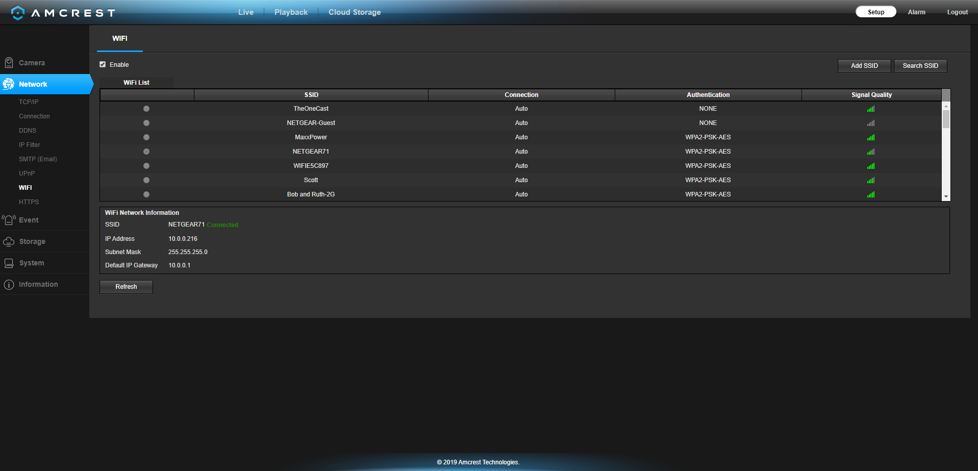

It really easy to setup and change from one Wifi to another...
You will want to log in, Then click on Setup, Then network, then Wifi. You will or should see a list of wifi in your area click on the one you want to setup to then a box will come up and ask you for a Password Enter the Password and then save.. Then your system will log you out Then you can log back into the camera at the new location... One thing I would say is you might want to change over to DHCP in your network TCP/IP under Wifi because if your system would assign you a ip address you want that.. However here comes the tricky part you could keep it Static but problem is the change to another wifi is or most like will be different Ip then one you have now.. If your able to keep the same IP then no problem... I have mine setup to not only give out a Guest IP on a different segment but also on a different Subnet that way there is no trying to access my local network off the Guest network...
So if it was me... I would first log on, go to setup, then network, tcp/ip click on wifi if not default change to default, then I would change to DHCP. Save.. It will log you out. Then Log into the Ip given, then again go to setup, network this time click on WIFI and then a list will come up of routers around you click on the want you want to change to type in new Password and save.. Log out and it will log you back in that cameras IP... Log in the camera, Setup, network, TCP/IP wifi as default, change to Static, if Ip change is needed make that change now. Save and it will log you out again and now log in to new IP
Screenshot (1099).png (91.56 KiB) Viewed 2601 times
