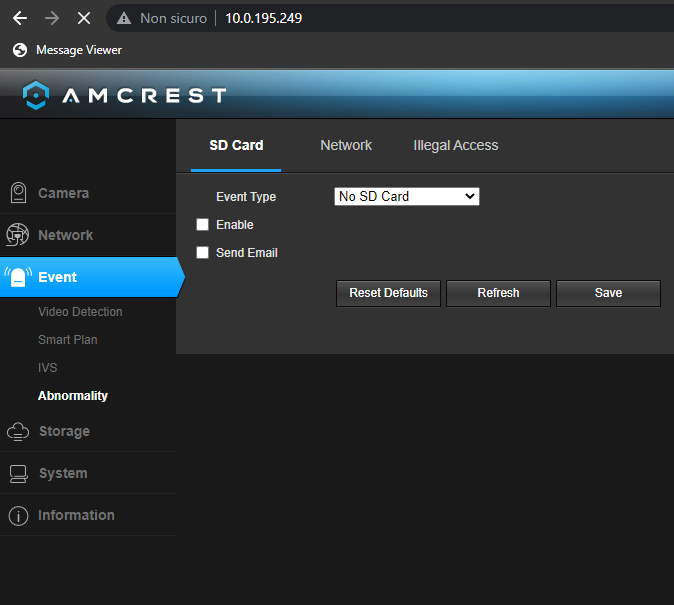

Unfortunately I have ho phisical IO for triggering an alarm on my cam.Sneaky wrote: ↑Mon Feb 27, 2023 1:42 am Thank you jack7,
maybe I was not clear but I have no issues on HTTP and it works correctly. I am looking for another way of communication. My goal is to sync a digital oscilloscope with the camera recording. I have an industrial PLC on my hand and I'd prefer to avoid HTTP as it relies on additional library for the device to communicate properly. So it'll be good to have, for example, UDP.
Is there anything available different from HTTP/HTTPS?
Sneaky
- Cattura.PNG (44.68 KiB) Viewed 3361 times

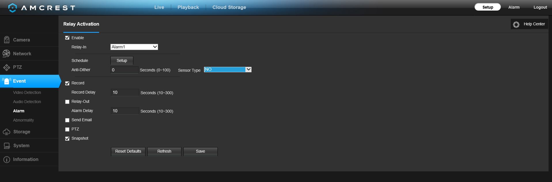

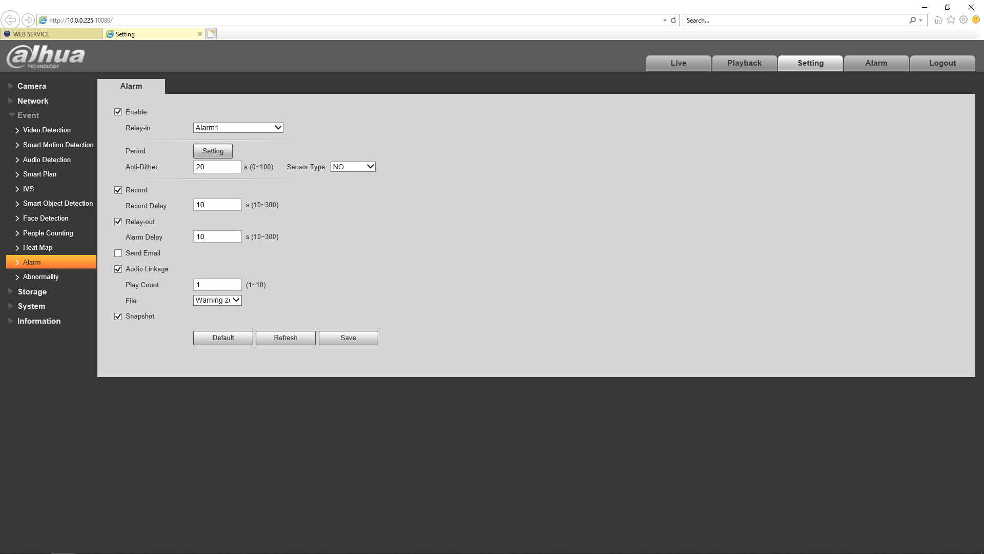

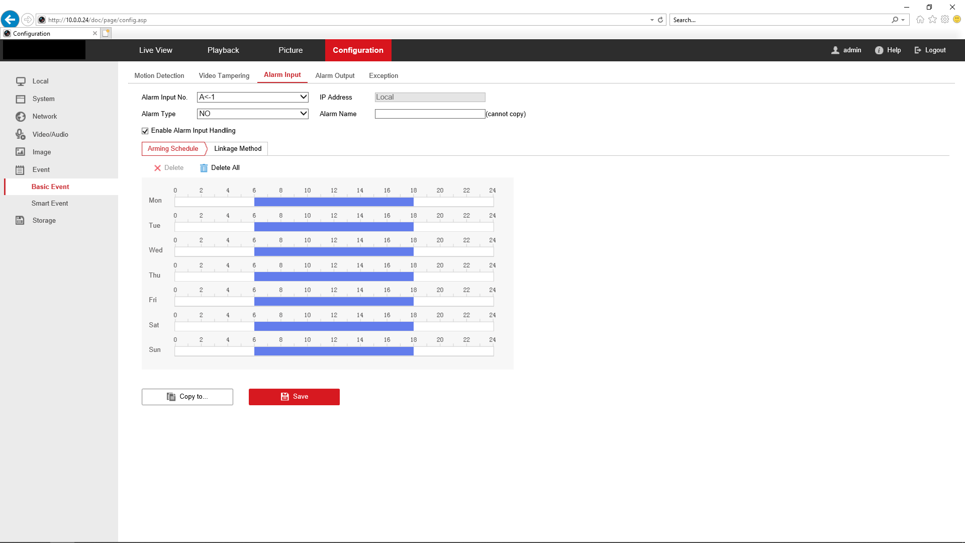

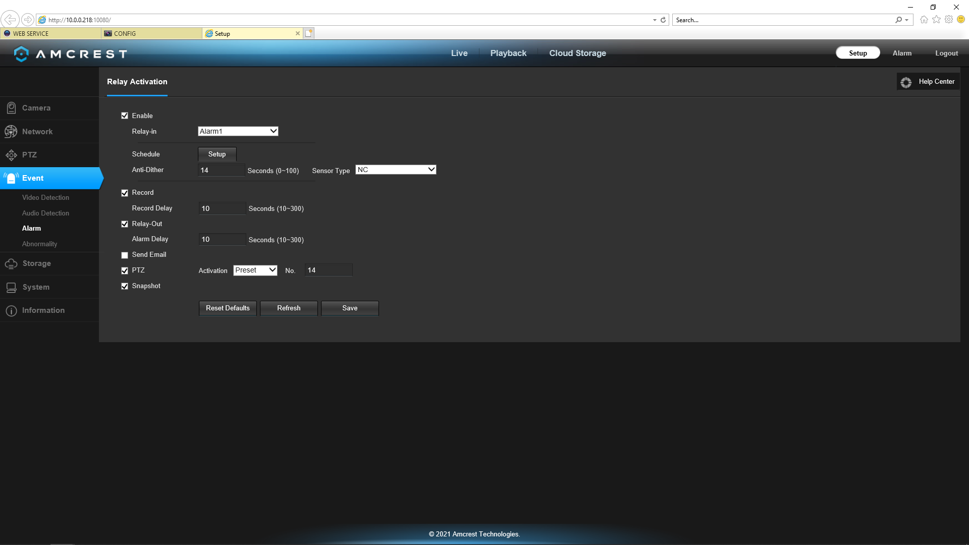

Not all cameras offer alarms and I think jack was saying that it might be better to use a camera that does have that option built in. While your current camera don't offer an alarm maybe you have one in your fleet that has Alarm inputs.
Some have them built into the body and others have them on the wire bundle. Looking at these 2 cameras one. The Dahua one is AI camera with loads of things built in. It has Alarm on the wire that I have connected. Then another one by Amcrest is a PTZ and has Alarm on the wire (Cable Bundle)
So maybe another camera you have might have alarms and if so then moving it to the location you need it service.
Edit for a 3rd with alarm that is an Hikvision OEM 4mp AI camera with wire connector on bundle
