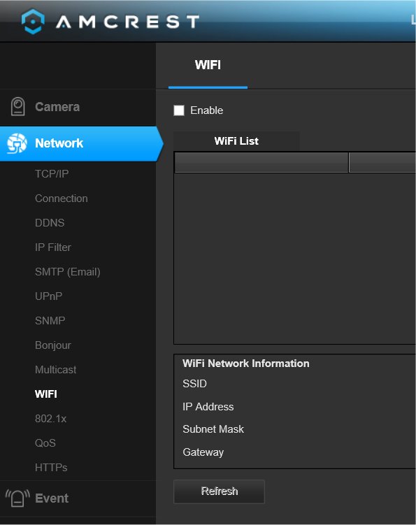

@Litcube As I understand it WiFi is disabled like this:-
but even so the camera can still be accessed.
IF that is the case AND the ethernet cable is disconnected from the camera then I see it as an issue.
My AMCREST Cameras:-
Re: Dual IPs on IP3M-HX2, Wifi not disabling
aww Yes I see what you mean I would agree... I just Tested that LOL. Cable or Not that Unchecked NO wifi at all over that IP setup for Wifi... Cool now udnerstand where to turn it off at lol...
