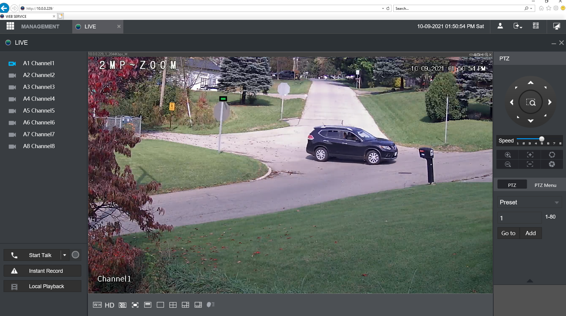

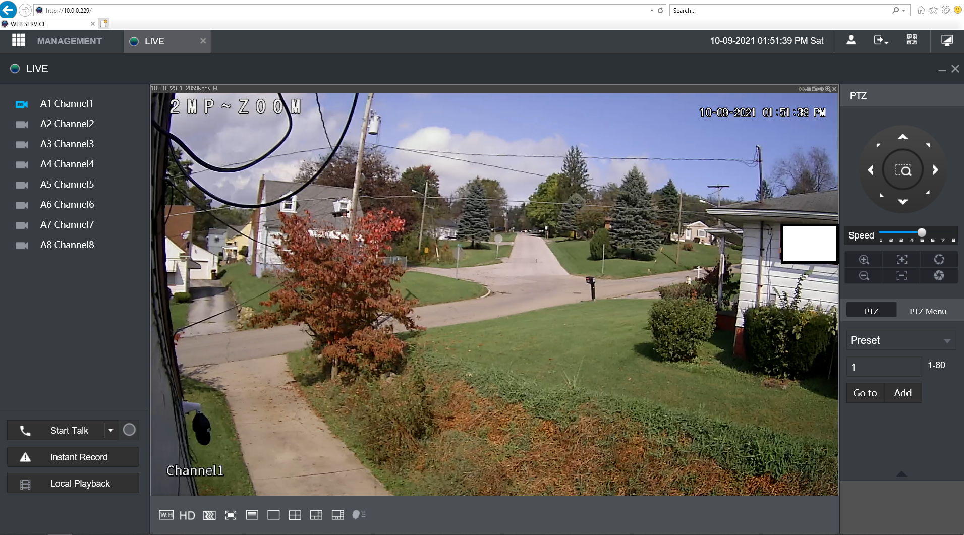

Also keep in mind 2.8mm lens isn't a Easy placement when the camera is up high. Please look at the pictures below for better idea of what I mean. This camera is a 2mp I did cover the Road sign because it can be seen and if you look at the speed sign it also can be read. This is 354 feet from my camera. This camera is 2.7mm to 12mm so when zoomed in that is looking 12mm. Also in the zoomed out picture don't pay no attention to my Black Amcrest PTZ camera in a White Mount lol I don't try to make my cameras look pretty I want them to Function. I have the normal black mount just didn't work for my needs at this location lol..
To View these largest size in Win10 right click and view in new Tab
This at 2.7mm view
Screenshot (1148).png (1.83 MiB) Viewed 3260 times
This is zoomed into 12mm view and where I normally keep my cameras View
Screenshot (1147).png (1.88 MiB) Viewed 3260 times
